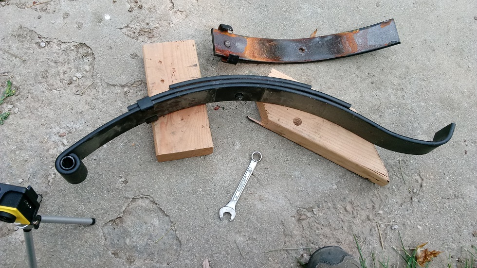

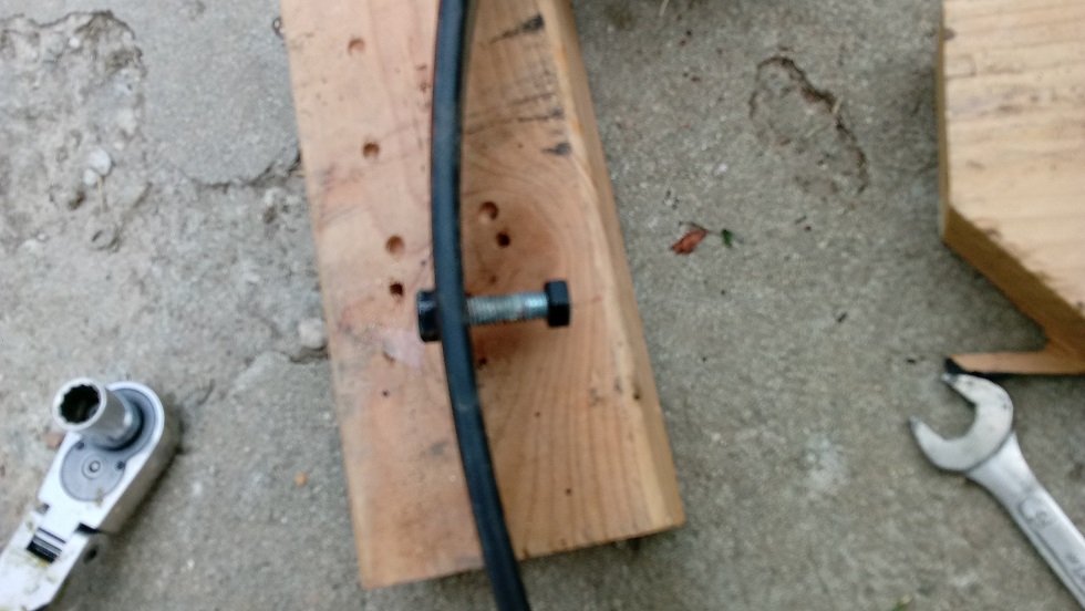

In preparation for a upcoming trip I decided that I really needed to lighten up the spring rate on #2. I figure at the most my overall weight to never be over 600lbs. and that is stretching it.
One day while at Cabela's I noticed they had a boat trailer and I was looking at the suspension. It was very similar to the HF trailers, but only had one leaf since it was designed for aluminum boats. I had often wondered if it could be done and after seeing that I though why not go ahead and try it.
So I finally got around to it a few weeks ago. I can already tell a big difference in suspension suppleness.
Spring
Spring off
Springs Removed
It was very easy to do and took me about 30 minutes to do both sides. Once the spring is out you just unbolt the springs at the center and bend back the spring tabs. Remove two springs and then reinstall the bold and put back together.

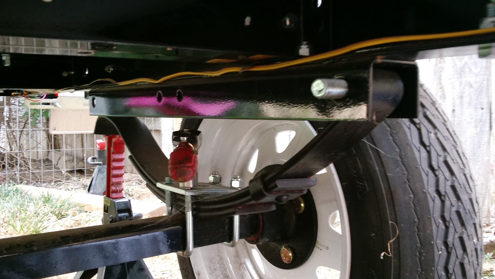

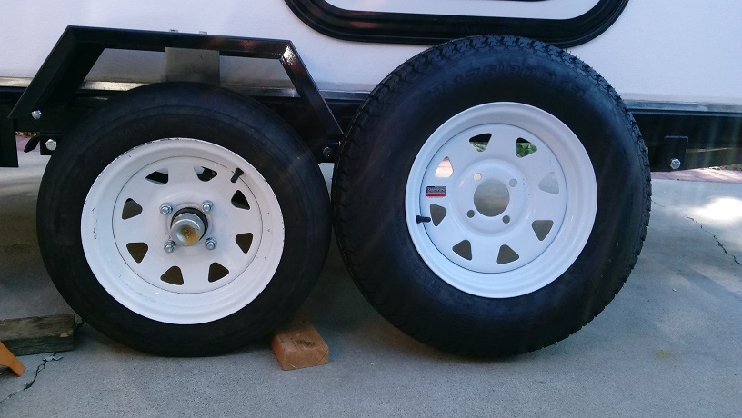

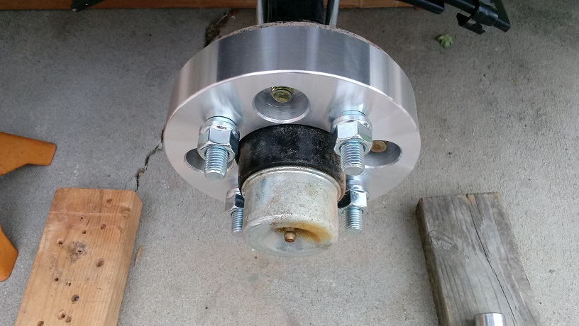

#2 got some big shoes today. With the last trip out I found that I really needed some larger tires to get into the back country. When I got back I looked into options. With a 4 lug hub I was limited to what was available. Without changing the axle this is what I came up with. We shall see how this works on the next trip this week.
The solution? 1.25" wheel spacers https://amzn.to/2y1SrQi and ST175/80D13 tires https://amzn.to/2N7OWxj . The stock tire diameter is 20" and the ST175/80D13 are 24" .
The spacer:
Spacer
Compared tire size:
Tire Size
Fender mod: I had to move the fender up 2".
Fender Mod
George.

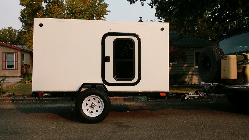

Postby ghcoe » Fri Sep 28, 2018 8:40 pm
Finished!
Finished
The spring bolts are not a issue with this setup. Tire bulge to frame is 1.5". Already looks a lot more chunkier. :thumbsup:
