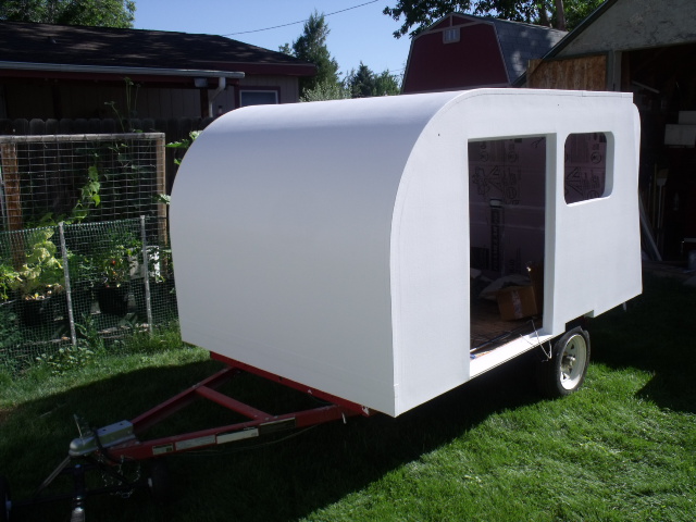

Postby ghcoe » Thu Aug 04, 2016 9:12 am
Usually exterior paint does not come in gloss. You can find it, but in most cases latex paint is not strong enough to support a gloss finish over time. I used the Lowes Valspar paint and found it to be pretty good for coverage and texture. I got the semi gloss and think it looks pretty good. Plus, I found it gets creamy when it sets in the pan a bit. Makes for applying paint on the underside with a brush a snap compared to other paints I have used. I am thinking of using it to attach the canvas to the interior roof because of this feature.
Here are a couple of pictures of the semi-gloss.
Body painted
Roof shine
George.

Postby dancam » Thu Aug 04, 2016 1:39 pm
ghcoe wrote:Usually exterior paint does not come in gloss. You can find it, but in most cases latex paint is not strong enough to support a gloss finish over time. I used the Lowes Valspar paint and found it to be pretty good for coverage and texture. I got the semi gloss and think it looks pretty good. Plus, I found it gets creamy when it sets in the pan a bit. Makes for applying paint on the underside with a brush a snap compared to other paints I have used. I am thinking of using it to attach the canvas to the interior roof because of this feature.
Thanks for the reply. I wasnt aware latex had a hard time holding gloss, thats interesting. Thanks for the pictures! The gloss level looks pretty good, but its hard to tell on a phone. How would you compare its gloss to a bright white RV? In the store the gloss paint sample looked fine, but now im wondering if it will be so bright itl hurt your eyes on a sunny day, lol. What do you think? Im not doing anything fancy to the fabric weave to make it smooth and that detracts from the gloss a lot. The valspar here is $40/gallon for the cheaper line and $60/gal for their valspar duramax. I presume you used the cheaper line? Problem for me is they only have 2 gallons in the store of the cheaper stuff and i need 2 for sure, and i dont want to be in a bind if i need more. What kind of paint store gets down to 2 gallons of a brand anyway? Lol.
