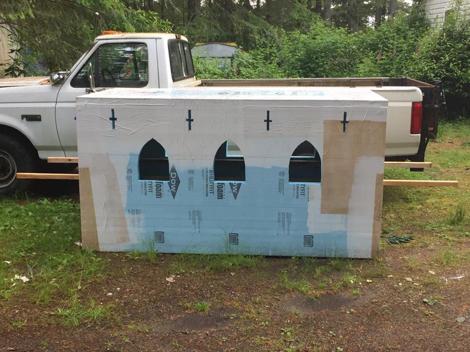

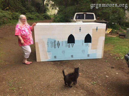

In the meantime, to get used to working with this material, we decided to take a practice run by making a chicken coop and it's going to be a castle. It will have stones carved into it and have a papier-mâché shell. Crenelations will be added on top. It will have handles coming out the ends so that we can pick it up and move it around the yard. Will be nice to have a coop we will never again have to clean out! The handles will go the entire length of the thing so that they're also the roosts. We won't be putting nest boxes in it cos for some reason they like the cardboard boxes by our front door. :roll:
The bottom will be chicken wire with a skirting so that nothing can dig under it.
It took me 2 days but I managed to get a layer of papier-mâché on the corners before it started raining the other day and today I managed to get 2 windows and 2 arrow slits cut out before it started raining. Weather is supposed to clear up by tomorrow and be nice for a few days after that.

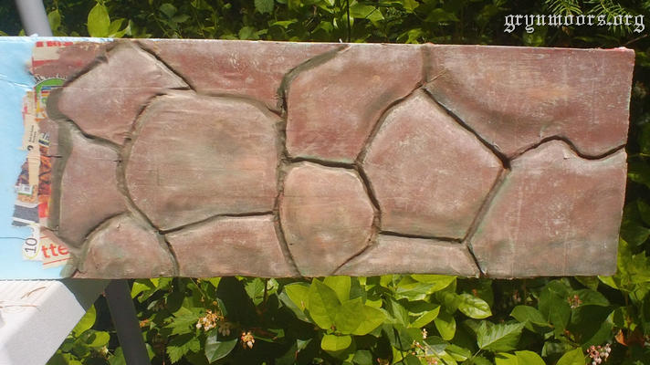

This is a test piece I did with the stones. Husband liked it so much he was asking for the entire coop to be done this way too. I said that I'd love to!
Update: We got all the cutting done and the roost/handles installed. Looking forward to better weather starting tomorrow.

Stones look great!

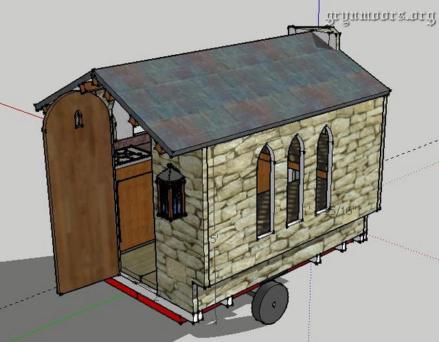

I finally came up with a design that I love and even the old man likes it. It's a single person design. Will be perfect for day-tripping SCA events or spare bedroom for visitors. It's designed to sit right on top of the 4x8 footprint of the utility trailer. Trying to keep things as simple as I can.

That looks good. I'd split the door under the sink so you can open it when the bed is made! :)

Crosswinds ??? :roll:

Good point. While I think it would be fine for a guest room in the backyard, I'm not sure I'd want to tow something that tall, that light, even with 500 pounds of ballast. I wonder if they drink ballast at their Medieval gatherings??? :?

It's 6'6" tall at the highest point. It's 5' 6" at the low end of the roof. I can drop the low end of the roof some more if I have to. Would that still be a problem with crosswinds?

Argh. I didn't notice that. I'll shrink the width of the door a bit. That's where the port-a potty goes. I will definitely have to be able to access that during the middle of the night! (#oldpeopleproblems)

If you read Catherine's post, her trailer was very light. Remember she made it out of foam. And she said the side walls were like a sail, which the cross draft caught.
You are talking about making it tall and also out of foam. So you can logically assume that a similar cross draft will also flip your trailer over.
To build out of foam, you have to have special features to combat the sail/cross draft situation.
For my foamie I chose to build only 4' high. I also keep all my weight down low, and add ballast during the trip.
Glenn, on the other hand chose to do a rounded over roof on his Foam Stream.
Another option would be to reduce the height of the side wall by building something like a compact camper.
Still another option would be to curve or angle your sidewall out, with a parting line in the middle.
So from that perspective, this design is better than your latest design... because it breaks up the sidewall...
Yet, another option is to build a popup like Rae did. Even though her's is not a foamie...
http://www.enslin.com/rae/gypsy/wagon.htm
Hope that helps.

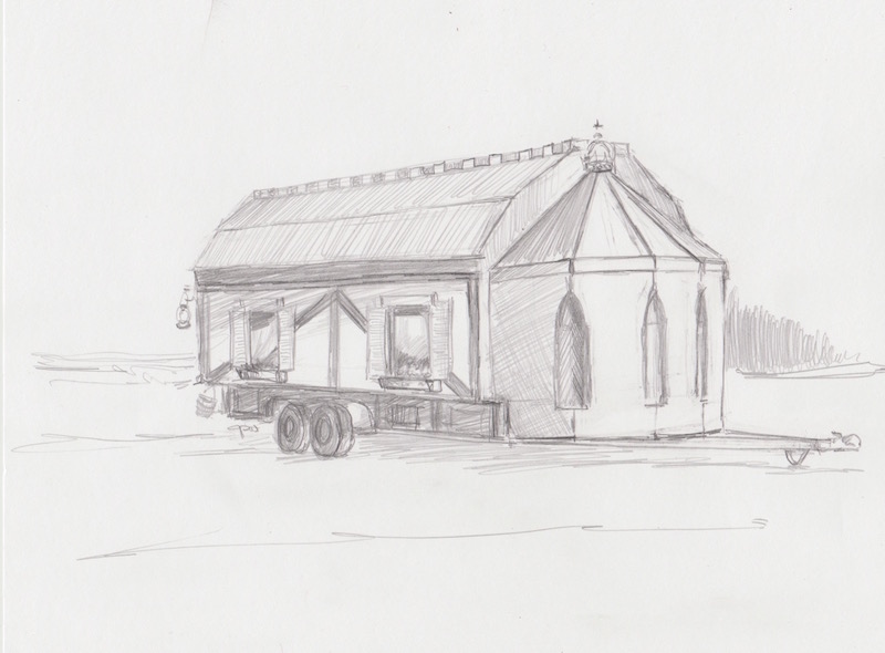

... as per one of those drawings …. now if you could build it on a utility trailer , better a tandem , then there would be less likelyhood of trouble …The trailer being inherently HEAVY and the Foam being comparatively Light… as the sketch shows a shelf to fit over the UT sides adding width … and stability … ( it’s all a compromise ) And how about a “Mansard” roof somewhat like a squared off round roof ? … and if you look at old medieval buildings , such as churches ,Pubs , and such ,there is always a “punch out" in the back that ties in with the building …that could be the front end and streamline the whole 12th Century ... 8)
I guess we’re going to need a drawing … :roll:

Something similar but not exactly like this but along the same lines of trying to decrease Drag … :thinking: The more rounded roof would decrease the likelyhood of a blowover, uet still give a bit of headroom inside and be easy to make … just crumbs for thought …
Decorative elements could be simulated in Paint … rather than trying to capture every detail … ;)

Nice Glen,
You cranked out that sketch pretty quick!!!
