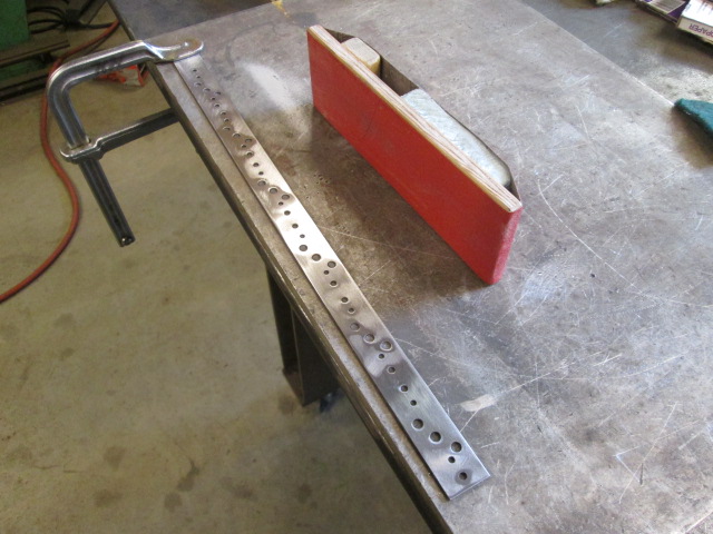

Make yourself a hand sanding block that uses belt sander belts. Solves many fitment issues.
Simple piece of 1/2 inch ply with a small block of wood and scrap piece of foam to set belt tension and give something to hold onto.
