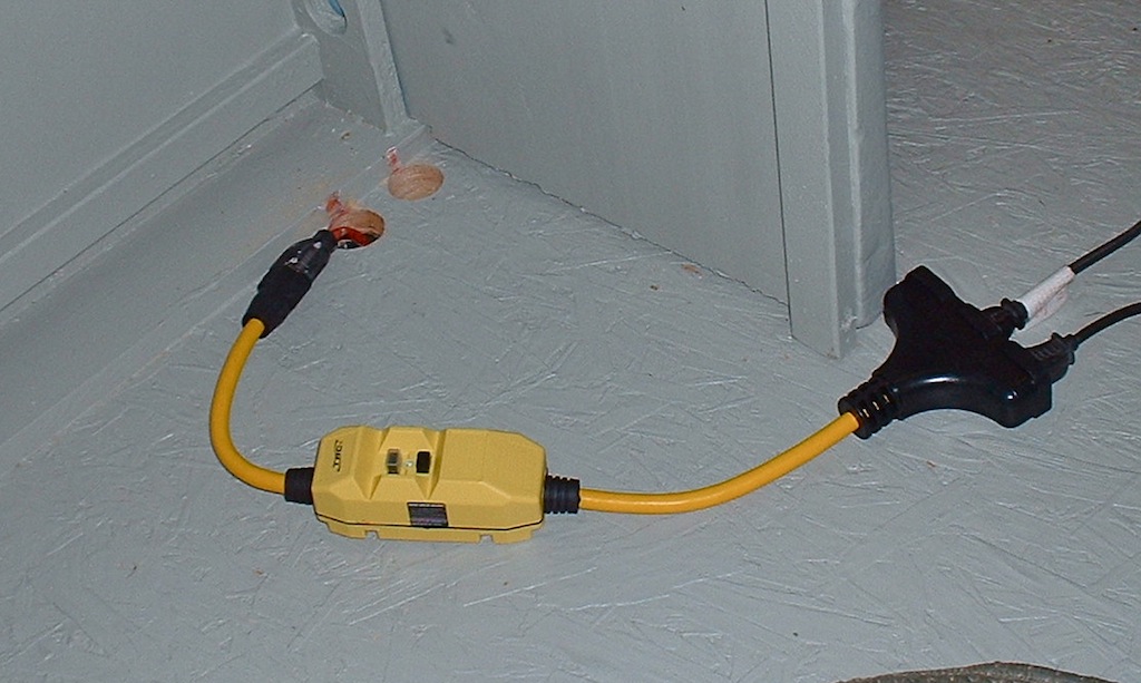

Apologies Amanda, but we always wonder why these electrical “systems" are built into a foamie camper … Our “system" is an extension cord and GFI outlet … Completely flexible, movable , replacable , and sufficient for the need.. Maybe this is just a practice left over from Homebuilding … I just keep thinking “Hard tent” ...

Well, for me it's pretty necessary... Not really something I can do without if I'm going to be more or less living out of this thing as I go traveling for a while as I plan to. Believe me, if I could just avoid electrical altogether, that would be lovely! But my devices need charging and when it gets chillier I'll need a way to stay warm, and I'll need a way to at least plug in a fan for the heat, etc.
I know your cord would get me that when I was plugged in, but I don't plan to be plugged in 24/7. And even if I were, I then have to run the through the wall or leave a door open somehow, and the whole thing would leave me feeling pretty Jerry-rigged. A little more effort now will make a world of difference later, both in freedom and usability.
