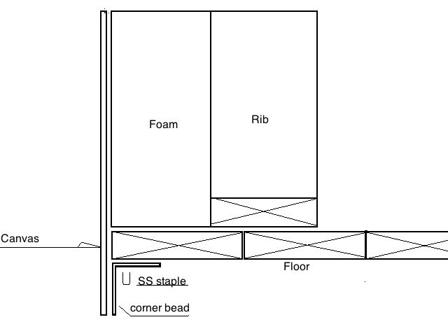

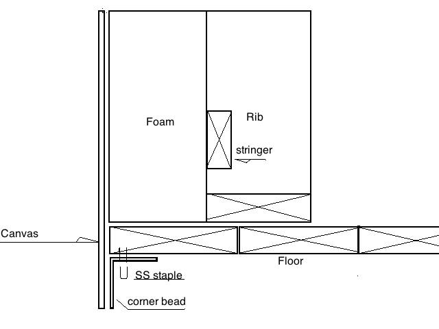

Armed with Tac’s information we went to the Home depot website and looked up corner bead … Found the perfect stuff , 1.5”X 10’ long , and also looked up 3/8” stainless steel staples . The idea being we’d staple this corner bead to the floorboard (bottom ) flush with the edge , before we install it on the trailer making that job pretty easy . ( see drawing ) , then Gripper and paint over that to help lock it on , and then the canvas would go straight down the outer side and stop at the end of the beading … No way water can climb back up 1.5” to the floor … Thanks Tac !!!

Postby tony.latham » Sun Jun 10, 2018 9:22 am
Great diagram. What software did you use to draw it up?
What are your ribs made from?

Postby GPW » Sun Jun 10, 2018 11:29 am
Paintbrush for the drawing … for my Mac … ( probably long outdated )
The ribs were CNC cut from 3/4" ( or so) Birch plywood … and I forgot the stringer which connect the ribs like a skeleton

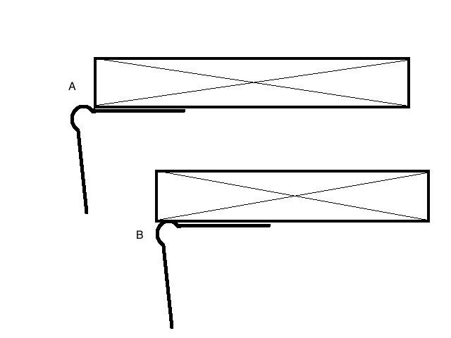

However , from mistakes comes progress… we got the recommended drywall bead , SS staples to hold it, another can of Gripper , and 5 cans of great stuff… and new chance to do it right , and a test of the “board floor” too …
One question, playing with the beading , which way should I mount it on the floor board ??? ( see sketch)
Drip edge .png (11.87 KiB) Viewed 1999 times
Re: FoamStream , the restoration … a lesson learned .
Postby me&z » Mon Jun 11, 2018 6:59 pm
B. A is just going to provide a place for dust to collect and hold moisture.

Postby tac422 » Mon Jun 11, 2018 7:11 pm
I think it's enough of a drip edge if you turn it upside down from where you show it on A.
And then run the canvas underneath :thinking:

Postby OP827 » Mon Jun 11, 2018 8:19 pm
Option B is better with what you showed in the canvas-wall-drip edge arrangement sketch above.

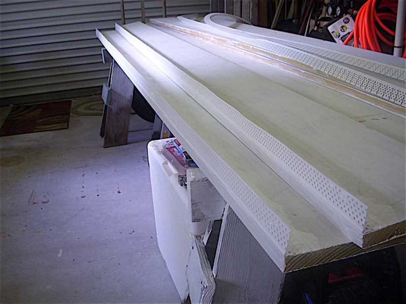

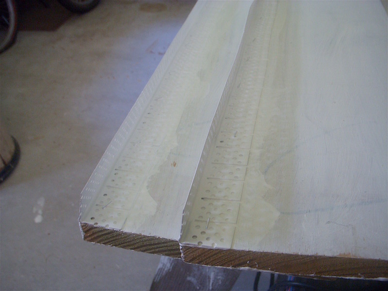

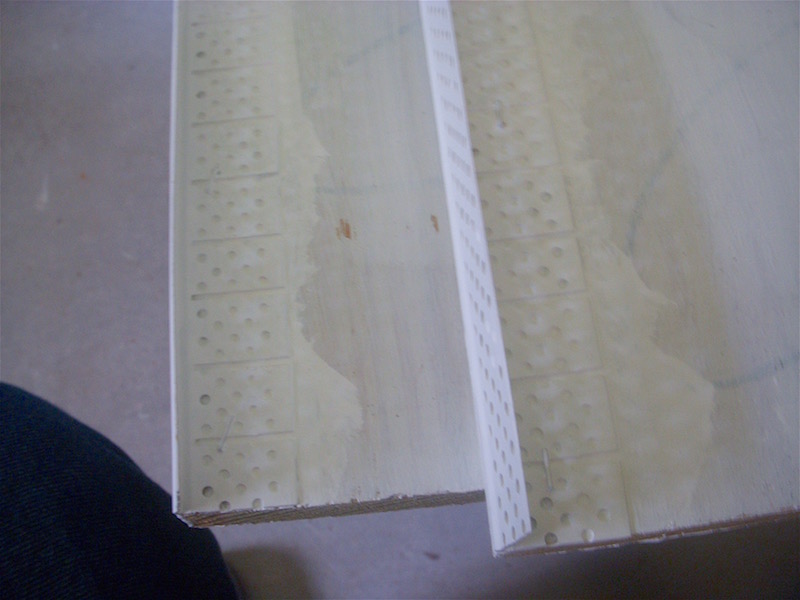

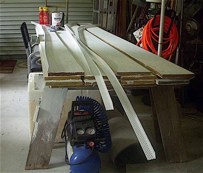

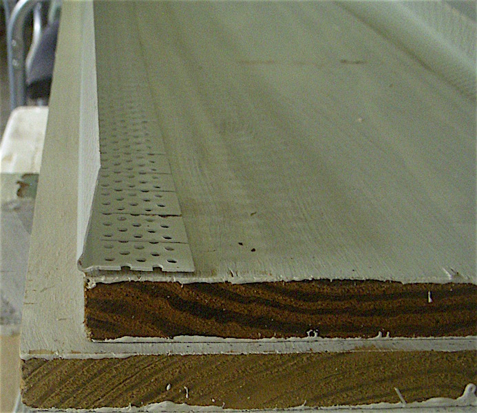

Postby GPW » Tue Jun 12, 2018 11:42 am
Got the bead/drip edge stapled to the outer floor boards , then we slobbered Gripper all over it filling the holes and really making it quite stiff when dried … I think this is going to work Great … :D
Naturally , I used the straightest board I could find … We haven’t primed the edges or the ends of the other boards as likely they will be cut to length , then primed and painted before installation … :thinking:
One tiny problem … It seems Stainless steel staples are great because they don’t rust , but they are quite soft and tend to deform when shot into hard surfaces… we had to go back with a small hammer and make sure they were in as far as they could go … :o Not really a problem , and that PT Pine is very hard …

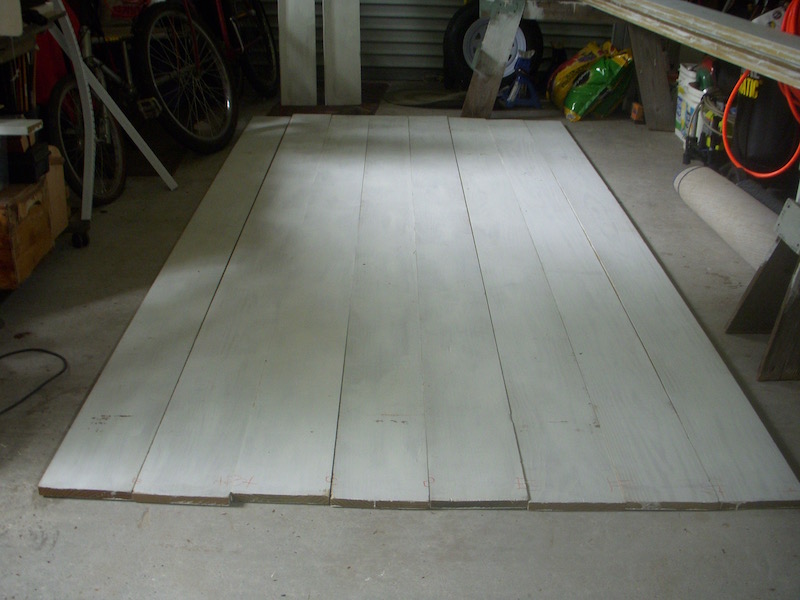

Postby GPW » Wed Jun 13, 2018 9:27 am
Got my floorboards all matched up and marked … Waiting for dry weather …
