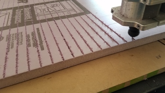

Postby twisted lines » Wed Mar 10, 2021 7:18 pm
I found a easy way and thought it would be a lot messier
1 inch spacing 5/8" deep I could see lines still.
1 inch.jpg (69.76 KiB) Viewed 1995 times

Postby ghcoe » Wed Mar 10, 2021 8:24 pm
I could see lines still too, but they usually are easy to sand out.
