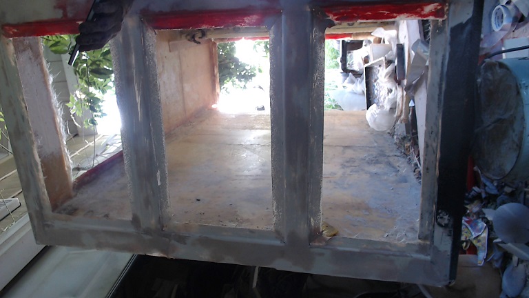

Postby saywhatthat » Thu Aug 01, 2019 12:08 pm
small glass.jpg (100.05 KiB) Viewed 2777 times
All fiberglass and foam in picture of a 100 year trailer using trailtop components . Poly DOSE not eat HR foam. will melt the white foam. When doing glass it is a waste of time to do the sand and fill. build from the outside in.

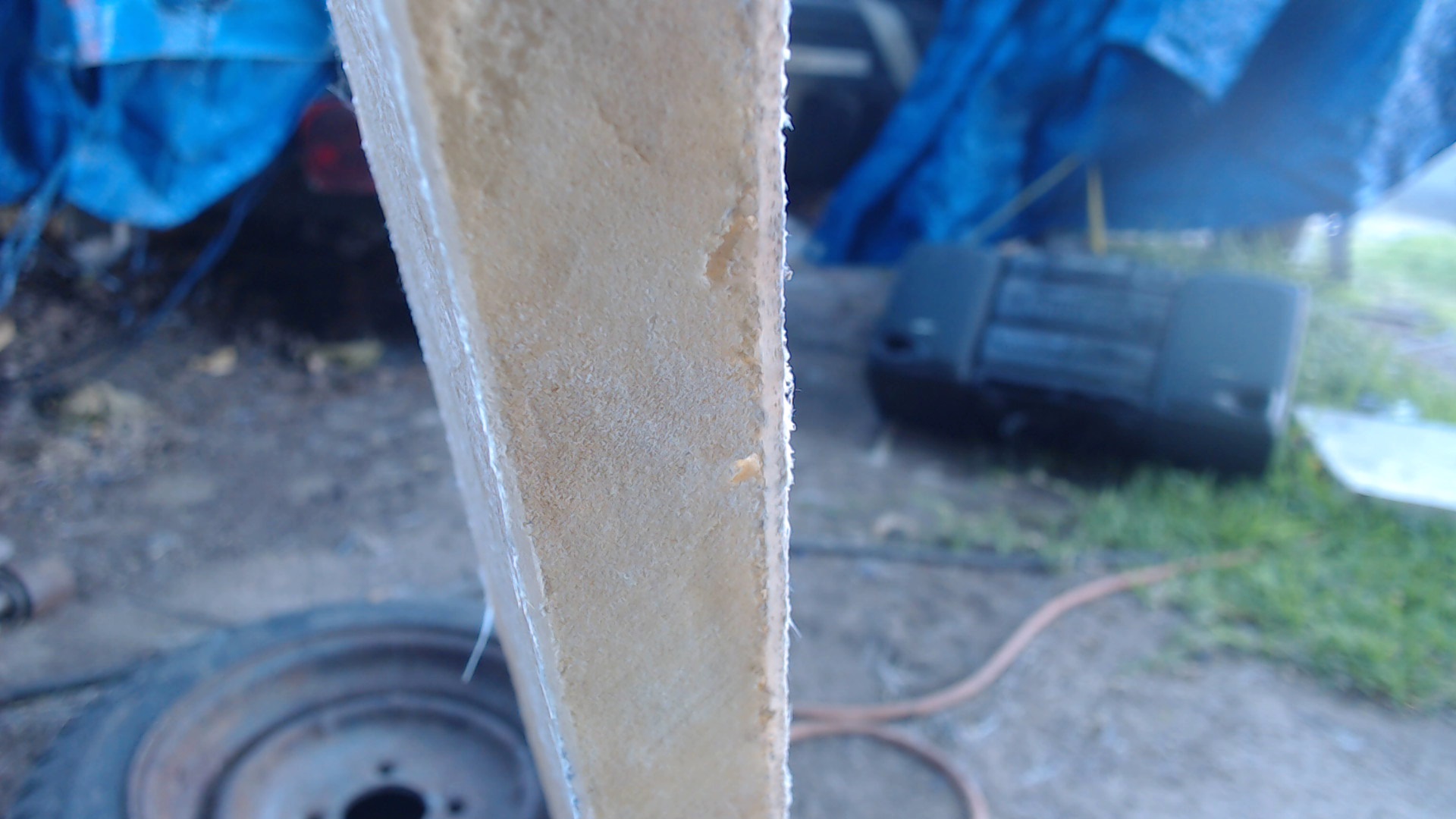

Postby saywhatthat » Thu Aug 29, 2019 10:31 pm
The attachment Picture 528.jpg is no longer available
If you use the right foam . poly will flex more than epoxy Don't have do as much fill and sand. Cost & labor is much less than epoxy . If you have something that will soak up water wood paper then epoxy is a must. But foam with added bite works great As the foam will not soak the resin up .Just had an gent that want to fight over this Said He seen on the web that it would melt foam . And I was playing him as a fool as he fingered a 1/2 built pod. :x
Now to piss of more .Yes you can use poly over Polystyrene the white foam say what. one can use Styro-Shield. but cost and time are very high. Are 2 are 3 coats of latex paint to seal the white foam .Then one layer at a time of poly.The heat from the cure will weaken the latex.[
