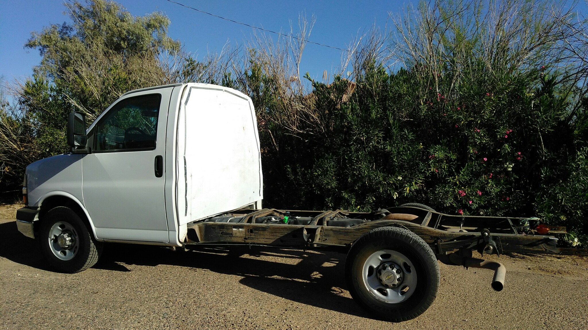

TERRA6, Van cab and chassis 7*14, 4" Polystyrene
Re: Terra6, Van cab and chassis 7*14, 4" Polystyrene

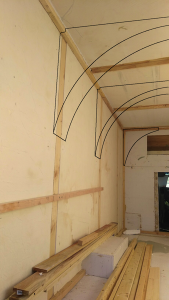

And here's a Smaller picture to better see it all at once … and more small screen friendly too … ;) You can still have your simulated rounded roof strength … Arches were probably the most significant architectural development of the ages … they transfer the loads over a large area , adding great strength and structural rigidity … Look Cool too !!! And a good use for foam scraps … ;) We’d expect any flex to be a Torsional flex and arches/gussets can help there .. It can twist , but won't break or collapse.
And you’re really not adding much weight for the amount of strength it will give ...

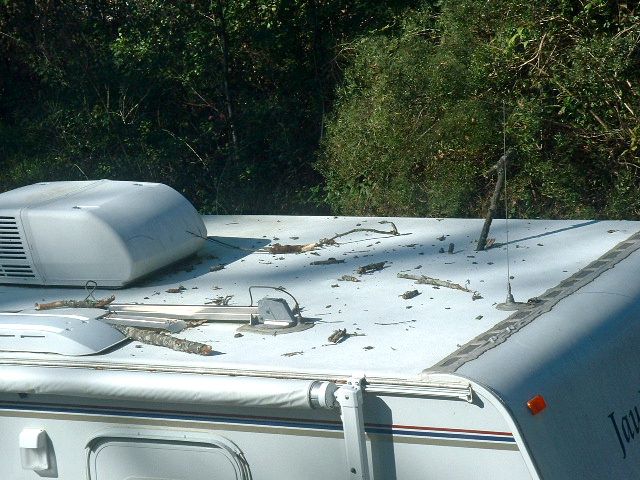

if you ever watch the videos of RV structural failure , they always seem to flatten out on themselves, the walls don't break , they collapse at the joins …nothing to counteract those diagonal stress forces :o

Agreed on the curved roof gussets GPW.
Have considered them for all the reasons that you mentioned.
Any links to trailer failure videos? Would like to see that to study but I can imagine that the wall to roof joint is under reinforced and with today's RVs getting longer and heavier, that span needs way more reinforcement than they come with. It's own weight, length alone requires support.
But then, how much is enough and to what resistance is sufficient? All open to interpretation.
So I was very much concerned from the beginning about this. Extra strength and gussets or arches were considered. At this point I have added walls and boxed cabinets. The major factor is unsupported or nonreinforced wall spans. More than 4 ft to me would be a limit defining bracing requirement need as a general guideline. I look at my build as three 4'*7'*6.5'zones requiring bracing and boxing/support within or at the limit of each.

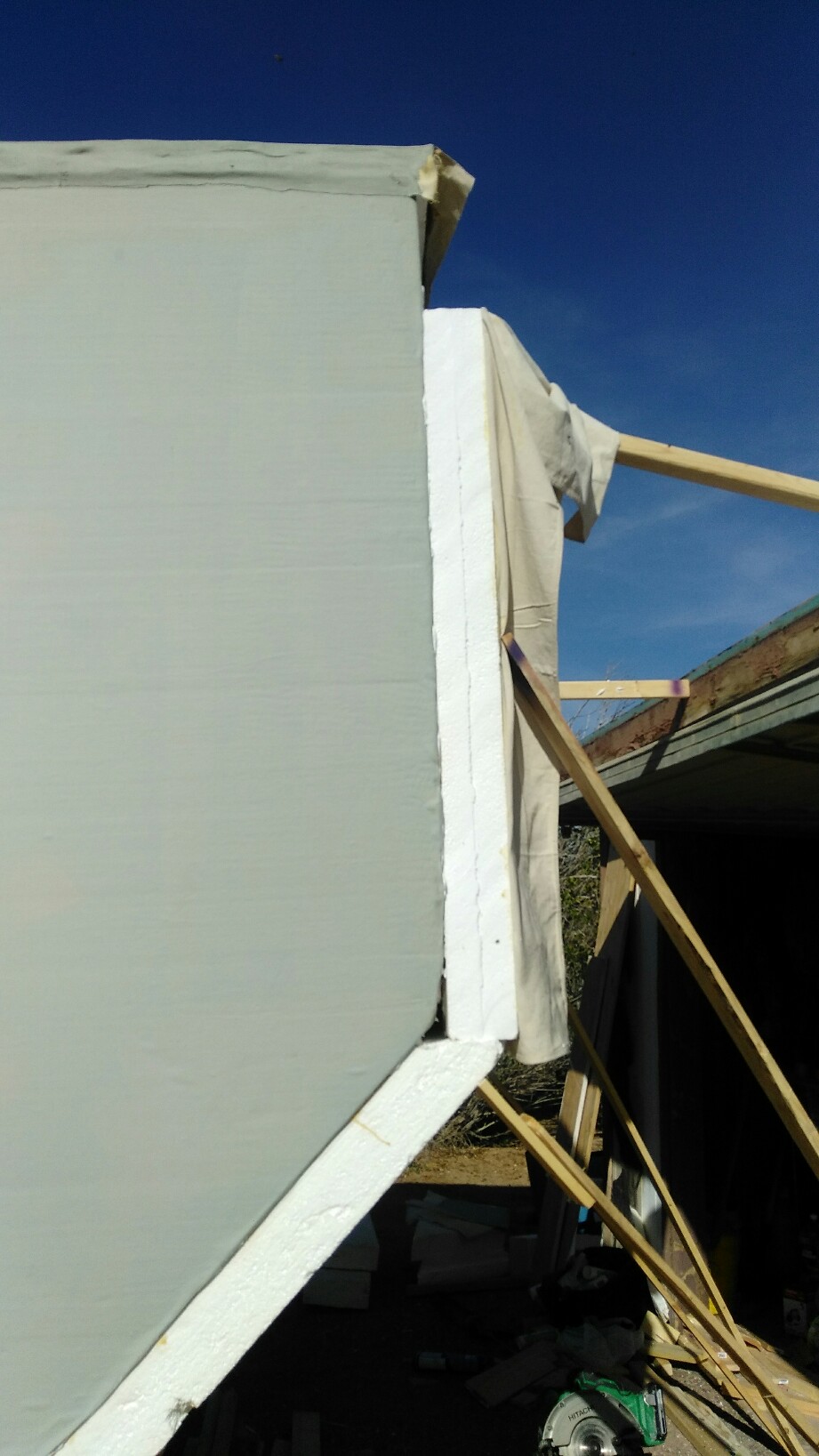

So I continued with the build. :twisted:
Delighted to be at this stage, enclosing the box with the final panels. Had to adapt and adjust at the end with an extra 12". But with styrofoam, that was quick, fast and painless and why I had bought extra. I haven't scrapped one piece at this stage but had offcuts which I made do with.
Was contemplating building a GhCoe box trailer as I had enough left for that. Wasn't in the cards with my time constraints and schedule overruns but not ruled out for the future to attempt for sale.
The last panels being mounted and supported with what I could find, a garage wall. One must be resourceful in life with MacGyver skills.

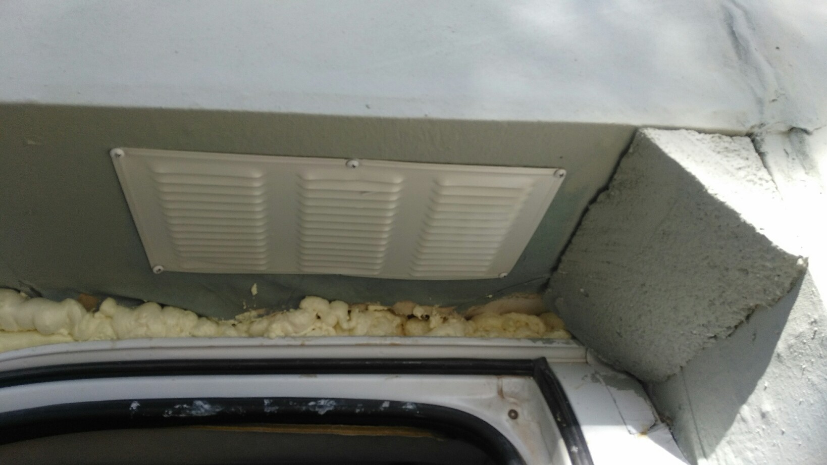

So looking at my build, what was ideally the best place to minimize a sticking out vent with leak potential?
There are six sides to an RV and numerous possible locations.
Here's what I decided...

4" styrofoam would give great insulation but would eventually not change the fact that eventually inside temperature will equalize to outside temperature. The foam would only slow down the transfer rate by hours. And fresh air is always a good thing.
Normally we use vents and opening windows for air circulation and for cooling, closed for cold air.
I was contemplating no windows at this stage for stealth and making do with very bright LED light strips in the interior. When I wanted daylight, I went outside.
But cool fresh air would still be needed. Had found an under spot that would be ideal for an air intake, out of rain infiltration. Perfect location in a dead space, ideal.
From there I could create a duct into the interior from the overcab storage space if need be. Or just have a door and leave it open. Or I could....
Use the 5 12v computer fans that I had bought at Goodwill for this purpose. They could be switched and controlled as required. Should be low cost and effective.
Ideally, hopefully, maybe. TBD, to be determined. It's winter and the nights are cold, and days mild to cool. Not an issue at the moment.
Now for through flow of air, I originally planned air outlets out the back. But I figured I could easily cut and install further ducts and outlets in the back wall or through the floor. Will work with this at a later date as it is low on the priority list at the moment. It's winter and cold air flow isn't desirable!
Phew, that's a breathe of fresh air! :D

No worries , we all have these misconceptions when we start ….We all have a tendency to OVERBUILD …
1. You don’t walk on your tent roof eh … and that’s not a priority around here except from the novices ..
2. Your car doesn’t have a vent in the roof , just windows … Around here in our wet clime … putting a vent in the roof is an invitation to a leak … :o The old timers would put a small vent high on the wall . ( old timers were Smart , not trendy ) The addition of a small floor vent creates a natural flow through ventilation . No fans required … Screened windows (that open ) are always nice to let the air in and out …
3. Metal roof ? Maybe Overkill eh ? Unless you’re parking under trees in a storm … WE used 18oz. canvas on our roof and all, doubled in many places … STRONG !!! … never regretted having a reallty thick roof covering after a tiny limb went right through my Jayco POS roof …… in ten places … :frightened:
4. JMHO , all cooking should be done Outside the trailer ( why TDs are ideal ) … Otherwise you will need fans … and will be washing the walls often to remove the cooking spatter and remove the smell. FS only has a microwave , toaster oven ,and a coffee maker … If I want to fry fish , I’ll do that over a small campfire outside … just like people do when CAMPING .. ;)
We build to suit ourselves… What you want is what you’ll be happy with !!! … Build what you want , the way you want !!! And don’t worry , anything obvious will likely be noticed and commented on … :thumbsup: ( we got your back )
And from our history around here … pictures are much better than lengthy epistles …. Nobody here likes to read much ( especially the BIG threads) , and have told us as so … ;)

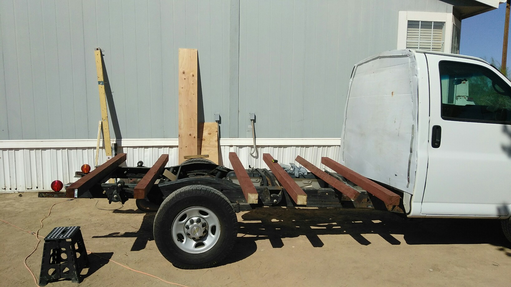

One aspect that I haven't covered so far is the deck which is kind of important. On my previous Armorhaul build where I extended a harbor freight trailer from 4*8 to 6*10, I had welded 2*2 angle to do so. It wasn't strong enough and flexed alot. How did I know? First trip that I made, I was flagged down by a motorist, the back door was flapping open going down the highway at 65mph. Lol.
Had to strap it shut and would later screw it shut.
Important lesson learned, the foundation is critical to the strength of the rest of the build. It had better be strong to eliminate any further flex from chassis and ability to absorb impact.
So I started with this
Make it so.
Projector
Posts: 159
Joined: Wed Aug 29, 2018 2:13 am
Postby Projector » Thu Jan 24, 2019 11:10 am
After which I ran around parking lots looking at how cube Van boxes were attached to the chassis.
Surprisingly, many had wood 4*6 simply u- bolted to the frame and small steel cross ribs that the flooring was attached to. That's it.
Unfortunately, the GM chassis isn't flat and couldn't bolt directly to it like the Ford and Dodge were. Plus the axle bump meant that I had to raise the deck above those, adding weight and unneeded layers but had no choice.
So I divised my own deck similarly. Attached treated 4*4 that I triple coated with Rust-Oleum rust paint. My own version of the mix which I think is just as water resistant and durable. I glued and screwed two layers of 3/4" plywood, cross directionally layered, to the cross beams, and quadruple coated them on both sides with Rust-Oleum. Not necessary being in the SW, but would this always be the case?
It's also my plan to lay styrofoam underneath for insulation and keep any splashing water from constant and direct contact with the decking.
Was going to make sure that I had a strong foundation this time with which to build upon. 7 beams total for an approximate 24" on center spacing.
