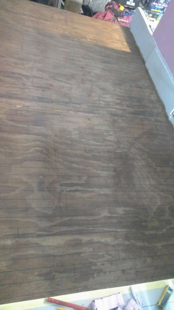

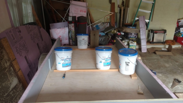

Today I finished cutting and routing the rest of the flooring and got it glued together.
I'm planning on using a permanent marker to draw lines on the luan before I stain it to make it look like wood plank flooring.

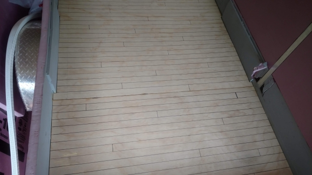

The floor glue-up worked great, and next, I took a black permanent marker and drew straight lines every two inches across the trailer to imitate flooring. Then I randomly drew perpendicular lines every other "board". It turned out nicely before stain, and even better looking with English Chestnut stain. I know the actual wood grain destroys the illusion of wood floor, but for a lightweight wood floor, I like it!

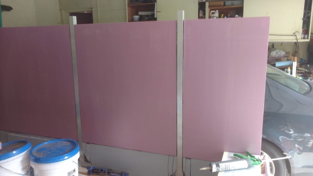

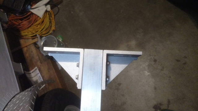

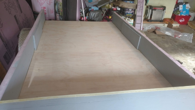

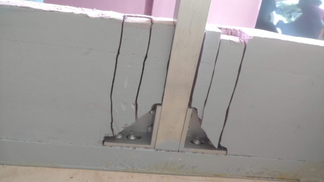

The break let me mull over how to have a roof rack, and I landed on the perfect (I think) solution. I bought four 48" long 1.5" aluminum square stock, and got aluminum corner brackets. I attached two brackets to the end of each bar with self-tapping galvanized screws.
Then, used my handy soldering gun hot wire to rout out the foam down to the rails.
Then routed out two runs to get the drill down, and attached the bar right to the rail! The rails are 3' apart at the outside, and I'll have a 4" long roof rack that I'll make out of t-slot aluminum.
The wall board got two slots routed out, then put up. I won't foam this all together just yet, as I have a few more steps I'm going to do first. The wall is a rectangle now, because I'll be cutting the luan I'm using for the wall first, then using the luan form to cut the wall foam exactly the same on both sides.

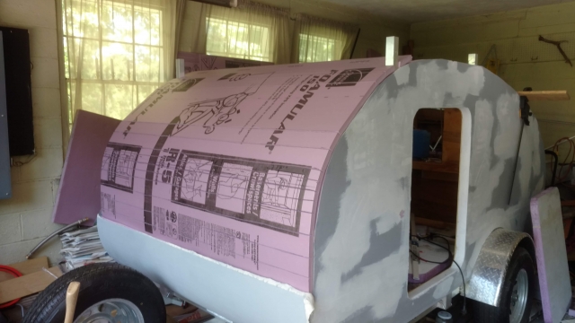

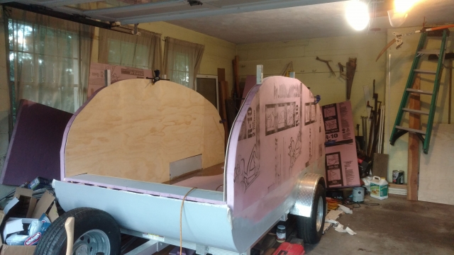

Postby zzzizxz » Thu Jun 13, 2019 8:36 pm

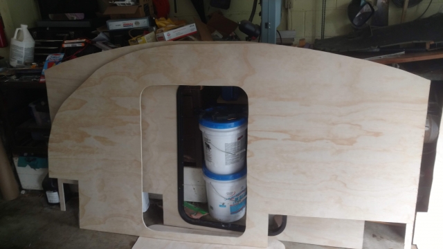

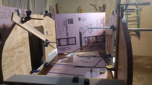

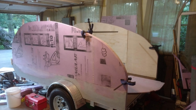

Got the lauan cut out, and the walls shaped, and it is finally starting to look like a teardrop!
I won't glue the wood to the interior until after I've run the wiring, so it is just clamped in place for looks.

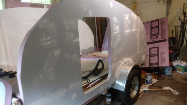

Postby zzzizxz » Sat Jun 15, 2019 10:40 pm

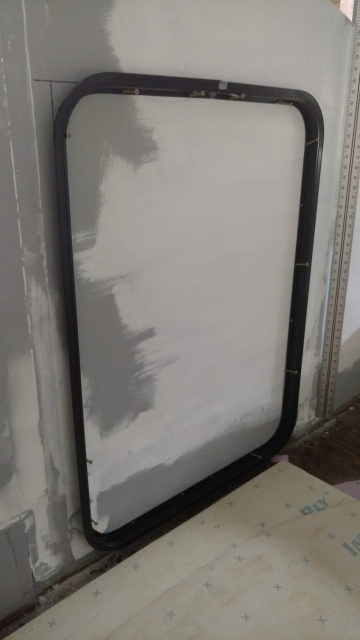

I used the door trim to mark out where the doors will go.
And got the foam cut out for the doors.

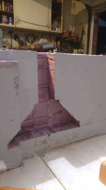

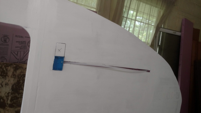

Hot wired out the spot for the light switch box, and the conduit running back to the galley area where all the electrical will be.

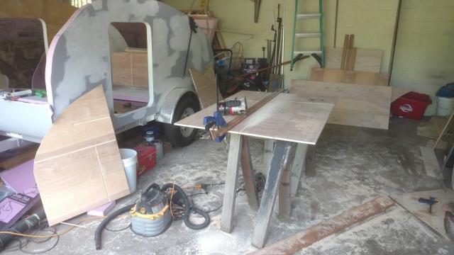

I got the lauan walls cut out and put on the first coat of varnish.
Then tonight, I slathered the backside with caulking, and installed the interior sleeping compartment walls.

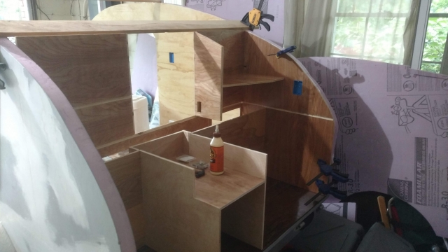

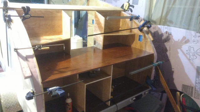

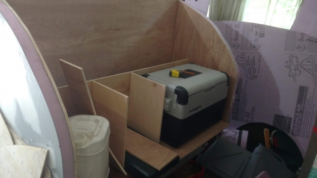

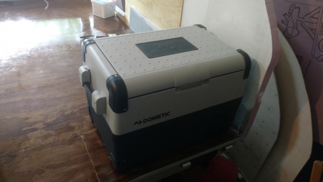

Lots of things I need to catch up on. First thing was a got my 12v fridge! Dometic CFX50. With that purchase, I was able to set it in place and start making hard measurements for the galley.
As I started cutting things out, and playing with placement and options, everything started to become more clear in my head.

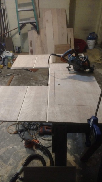

I almost never make any CAD drawings, or even many sketches of any of my projects, I just plan them out mentally, and do what I see. The galley was one of the things I didn't have a good mental plan for, just because there were still so many variables that I didn't know. I could see the dimensions of the cooler online, but that was not the same as having it in front of me. I wasn't sure if I would have the cooler on rails and have it able to pull out from under the counter, or would I make the top of the cooler the same level as the counter?

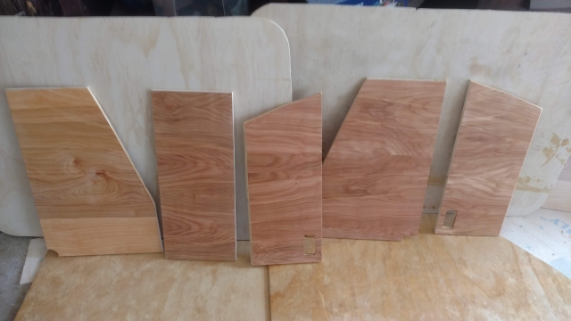

I've been making the galley pieces such that they will slide into routed mortices. I wanted the extra strength doing it that way since I am only using 1/2 birch plywood, rather than 3/4". That did make for some extra measuring and math to make sure everything would fit correctly.
My work space is my wife's half of the garage, and I have a circular saw, jigsaw, router, drill, and shopvac. Basic tools, but I'm able to do what I need to.
For most of the pieces, they get a couple coats of waterbased wood flooring poly. The birch looks AMAZING after the poly goes on!

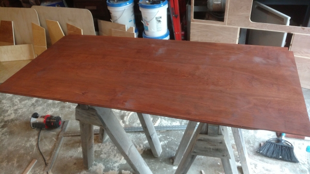

The countertop was stained with a coat of 'gunstock' then a coat of 'red oak' I'm sure there is a stain that gives the same red/brown color, but I had those two on hand, and the wife loved the way those two brought out the reds and browns of the natural birch.

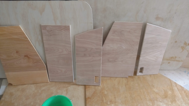

Today, I was working on gluing and nailing everything together. In this image you can see the routed mortices, and the way everything will slide together.
I dry fit everything to help keep the interior walls pressed firmly against the foam, so the adhesive caulk can dry overnight. It really is looking like a trailer!
Next will be roof, and wiring!

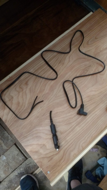

Postby zzzizxz » Wed Jun 26, 2019 8:40 pm

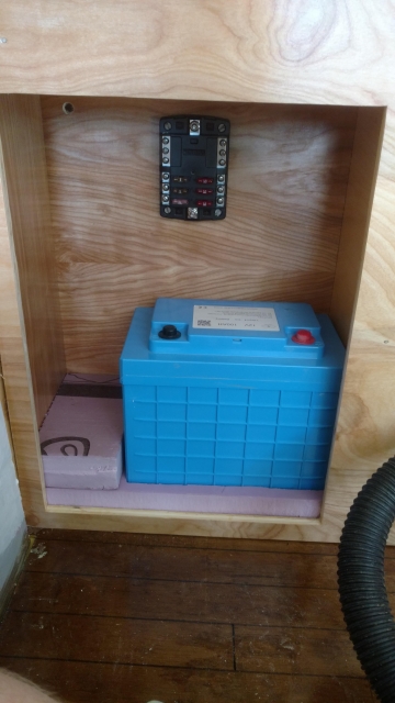

Started working on the electrical system. I'm planning on using some foam to hold the battery in place, although I may put in some hooks for an elastic strap to make sure it won't go anywhere.
I screwed in the fuse box that I'll be using. I probably don't HAVE to have one, but I figure it won't hurt either.
Everything I read said that the best connection for these 12v coolers is to wire it directly to the battery, and not rely on the cigarette lighter plug. Those plugs are notorious for wiggling out while driving, leaving you with a thawed fridge.
I was a little nervous cutting off the end of a brand new plug, but Dometic must know that many people do it, as they helpfully labeled each wire to show which was positive and negative.
I wired it to the fuse box with a 15a fuse.

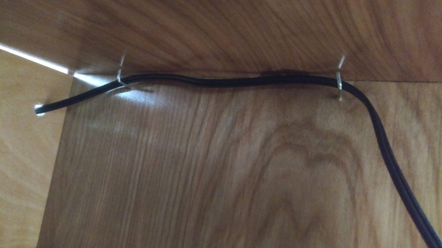

To make sure the wire doesn't get caught in the drawer slides, I screwed in two L-hooks at the top of the cooler area, and ran the cord through them, leaving myself enough cord to pull the cooler out all the way.
