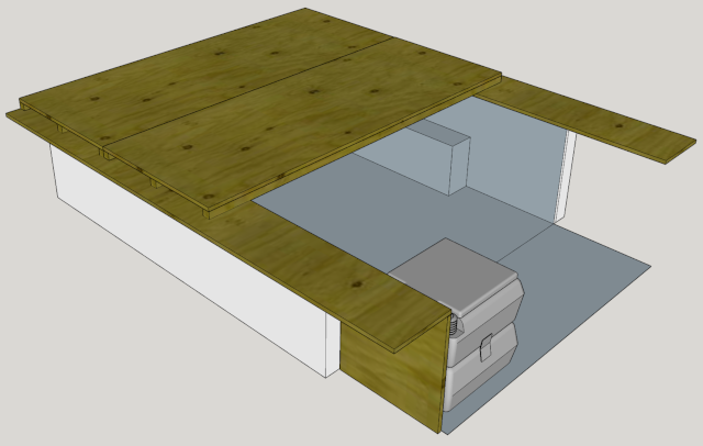

GPW wrote:DB, where’s that sketch ??? :o We usually reduce photo sizes on our photo software “ View” in tool bar , “ Tools” , “adjust size “ ( 600X 800 ) works well for this site … Good luck !!!  :thumbsup:
Well it was here yesterday. It would appear this forum is not Google Photos friendly... Let me reduce the photo size in GIMP and upload it to the gallery... I was trying to avoid that.
Here it is, I hope...

Postby pchast » Thu Sep 19, 2019 9:06 pm
That works nicely. Thanks.

Postby GPW » Fri Sep 20, 2019 4:40 am
That’s very Nice layout !!! Lots of room for your “stuff”. :thumbsup:
Re: Truck camper build.
Postby RJ Howell » Fri Sep 20, 2019 5:49 am
So then the futon/couch is also 'over' the rails? I may be catching up to what you were talking about before (sometimes I'm slow..).

Postby dbhosttexas » Fri Sep 20, 2019 11:34 am
RJ Howell wrote:So then the futon/couch is also 'over' the rails? I may be catching up to what you were talking about before (sometimes I'm slow..).
Yeah, and nothing to apologize for. I am having issues with getting the image up here, finally gave in and created my own gallery here. Not what I wanted to do. I like having my images centralized in google, but it doesn't work well here...

Postby RJ Howell » Fri Sep 20, 2019 12:10 pm
Light dawns on marble head!! I follow now! That opens up a huge area of storage or your water tanks you've been talking about! :thumbsup:
