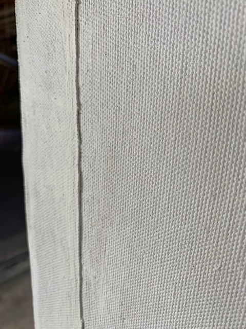

I did my edges and fold unders' today:
They are definitely not as nice as George's...but hopefully 'okay' for a first time builder.
Questions:
1> Should I go over the "leading edge" of all folds/edges with more glue, once they dry?
2> What is the stuff you coat the underside with?
3> The "drip edges" are held in place....how?

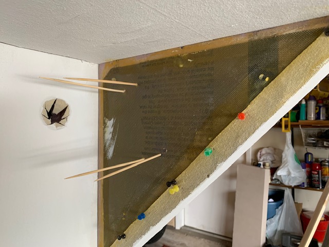

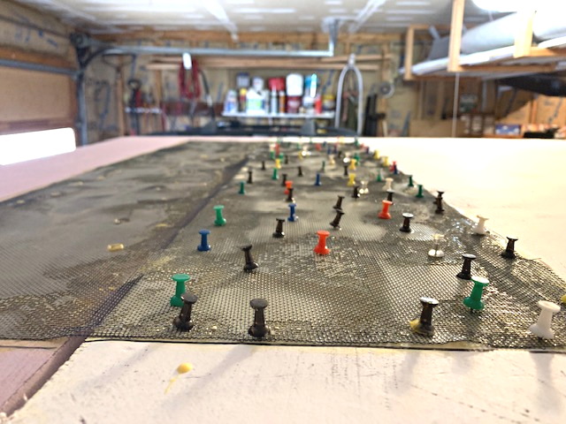

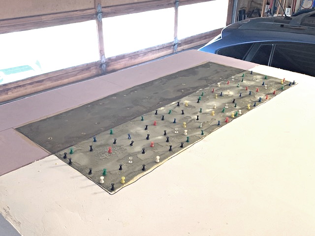

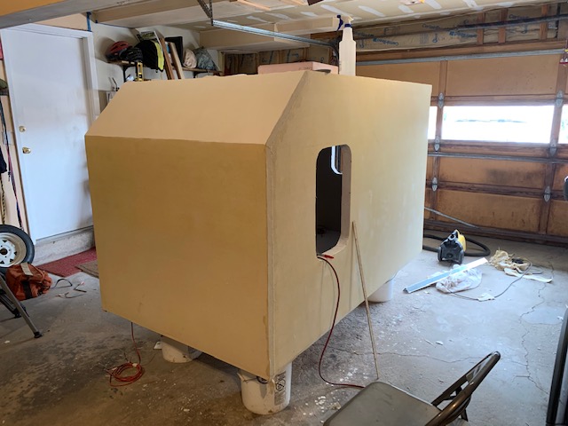

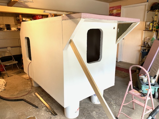

I am gluing the rear "overhang" back on after cutting it off to make canvassing the rear wall, easier:
Gorilla construction glue and added a "screen" between the existing roof and the added overhang:
Many push pins will hold the screen down while the wood glue dries:
I pre-installed 1/2 of the screen on the overhang side and canvassed the underside of the overhang before glueing it back on.
The screen across both pieces will ensure it will be solid. Will canvass the roof and overhang as one panel.
The overhang looks a little weird after seeing it off, for weeks
But hope it looks okay when back on the trailer since there is a cargo rack behind the sleeping quarters...

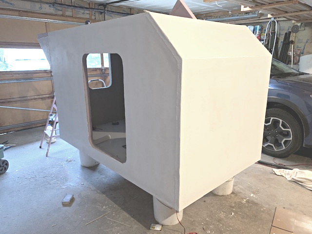

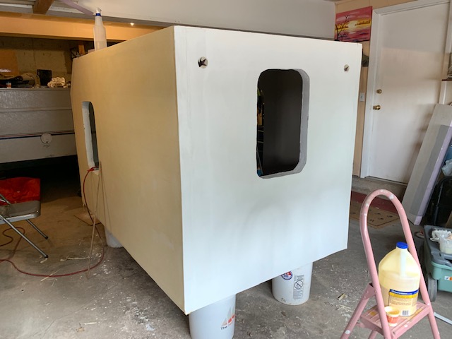

Primer coat has been applied to lower body as well:
Now have to wrangle that "Elastomeric Roof Coating" for the bottom...

JazzVinyl wrote:Now have to wrangle that "Elastomeric Roof Coating" for the bottom....
When I did my floor I just rolled the body onto it's side. I used some left over foam strips to support the body to keep it from getting damaged.
George.

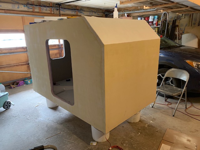

JazzVinyl wrote:A little more progress...
Skewers hold it until the glue dries:
Pretty soon, I will be fresh out of excuses not to get the exterior canvassing done!
And oh my, the acoustics inside, are sooooooooo nice!!
The skewers are a novel idea. Looking good!

Sparksalot wrote:Skewers hold it until the glue dries:
Hey Sparks...
Can't take credit for the wooden skewers, idea, saw others doing it here, and copied the technique. Was also crucial to getting the roof on, by myself!

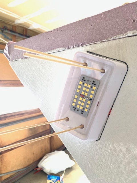

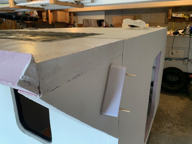

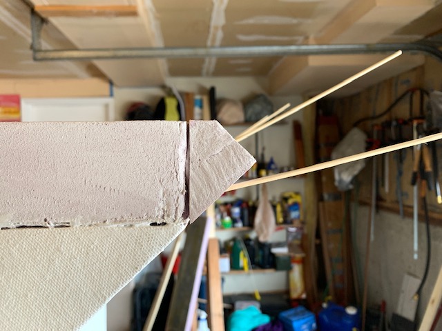

Postby JazzVinyl » Fri Apr 03, 2020 4:28 pm
Adding a regular outside RV style light:
Other side:
The rear overhang triangle is "screened on the inside", and is strong enough to accept machine screws to hold the "regular RV outside" light, on.
I also didn't like the way the overhang just terminated flat down. So glued in a little triangle so that it will terminate with angles.
Does not look that great here, but wife and I agree that this, once canvassed, will make the back look a lot better than the straight down flat cut did..
Will cut the part that is too tall, flat/even with the roof, once the Gorilla glue dries...
Ah...here is the 'final' aft profile...just need some lightweight spakle:
Hope everyone is staying safe, and staying well....!!!
