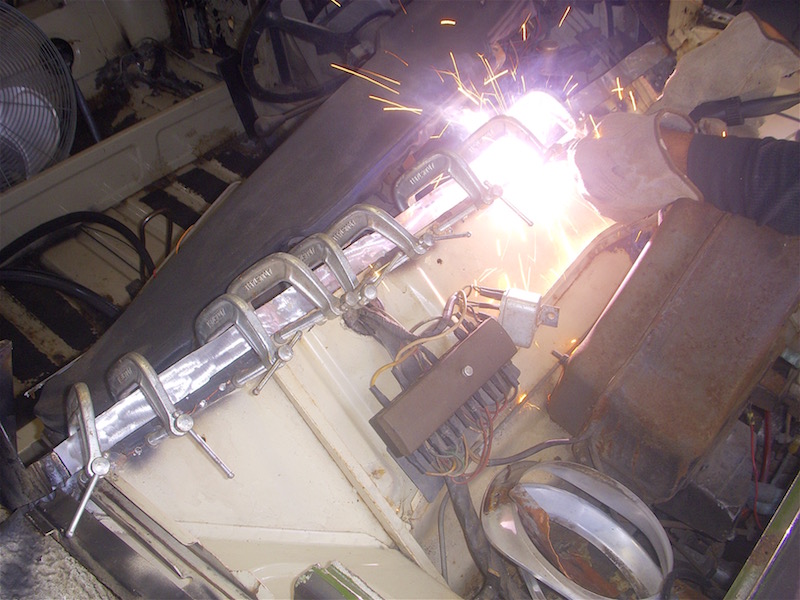

TT, welding is pretty EASY if you have someone knowledgable to show you how ( or watch the gazillion videos on You tube to learn to weld ) … The new little welders ( cheap) work fine for our kind of welding needs … :thumbsup:
Here’s a pic of welding on my old SAAB resto … Easy with a modicum of practice … A valuable skill to learn for trailer work … :thumbsup:

Oh man, looks like I might have to learn to weld...thanks for the ideas and encouragement. I think I'm going to plan on learning and tack-welding the nuts onto the trailer, though it'll probably come later in my overall process.
