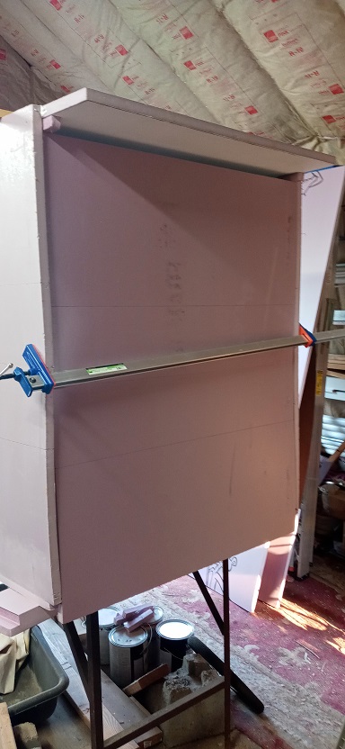

Some more updates to #5
Tested fitted the back wall after cutting out.
Test fit

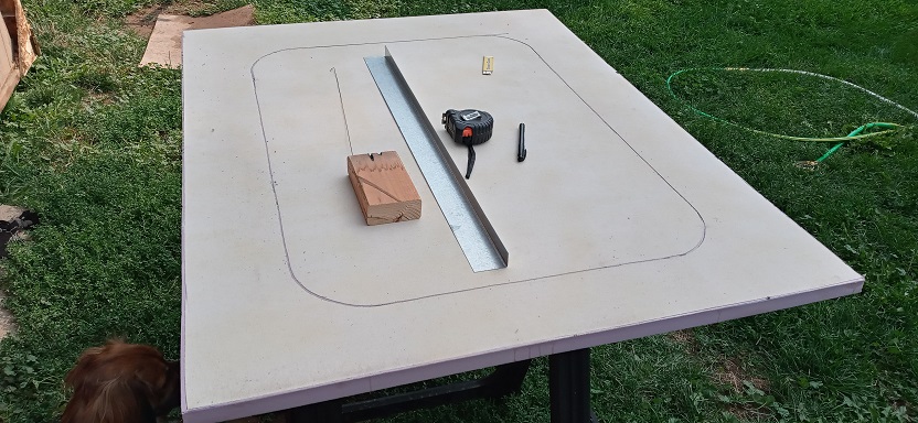

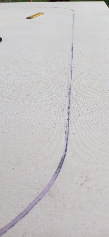

After the test fit it was time to cut out the door. I had already canvased the inside wall so I marked my door pattern out.
Preparing to cut out the door
20210821_164728_HDR s.jpg (401.83 KiB) Viewed 1796 times

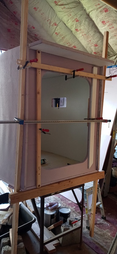

Aligned and clamped for the glue to dry.
Everything is aligned
20210822_102709 s.jpg (375.99 KiB) Viewed 1796 times

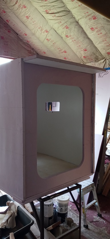

And a shot after the clamps are removed.
Installed
20210823_122607 s.jpg (354.78 KiB) Viewed 1796 times

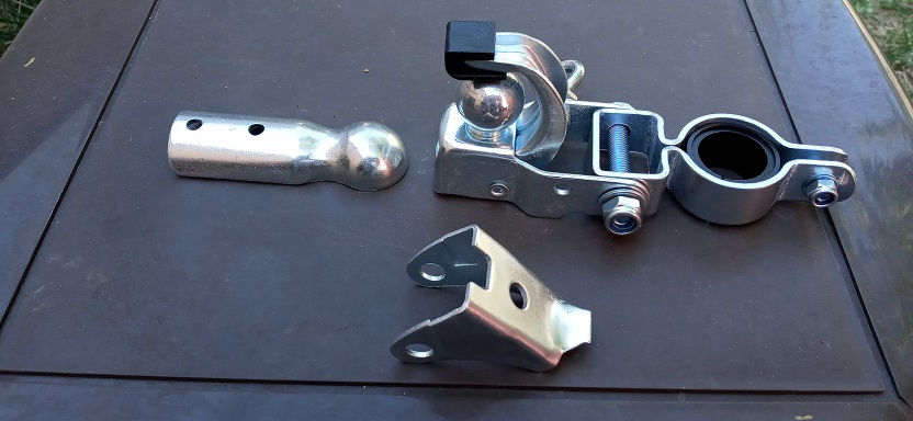

I have been trying to find a hitch that was going to work well for this project. In most cases the hitches I have seen on other builds were home grown. There are a few common hitches that attach to the rear axle and they are easy to find. I needed something that attached to the seat post or a bracket that came out behind the rear tire. There are a few of those out there, but they usually proprietary and cost quite a bit. I was watching a person in Europe that showed this hitch briefly in his video and so here it is. They are a bit hard to find to get to the states, but it is a nice sturdy hitch and should work fine for this build.
Hitch
20210826_175029 s.jpg (348.85 KiB) Viewed 1793 times

Postby CRZ42 » Mon Aug 30, 2021 2:49 pm
That is a real slick hitch. Far nicer looking than a lot of the ones that mount to the rear triangle.

sgraham wrote:Do you happen to recall the name of that small hitch you found?
Ah, perhaps "Ventura Zinc Coated Bicycle Trailer Hitch for seat tube or seatpost clamp" (didn't want to post a link that looks like spam since I only just registered here!)
