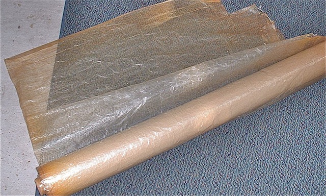

Speaking of Thrifty , a friend dropped off a roll of clear “sail” material (freebie) ... looks like a Kevlar grid on one side , clear plastic on the other (thin) ... Wonder what this could be used for ??? A Good salvage sometimes has to wait for purpose to catch up... :roll:
If I could just attach the Kevlar grid and remove/peel the plastic , I’d have some great reinforcing strips , would probably disappear under the canvas... :thinking:

Postby TJinPgh » Tue Sep 18, 2012 12:06 pm
How wide is the roll?
Could it be used as a moisture barrier someplace? How about between the floor and the trailer?

Roll is 48” wide , but the plastic is Very thin ... :NC

Wow Glen, that's quite a score. What you're looking at is 3DL, a sandwich of aramid fibers (Kevlar) and mylar sheet. It's used exclusively in high-end race sails. The material is designed so that it will hold its shape and not 'bag out' (stretch). If you're racing at that level, you would likely bag out a conventional Dacron (nylon) sail in a season or two.
One of the boats I'm working on right now has an extra (longer) boom and a suit of 3DL sails for it....big $$.
Unless he's racing, he's using the standard boom and his Dacron sails.
The mylar is heat-sealed to itself, so you would likely make a mess trying to get it to delaminate, as that what it's meant specifically NOT to do.
I don't know of too many places where I'd use it on a foamie, but since it was free...
Maybe where you want to increase panel stiffness in tension, like on the underside of a roof to keep it from sagging ?
Is there enough to stitch an awning out of it ?
Though the incessant krinkling in the wind might drive you nuts.
That might fit with the techy, 'aviation inspired' lightening holes in the ribs...and the strealined design overall...
Usually old sails are cut up to use for sail bags, gear bags, duffels, etc. A restitched mylar bag used to be a rite of passage in sailing: everyone acquires a Dacron one after a while, but if you're lucky to be around when a 3DL sail is decommissioned...
Now of course, you can just go buy one from Sperry, Helly Hansen, etc.
Being a textile that's engineered specifically for sails, it works solely under tension.
You're going to have to play around with getting an adhesive to stick to it though.
You model guys use mylar sometimes, don't you ?

Sounds like a good thing to use for reinforcing model wing spars.
How about making a high tech light weight hat? :R 8)

Sounds like other than maybe using it as part of a sandwich component someplace (like between the foam and a piece of interior luan the best use for it is what you said... cutting it into strips and using it for reinforcement on seams.

What do you have to use or do to get something to stick to mylar? IIRC it is pretty slick, no?

Is there enough to make a sail for a puddle duck racer? Maybe there's another project in your future.
