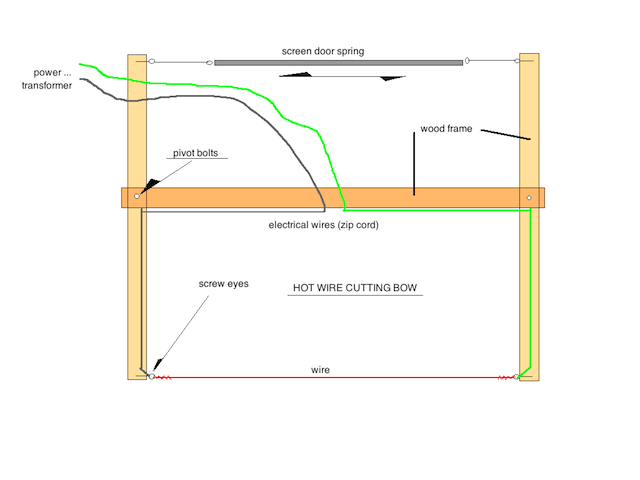

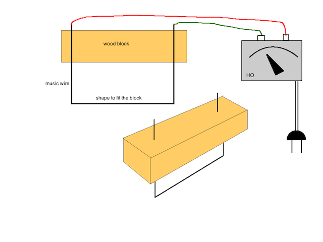

Now if you want I can show you how to make your own HW tools ... Thrifty !!
BTW, I’ll be doing some hot wiring of the Paddleboards that we’re going to make .... will post some pics of the process... Basically with a HW , you make and attach templates to the foam ( I use Masonite ) and the the wire has a “guide “ to follow ... Kerfing would be particularly easy to do with a HW and jig /template ... not near as messy either , just some long thin strips to toss, not all that foam dust ... I know I mentioned that a while back ...
