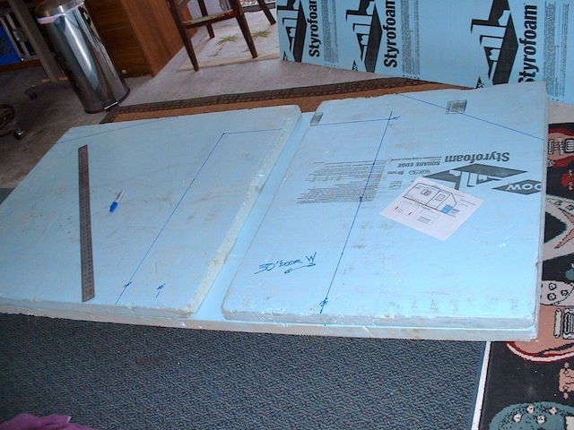

OK, Not too exciting , but I measured the foam for square and size , found it 1/2" short ... 95 1/2" :o Made some critical measurements , used a straightedge and a Sharpie , made my cut lines ... so that is the drivers side.... Won't plan on any window(s) till I find something I like or is cheap, whichever comes first... :roll: Easy to cut them in later...
Now , on to the passenger/curb side..

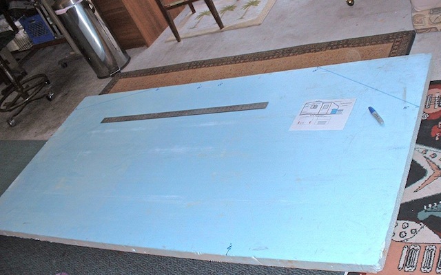

Postby GPW » Sun Mar 06, 2011 1:34 pm
Using the shorter pieces , made up the other side ... only have to join the two pieces with a small scrap over the door , which will be wood braced anyway ... 8) Image
Now , the front , back and roof ... the door will be tentatively 30" wide and 40" tall ... that seems big enough huh ? Actually a little smaller because of the framing ...

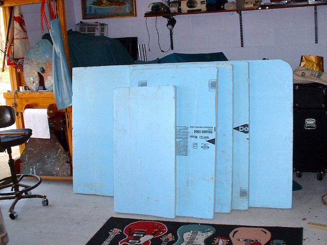

Postby GPW » Sun Mar 06, 2011 2:24 pm
....and now , the rest of the foam ... Made my cut list , just enough foam almost exact if I'm careful , but if I have to buy another sheet then I'll cut the parts out of the good stuff first , save the freebies for shelves etc.
