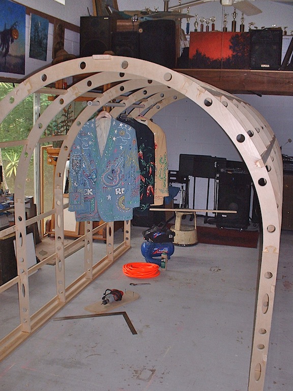

Thanks !!! It’s finally coming along now .... Time is getting short for the deadline ... :o
Tried PVC pipe for hanging things :thumbsup: .... just some band jackets we had in the Studio as an example ...

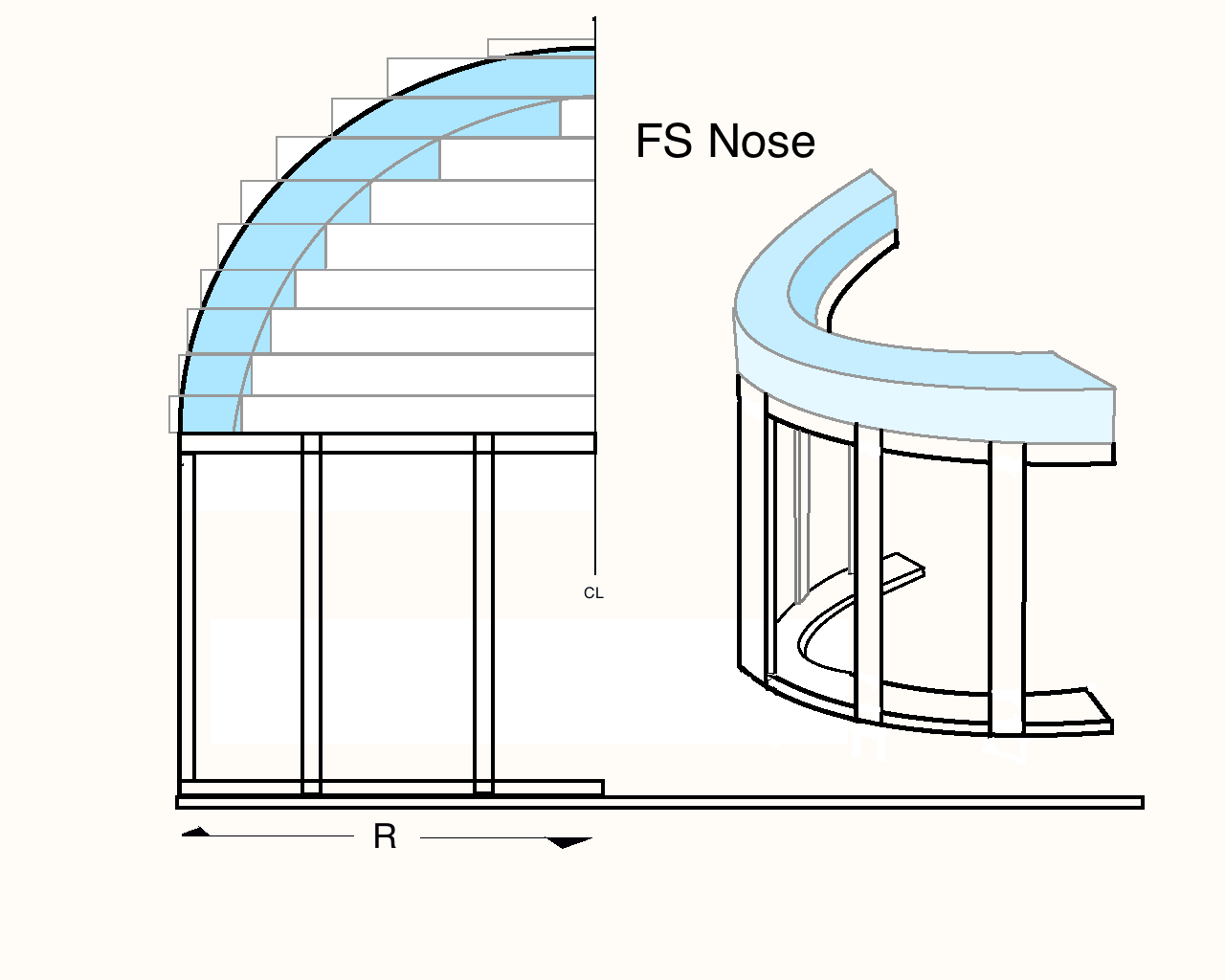

I just half-fast read through the entire FS thread here [almost as 'bad' a
going through the 'Big thread !] and didn't find any specific mention of,
so I'm curious if you had any ribs done for the rounded front, or did
you just elect not to do so and decided to just 'carve it out of foam' ?
You did mention front ribs in ths post -
viewtopic.php?p=964512#p964512 ] but I didn't
see anything further as to if they were done or not. [Unless I missed it].
Just curious...
Anyway, for future iterations, [ since Vinnie said he'd be willing to cut ribs etc. for others:
viewtopic.php?p=964183#p964183 ] one could use the
semi-circular topsections as semicircular horizontal framing for the front lower
wall, and where this lower 'front' straight wall meets the top wall and roof semi-circle
start, one could use either full semi-circle arch sections fanned up from the horizontal
to the first upright section of the main body, or half semi-circle sections ["quarter
sections" (?)] fanned vertically from one side to the other. Or, probably easier, just fan
half-ribs [or half-bents] vertically from one side to the other. My thinking here is, that it might
be easier for, a neophyte to foam, to apply the foam planks/pieces to the rigid shape that
the ribs provide as opposed to carving it all out of the foam freehand, so to speak, and trying
to keep the semi-circular shape true, - sort of letting the CNC cut pieces handle that aspect
of it.

Thanks everybody !!!!! ... we’re just so Happy to get this far ... :D I’m still surprised how quickly the frame went together ... Half a day and it was done , and with no help either .. 8)
Norm , there will be two half ribs , one glued to the floor and one positioned about 3 feet above it , connected by more stringers that will form the front round shape , leaving the top section to be carved ... Not so bad as trying to carve the whole front , and much more sturdy ... ;) Just the nose of the trailer is good for another 15 sq.ft. of floor space , and a shelf the same size above it ... :thumbsup:
Even Vinnie was surprised by the assembly , and immediately started thinking of other uses for the ribs ... movable hunting camps , storage sheds, playhouses for the kiddies , and shed for his motorcycle ... He’s already got the Program , so if anybody else wants ribs , he can pop them out on the machine ... Now I think he wants one too ...

Here’s a better drawing of the nose , and ribs /stringers ... :SG

Norm makes good point about having a couple of radial quarter arcs coming from the center of the forward most vertical hoop and landing on your curved front knee wall. That would make a good sanding guide and would also allow you to piece the fill in parts from smaller scraps.

KC , I was going to use a cardboard template for the Round bit , but a built in guide wouldn’t be a bad idea :thinking: :o ... Anything that makes it easier and more accurate is Very GOOD ... as proven by those CNC ribs .... I’d have Never gotten that much consistency doing it by hand ... I’ll consult with Vinnie , he’s the one who has to still cut out the front ribs , and would likely agree with youse’ guys ... ;)
