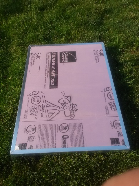

GPW wrote:Any thoughts on bending/folding that flashing and using Pop rivets to make rudimentary FRAMES for the foam pieces.
Not sure if I understand what you are getting at. I did make frames to fit around the doors on my first attempt at installing hard edges.
Door framed

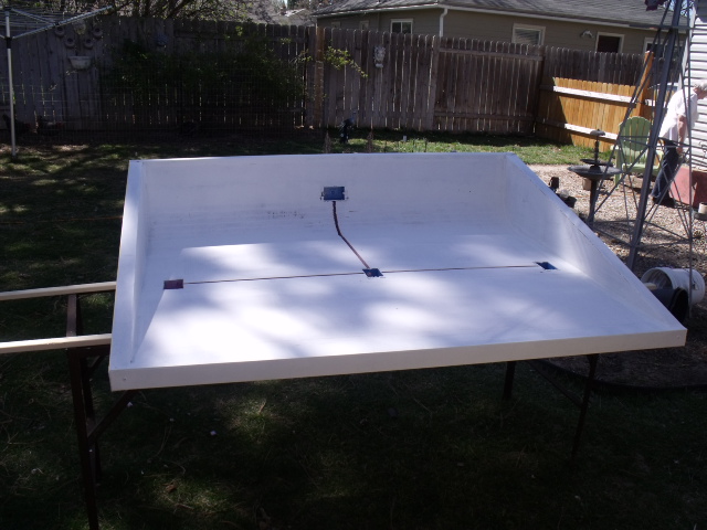

Postby ghcoe » Sat Apr 02, 2016 9:38 pm

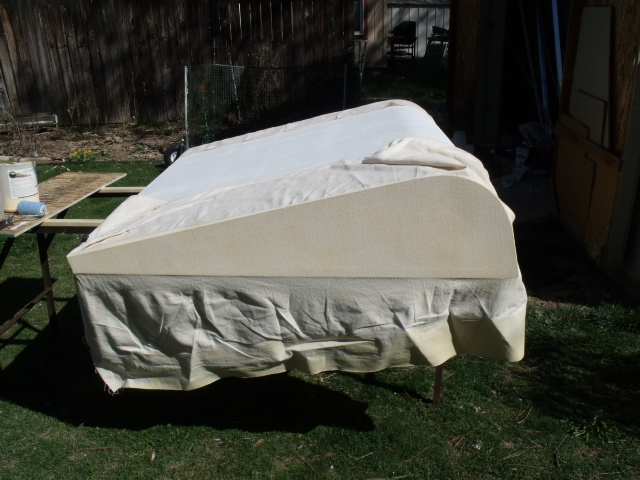

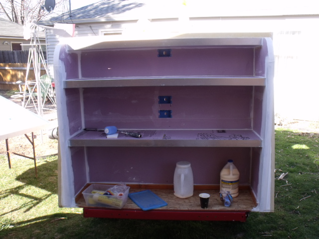

Two more days of work on the trailer. Was able to finish off the canvasing of the roof and begin the fairing in of the galley area.
Roof and hatch
Before
After
George.

Postby ghcoe » Sat Apr 02, 2016 9:42 pm
Also, started to fair in the inside of the hatch too. Figured I had better do that before finishing the exterior side.
Before
After
George.

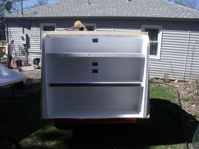

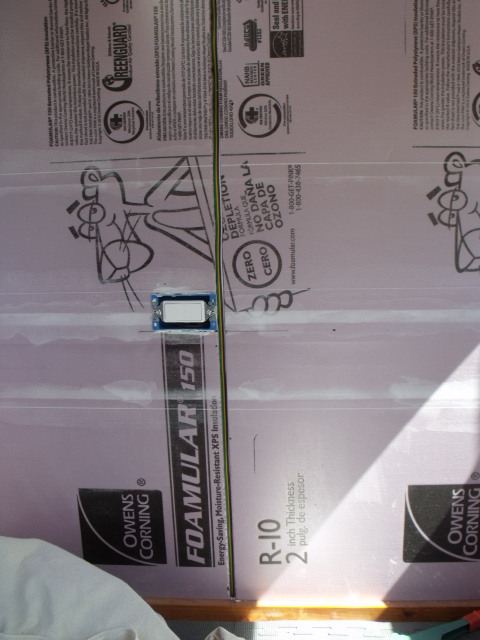

Postby ghcoe » Mon Apr 04, 2016 7:21 pm

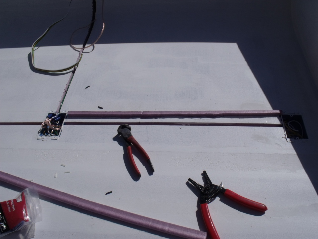

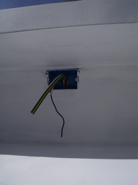

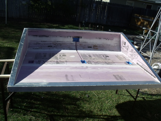

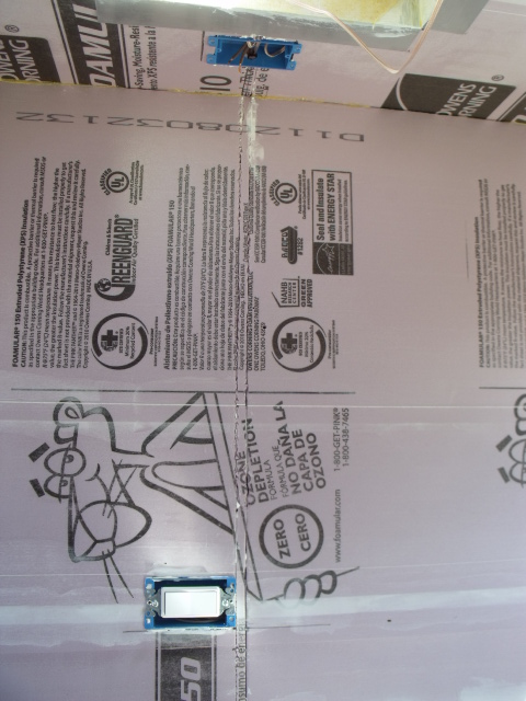

I did get most of the wiring in yesterday.
Wiring
Wiring #2
Wiring hatch
George.

Postby S. Heisley » Mon Apr 04, 2016 7:27 pm
One of the many advantages of using foam is that the walls are thick enough to use those plastic electrical junction boxes! It's looking good! :thumbsup:

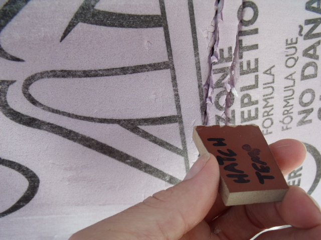

Then it was time to fill in the channeled foam. Caulking first,
Caulking
Then use flat device to squish foam back into cut out channel. This also makes the foam even with surrounding foam.
Replacing channeled foam
Almost looks perfect. Now a little sanding and filling to fair it out.
Finished

Postby ghcoe » Mon Apr 04, 2016 9:16 pm
S. Heisley wrote:One of the many advantages of using foam is that the walls are thick enough to use those plastic electrical junction boxes! It's looking good! :thumbsup:
Thanks Heisley,
The foam is not thick enough for a standard size electrical box. I have found these at Lowes. They are a 1 1/4" deep with no weird tabs to mess with. They are a little tight for wiring when using switches and outlets, but work great for junction boxes when routing wiring.
George.

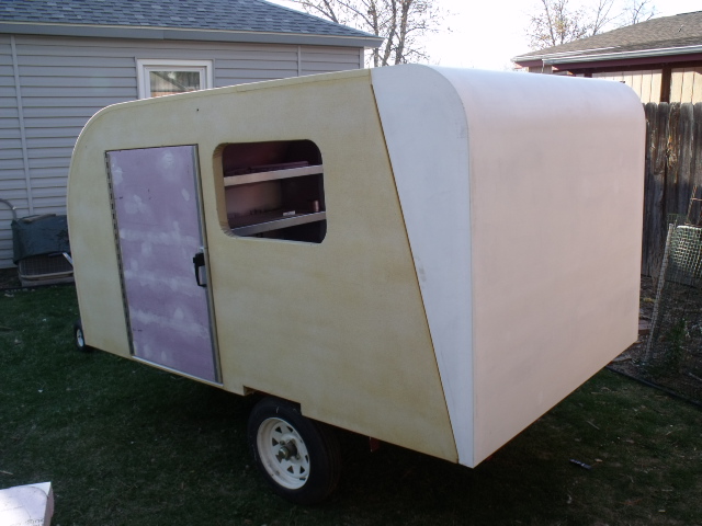

Postby ghcoe » Mon Apr 11, 2016 8:43 pm
Some work done this last weekend. Started to fair the road side door for canvas. Hung the curb side door for fitting and started the canvasing process on the hatch.
Draped canvas
Glued canvas
Edges canvased
George.

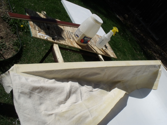

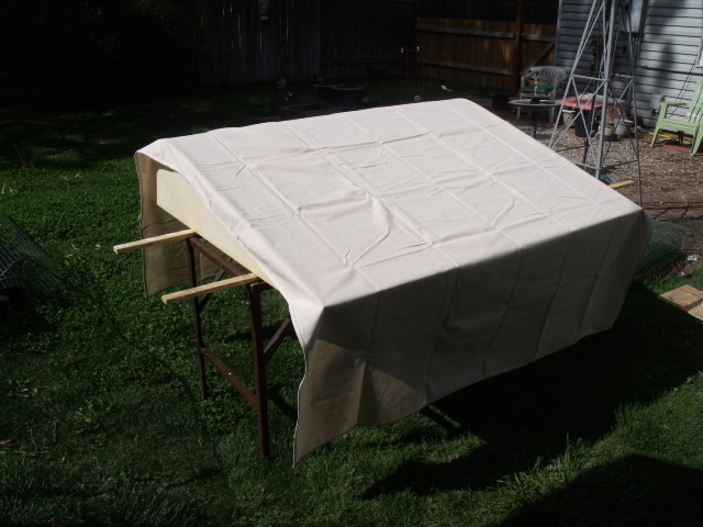

Postby ghcoe » Sun May 22, 2016 5:11 pm

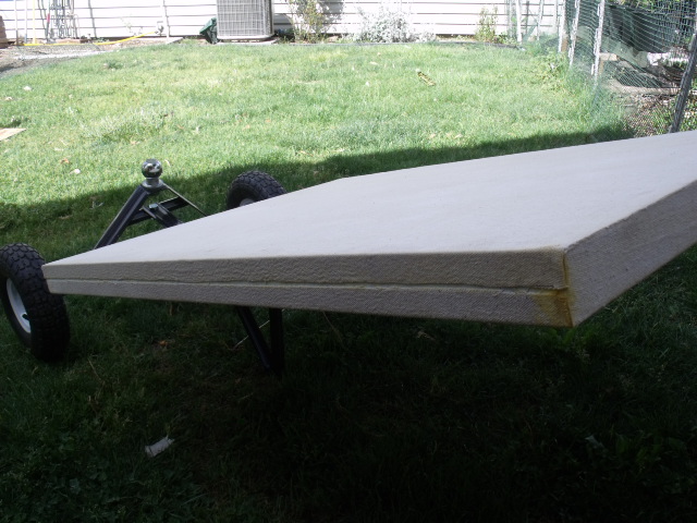

Another short day of foamie work. Was able to get the road side door canvased and remounted. Going to be a tight fit I think once the foam heats up, but right now it is ok without paint and cool. We shall see. Anyway I weight the door and it came in at 6.8 lbs.
Door

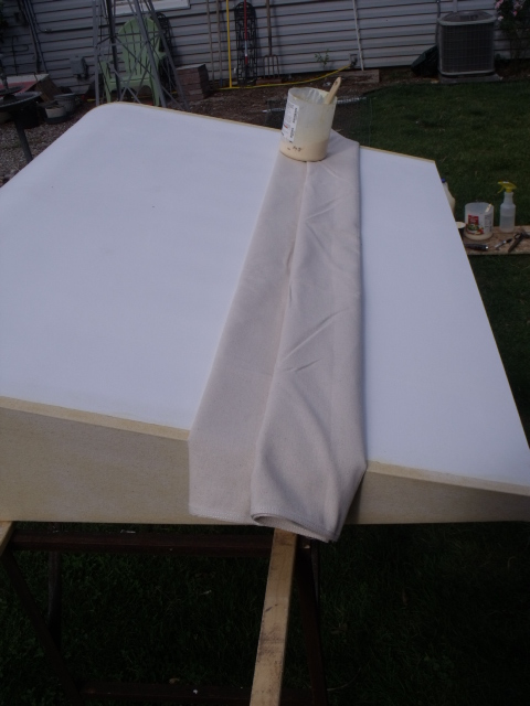

Worked on getting the hatch covered with canvas. Went smooth and fast luckily since the rain storms moved in.
Working with the canvas on the hatch was the same as the roof. I placed the hatch on a table so that it was flat. Then I place the canvas on top and centered it to where I wanted it to be.
Canvas centered
Then I folded the canvas into small folds. In this case I folded from both edges.
Canvas folded
George.
