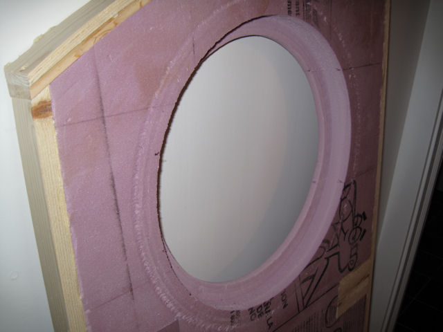

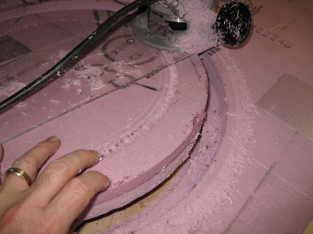

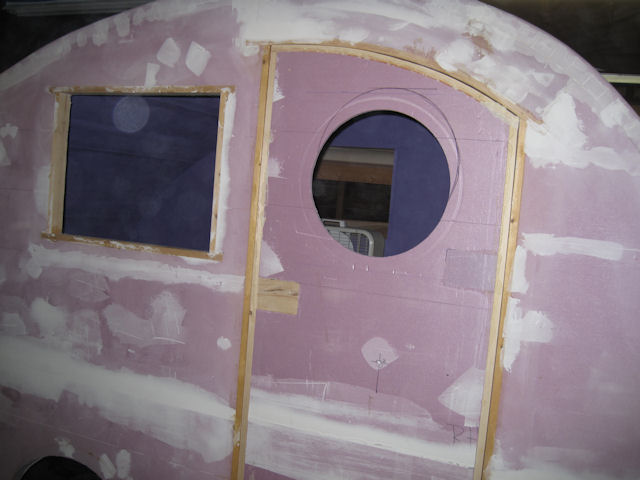

Postby mikeschn » Wed Jan 25, 2012 7:16 pm
There's some good ideas here guys. I decided to do it Glenn's way, with the DIY jig that Bill found. Going to fasten the glass right into the foam, without wood.
Here's today's progress...
