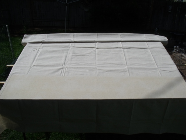

With each fold I made a "witness mark" so that I could tell if the canvas was staying centered. When I did the roof I had a problem with the canvas shifting to one side and it was sometimes a pain to get it re-centered. With the "witness mark" at each fold it reminds me to check and to easily verify that the canvas is staying centered.

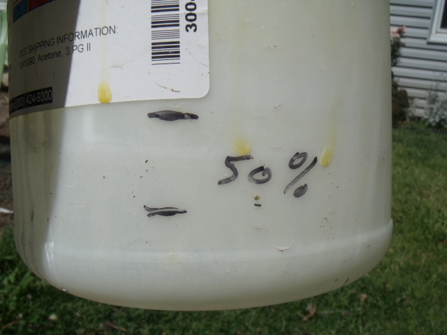

To go through procedure again. First I mix the TBII 50/50.
50/50

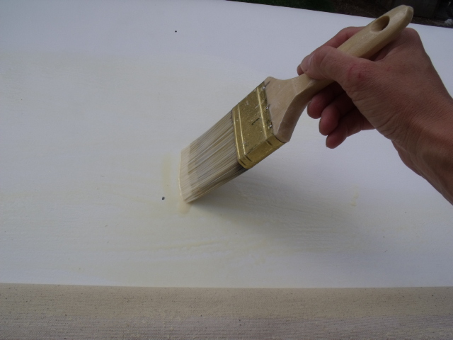

Next I apply glue to the body. I use a 4" brush for application. I apply glue to the body till I cannot feel the brush "drag" but is a nice smooth "slippery" feeling. I brush on enough glue to the body to lay one fold of the canvas into.

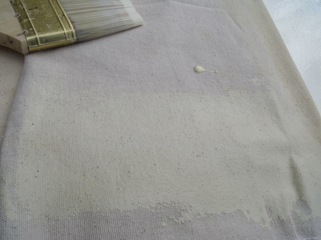

Once I apply the glue to the body I then work on the canvas. I am working with just one fold of the canvas. I make sure to work the glue "into" the weave of the canvas. Making sure that no fiber pockets are left without glue in them. This is fairly easy with the 50/50 glue mix.
Working glue into canvas
Once I get the canvas totally "filled" with glue I then go back over the body with a second coat of glue. The first coat of glue by now should be a bit tacky. The second coat will go on much easier since the first coat will act like a primer. This will allow a thicker second coat of glue. Again I apply glue till I get the "slippery" feeling when I brush across the surface.
Applying second coat of glue to body

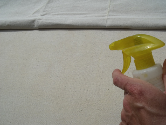

Once done applying the second coat of glue I then unfold the canvas "two" folds. This allows me to work with just one layer of canvas. Don't worry if you coated the body wider than "one" fold of the canvas, it will not matter. Once unfolded I apply water to the surface of the canvas till I see nice even coverage. I don't use a lot of water just enough to wet the surface. I believe that this starts a "wicking" action and helps to pull the glue up into the canvas. It also helps to "relax" the canvas so that you can roll out the creases. And lastly it also starts to shrink the canvas.
Applying water

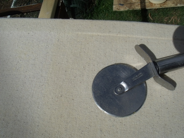

Since I had already installed the side canvas, which overlaps the edge of the hatch I am canvasing, I have a crease to work with. I find that a pizza cutter works great to help "push" the canvas down into the crease and defines the crease nicely.
Pizza

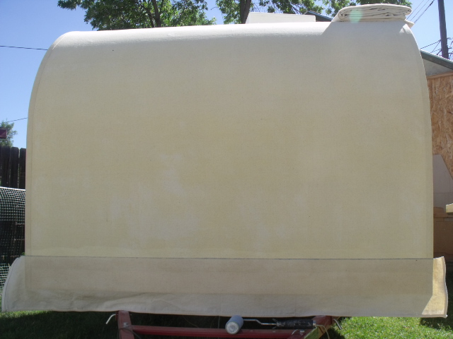

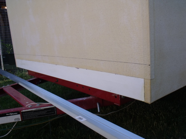

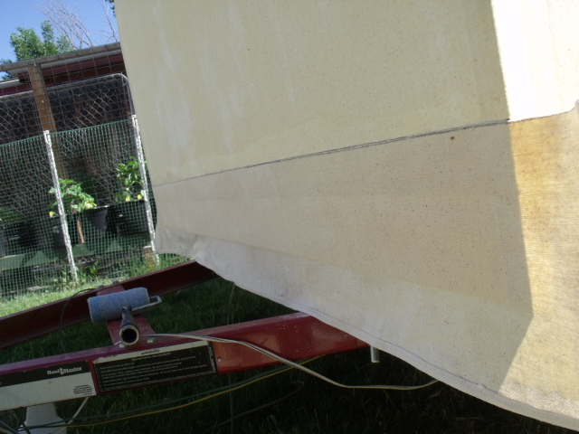

I got a bit of work done before it got hot here. Started the last piece of exterior canvas I have to a apply. Just a small strip along the front bottom edge. This should be finished tonight once it cools down. Also, started to frame the curb side door. Time to start thinking about a color scheme.
Making the alignment mark
Applying canvas
Applied
I finished the hatch last week and was curious how much it weighed. Came in fully canvased, minus tail lights at 24.8 lbs..... :thumbsup:

Postby KCStudly » Sat Jun 04, 2016 9:50 pm
+1 Looks great.
I have some vague recollection of you mentioning it before, but I'll ask. Was the extra filler strip at the bottom front because the canvas wasn't long enough?
Re: #1
Postby ghcoe » Sat Jun 04, 2016 10:30 pm
KCStudly wrote:+1 Looks great.
Yes, I allowed 12" of extra canvas to allow for shrinkage and overlap, still came up a bit short. :roll:

Postby GPW » Sun Jun 05, 2016 7:19 am

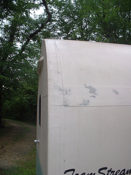

Happens !!! It’s amazing once it starts shrinking it can shrink a LOT and quickly too :o ... I saw this personally having watched the FoamStream’s heavy 18oz. canvas shrink 12” plus in length in a 10’ run ... No way to stop it :frightened: We ended up short even with the “allowance", but just lifted the rear facing end and added more canvas underneath(see pic) ... May be something to that idea of pre shrinking ... :roll: :thinking:
None of that really shows unless somebody picky goes looking for them . ( note: and we don’t Care !!! :laughter: )

Postby ghcoe » Sun Jun 05, 2016 8:06 am
GPW wrote: May be something to that idea of pre shrinking ... :roll: :thinking:
GH , Nice light hatch !!! :thumbsup: 8) :D
This was a 9 foot run. I figured 12" would be plenty of allowance, it shrunk about 15". I do not apply preshrunk canvas. I think it makes for a tighter skin and helps to pull out wrinkles. Just have to allow for that shrinkage though. Good to know which way the shrinkage is too. It definitely shrinks more one way than the other.
The hatch came in way lighter than I was figuring. It is a bit awkward to move around. I was guessing that it was close to 50 lbs. I was quite surprised, but happy to see it come in so low.

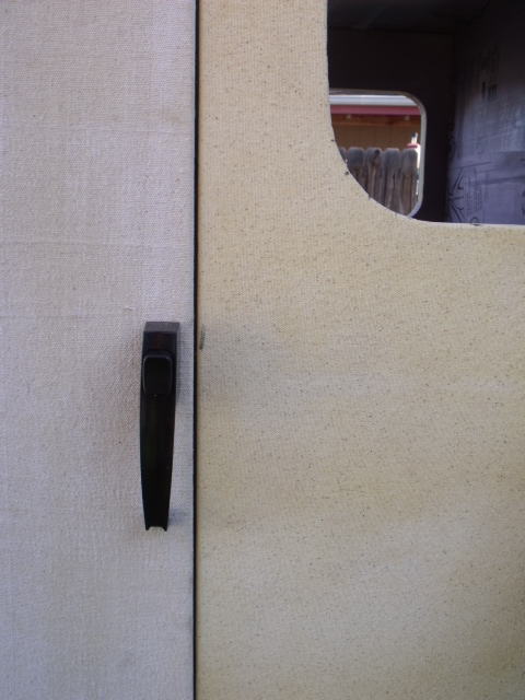

This morning I started fairing of the curb side door.
Hard edges

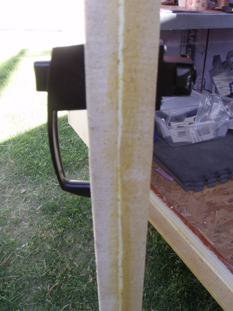

And installed handles on road side door.
Door handles
I have found that the road side door is a bit tight along the latching edge :roll: . Not sure how it is going to work once I get the paint applied. I may have to make another door at a later time. But for now I will live with it.
Installed
George.

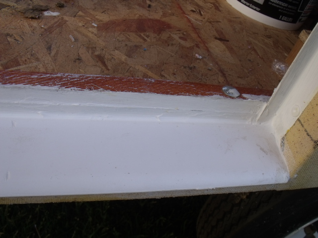

Postby ghcoe » Sun Jun 05, 2016 1:48 pm

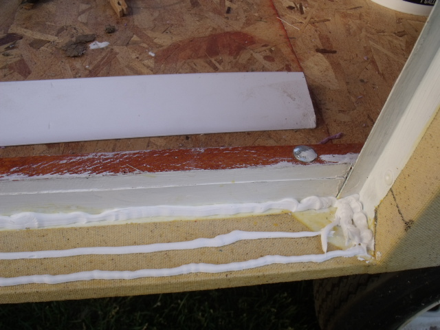

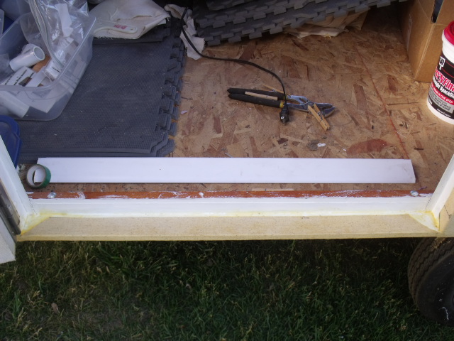

I installed flashing in the threshold but was afraid that water would pool if the trailer was uneven from one side or the other. I found a plastic trim piece that has a slight slope to it. Plastic so it will not rot and sloped so water will run out even when the trailer is not even.
Threshold piece
I used caulking as a glue to hold it in the threshold.....
Threshold piece ready for gluing
and to seal all the edges to keep it water tight.
Installed

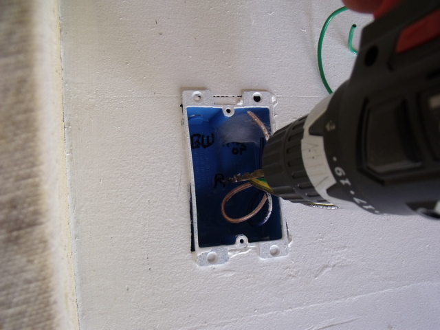

Postby ghcoe » Sun Jun 05, 2016 2:10 pm

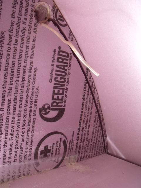

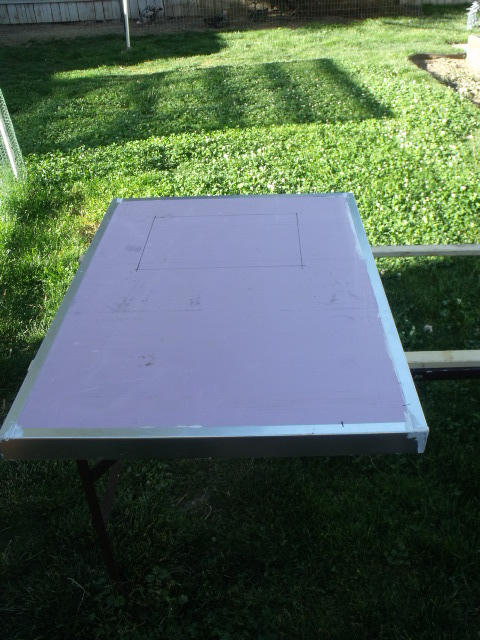

Worked on getting the tail lights ready for installation once paint is applied.

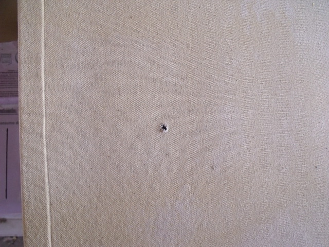

Started by drilling through the center of the junction box to the outside for a pilot hole. This was a small diameter bit.
Drilling

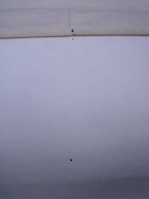

Once I drilled though both boxes I flipped the hatch over. Then I verified that the holes where in the same spot on each side from bottom and sides of hatch. Lucky me first time and holes were perfect.
Pilot hole

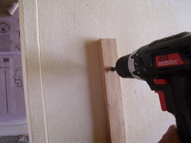

Then I used a larger drill bit that was the same diameter as the wiring sheathing. I predrilled a piece of wood to use as a drill guide and drilled back through the foam and junction box from the outside. The drill guide keeps the drill from wandering through the foam.
Redrilling
