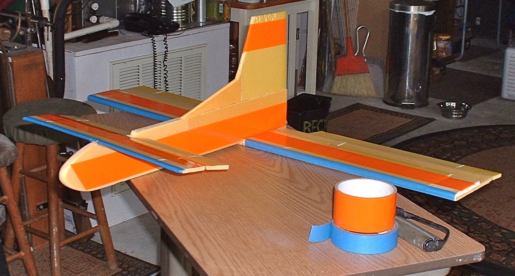

Some people in “other" forums viewing here have cast doubt on the Grippers ability to dry/cure inside large laminated panels :o .. Apparently the less porous the surface , the longer the dry time , deep in the inside ... The extruded foam we normally use for trailer building (Blu' or Pink) will take in water after a while soaking , indicating a small degree of porosity , so the Gripper would fully dry Eventually :roll: ... Yet to be determined... more testing is indicated ... Guess the next test is making a larger test lamination and cutting off strips at timed intervals , seeing if the inside glue has dried yet . Never ending this testing !!! :beer: Naturally none of this doubt would be questioned of the Gripper as an adhesive for the skins... :thumbsup:
Ps. My little Foamie plane model with small laminated panels seems to be dry and it’s stiffened up the surfaces considerably ... been several days drying now ... :thinking:
here’s a pic of my model decorated with tape ... hence the idea a little decoration goes a long way ... from a meat tray ... :oops:
