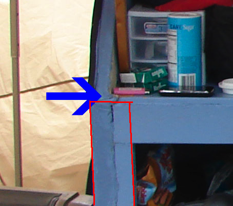

The counter face frame to side wall foam looks like it may have been a fit up issue. I'd try to spread it out a bit, scrape the paint, squeeze some GG in there and use a long pipe clamp with some pieces of wood under the jaws to spread the load out and squeeze the two walls together while the glue sets.
The second picture is not as clear, but it looks like maybe the hatch skin separating from the hatch spars?

Eagle , foam to wood join and no reinforcing strip ... ? :roll:

All the minor issues though will be easy to fix.

OUOTE: “ I don't have any interest in finishing my foamie. “ .... :shock: :frightened: Yes , those were the words of our Fearless Leader... Big Mike !!! And he’s giving it away ... :o
This is a big blow to the Foamie' movement !!! :BE Anybody got a clue why ???
Eagle , I blame the reinforcing oversight on your assembly crew... certainly not you :roll: ... but the contractor ultimately gets the blame eh ? :R It would appear there is no “skin” wrapping over onto the wood ... as you have it now , it all depends on the foam to wood glue joint , and that’s probably not enough to support long term stresses... Some scrap canvas reinforcing strips added over that area , inside and outside , should prevent any further problems ... The Good thing is , you now know where the stress points are , and can beef them up accordingly ... ;)

I think both my problem areas will be resolved with just a screw or two and more gg. Once a screw is added in the mix its a tough bond, even in foam to foam sections.
