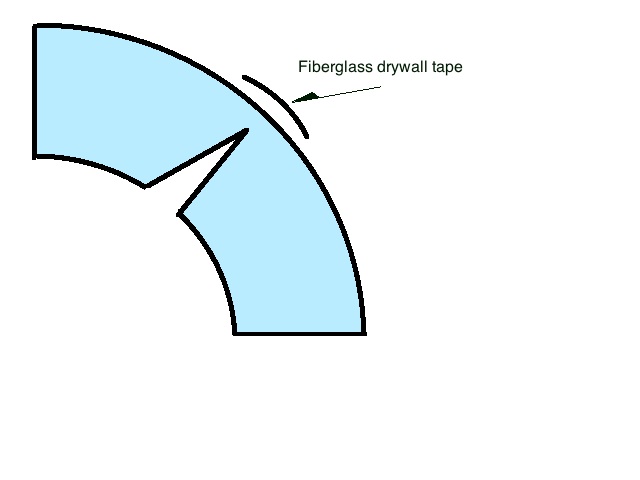

Thinking about those sheets of fiberglass drywall tape. It should be possible to use sheets of it over corners and edges, but under the canvas to strengthen them some.

At the store , we picked up some FDTape (cheap) ... Pretty Strong , very thin ... Going to try it out as soon as the kerfs are cut ... It should add lots of extra strength where we need it ... The plan was to use the tape over (outside) the kerfs to reinforce the foam at it’s thinnest part , the bottom of the kerf cut where the foam is the thinnest ...
Really , it’s cheap enough to put everywhere the foam needs a little extra strength, under the canvas .. I’m thinking , nose , roof , and floor To wall join... :thinking:

Jack , I think (OPINION) the Fiberglass tape should go Under the canvas ... Strong and much prettier that way ... ;)
