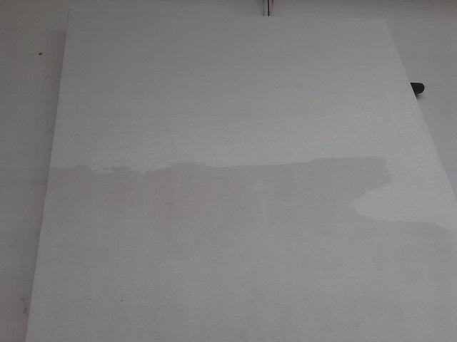

I was able to get quite a bit done this weekend. Weather was great for working on fomies. I finished sizing the trailer body and doors and most of the hatch.
Started smoothing with Coe's Foamie Smoothie Mix :twisted: . Looks like it is going to work quite well. Just one application and I think it will hide the canvas weave enough for a smooth roll on paint job.
Application
Half and half

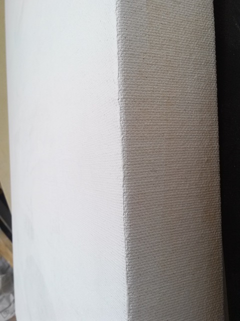

This shot shows the filled canvas vs. the raw canvas with two coats of sizing applied.
Corner

Postby ghcoe » Sun Jul 10, 2016 5:29 pm
OP827 wrote:That looks good! What is Coe's Foamie Smoothie Mix made of?
I took a empty gallon paint can and marked inside from the bottom up every 2". I added Glidden Gripper to the first mark, Dap ALEX PLUS caulk to the second line (about 2 tubes) and Dap Fast'N Final Lightweight Spackling to the final mark. Made about 3/4 of a gallon all together. I mixed it with a paint mixer on a drill and it came out nice and creamy.
Before application I sanded the canvas after I applied the sizing coats to knock down high points.
I found application to work best with a 4" putty knife. It goes on basically like you are painting on the primer with a putty knife instead of with a brush.
In most cases the canvas has a higher weave going in one direction. Working with the higher weave or going 45 degrees to it hides the weave the best. Basically you want to keep the putty knife gliding over the higher weave to fill in the lower areas. I was able to hide some small wrinkles fairly easily as well as some dimples.
I did not think this mix would go vary far. I have done both sides of the body, doors (one side) and roof, and still have about half the mix left still. :thumbsup:
For me it was easy to work with and had a long work time.

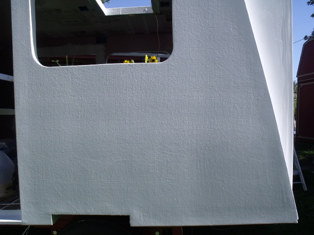

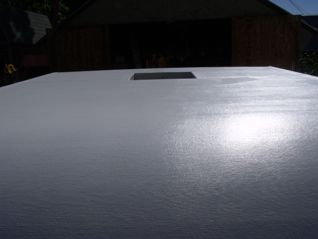

Postby ghcoe » Sun Jul 24, 2016 11:34 am
Finished up the Foamie Smoothy coating last weekend so this weekend was paint. Two coats of paint on the body, still have to finish the hatch and doors though. Might have to wait till next weekend. Once I get all the outside painting done I will be able to reassemble the doors and hatch to the body and get the windows and vent in. So I heard mention of a good product to glue windows and vents in. Not looking forward to searching the forum for the product, but if someone remembers and can let me know I would appreciate that.
One coat of foamie Smoothy mix got me to a texture I liked. I wanted a bit of texture to help hid imperfections....
Paint
Top paint
Side
