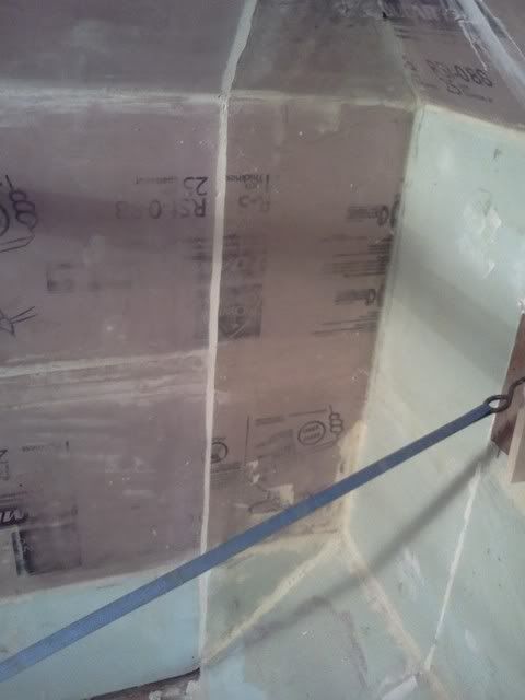

Once the sheets are pinned together with skewers, I've been using canned foam. It's PU-based, just like GG but it's about the same density as the foam once it expands, so it sands with leaving hard or high spots. Works great and it's cheap !
I bevel the edges to be joined to create a V that I back fill with foam. Go slow and keep a really light touch on the trigger and you can mete out a little at a time. Afterward, you can clean the tube and valve by rinsing with acetone - I've kept part cans for months that way. I keep the acetone in a bottle from contact lens solution: it gives me a fine stream and I can use only a few drops where I need to so I use WAY less of the stuff. Don't forget your PPE.
Here's what the bevel looks like:
Foamed and sanded but not yet glassed. It'll get a skim of thickened epoxy to fill the pores as well - you can see that in the adjacent joints.

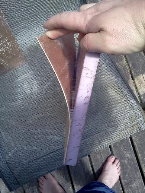

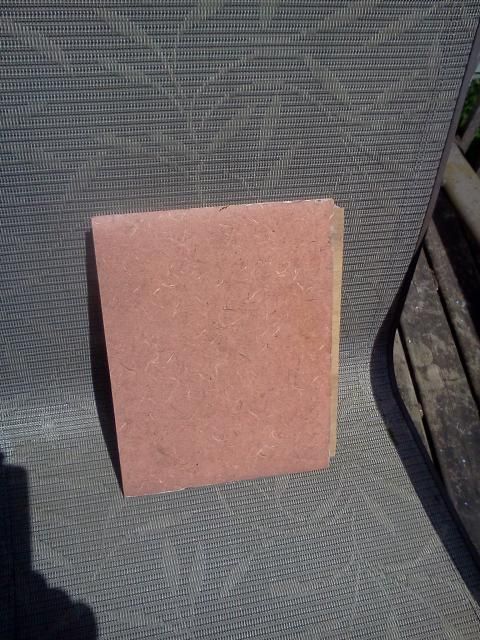

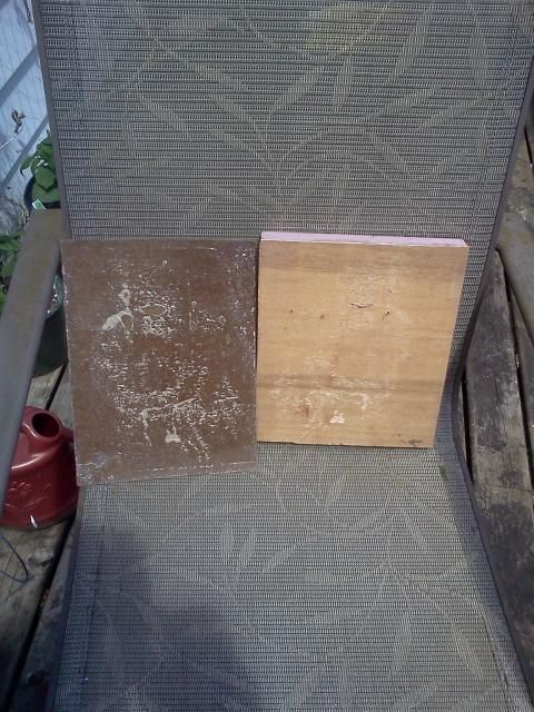

I made up some test panels a while ago, details are in my build thread somewhere. They are roughly a square foot and have a piece of 1/8" doorskin glued to 1" foam and a piece of formica glued to the ply. The glue was latex contact cement. For kicks and giggles, I just went and peeled one apart. Peeling isn't a failure mode I would really expect to see but the results still give me confidence that it's the right material for the job. YMMV and all that.
To prove that it did indeed happen:
The formica was easier to separate from the ply than the ply was from the foam but I was peeling it from the corner so that's to be expected.
You can imagine how much 'spring' the cement is resisting here. The white tip of my finger shows how much force is there - any more than that and the peeling continued.
It's interesting that where the foam failed was in a ring where the base of the paint can was that had the weights on top of it. If one were to evenly weight (vac bag?) the panel, it all ought to look like that. I'm about to start the curb side seatbox and this is how I'll be bonding the foam to the 1/4" ply top, except that I think I'll probably bag the panels rather than rolling them.
