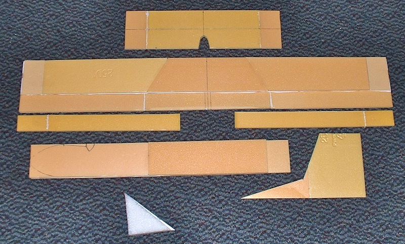

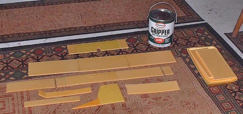

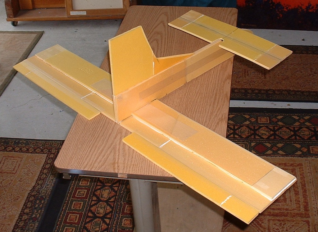

We’ve been experimenting with the gripper lately and laminating 1/4” fanfold foam (Blu) and even foam meat trays (RC planes)... Gripper used as a lamination adhesive , just seems to take longer to really dry well ...foam to foam ... foam to anything porous dries pretty quick ...

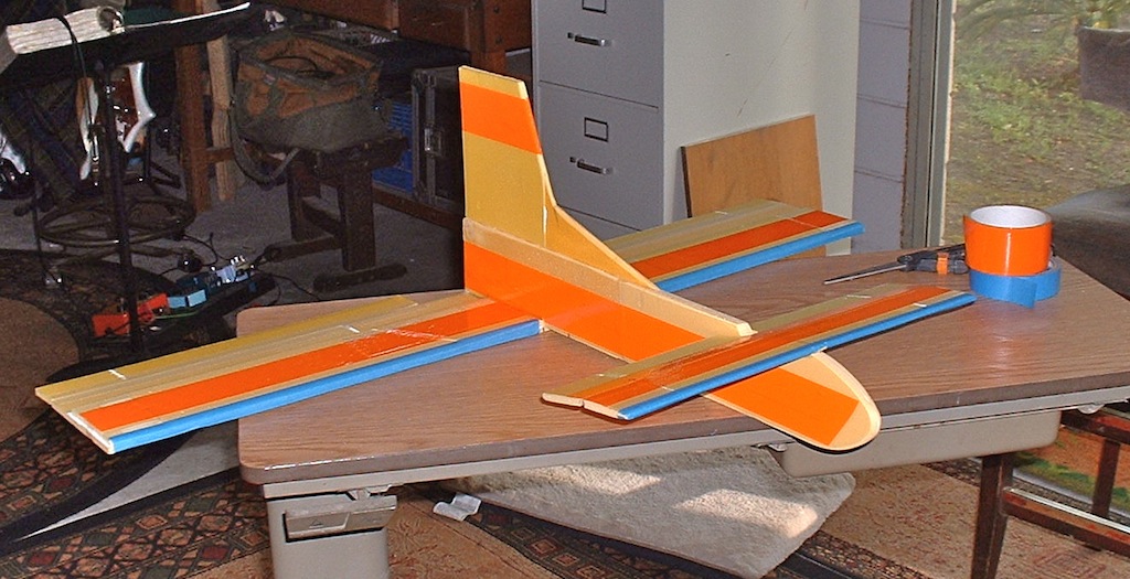

Here’s some pics of a recent plane we made using foam meat trays (chicken) , and laminated with Gripper ... very strong ... and even used the Gripper for joining the sections ... butt joins.. :o

And with a little colored packing tape ... Just a little “decoration” much as is possible with our Foamie’ Trailers ... The Decor is what makes it look good ... a few stripes here and there distract from many "imperfections” ... ;)
