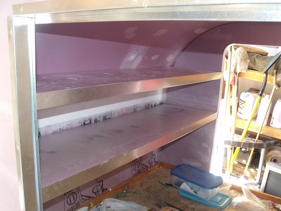

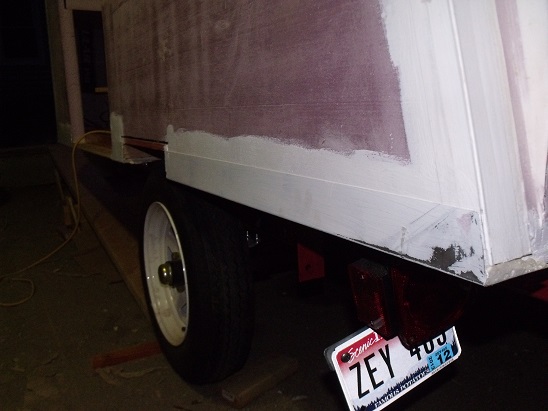

I do like the flashing along the bottom edges for a few reasons. I do believe it makes for a much stronger foam to floor bonding as well as great protection against anything that may hit that area. Also, it will make for a great attachment point for marker lights. I will be using the flashing for other hard points in the build just because it is so easy to work with and does not require cutting out foam for wood or such. I will warn you though, the flashing is a bit trick to work with to get it to lay smooth against the foam while the paint sets up. On the bottom edges I used Great Stuff where the flashing came in contact with the floor and Gripper where it came in contact with the foam.

I like the flashing so much I am also using it for around the doors, on the doors and along the leading edges of the shelves. I have glued up two shelves this way already and it makes for a strong shelf reinforcement. I also have a few other ideas on making the shelves even stronger, but waiting to see how this works by itself.
