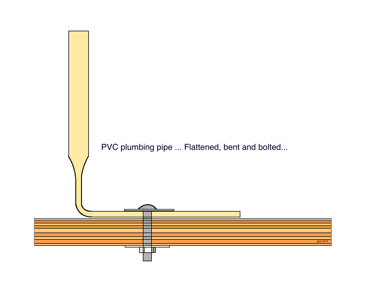

... back to PVC ... Made another drawing ... easy way to bolt a PVC pipe to the floor ...or with the same bend on the top , a top rail ... :thinking:
The drawing is exaggerated for illustrative purpose , much closer bends are possible ...
