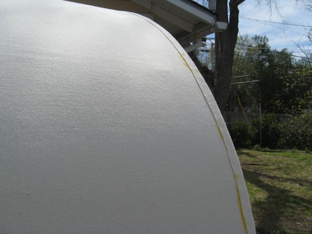

Postby Hillmann » Fri Sep 24, 2010 8:50 am
laursand,
Could you post an up close picture of the corner of your teardrop so we can see how you did your seams in the canvas?

Postby laursand » Fri Sep 24, 2010 5:33 pm
Hillmann, I have this pic of the edges...
...for actual corners, I just improvised. Some could take a fold over of canvas, on others I couldn't afford the extra thickness. Most edges I am intending to cover with trim.
