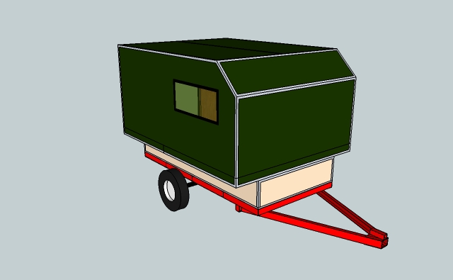

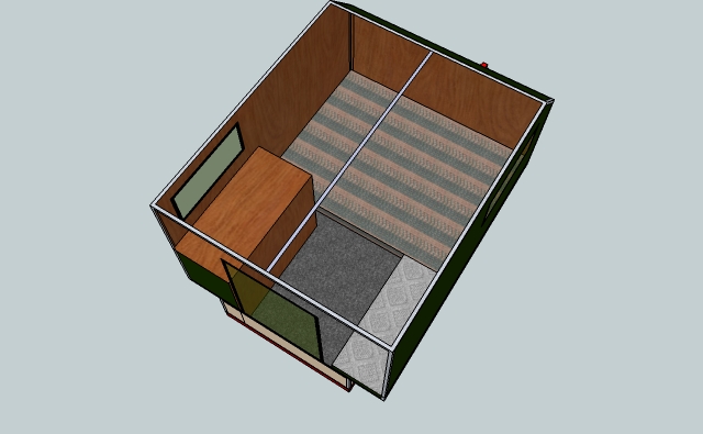

In any event, I THINK I've more or less settled on the design. Took cues from the Bunker and Steve's Microcampers as well as my own designs.
After reading through some of the glue threads, I'm still not sure how I feel about gluing fabric directly to the foam. My concerns are NOT of overall structure strength.
I trust that it's strong enough. Just not sure I trust the bond between the fabric and the foam. I worry about things like tree branches and such that might scrape up against the roof or sides while camping or parking.
I admit it... I suck at backing these things in.
So, at this point, I'm leaning a bit more toward the foam ideas that more or less started this section of the forum and going with a foam sandwhich situation instead. Skinned with something on the outside. Probably thin ply that I'll either paint or consider further skinning with fabric.
Doing so, of course, leaves me with a seam on the roof. Will just have to deal with that. Probably fiber tape it and go from there.
I like the aluminim angle of the Bunker on the corners. Although, the flexible stuff Steve uses is good too.
Steve, not sure where you found that. Is it cost effective?
Simplified interior. Sideways bed. Small cabinet. Might make a foldable or removable table to connect to it for interior eating.
About the only thing I haven't decided on yet is whether or not I want to build the box out to 5x8 instead of 4x8.
The 5x8 means there's only a 6" overhang which might have better balance. The 4x8 is, naturally, easier to build as it doesn't require boxing around the wheels. That leaves a 12" overhang which may need bracing. Not sure on that, yet.
-TJ

Re: Not sure it gets any simpler than this...
Postby KCStudly » Wed Aug 08, 2012 2:21 pm
That looks much simpler.
Is it still a standy or now just a slouchy?

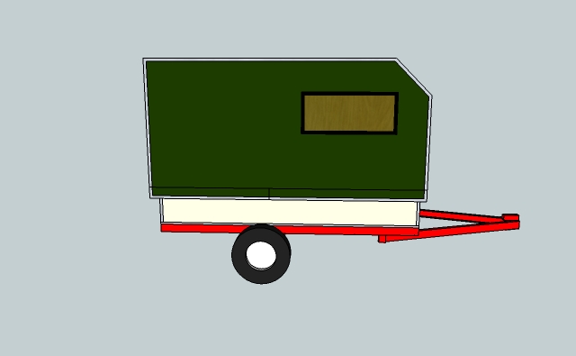

Postby TJinPgh » Wed Aug 08, 2012 3:45 pm
Slouchy. For me, anyway.
Interior should be about 5' high, give or take.
Not quite sure how much it will end up weighing in the end. Will ultimately depend on how I end up skinning it, I guess. That, and what I end up using for doors and windows.
I wouldn't think I should have a big problem keeping it under 1000 pounds, though?
-TJ

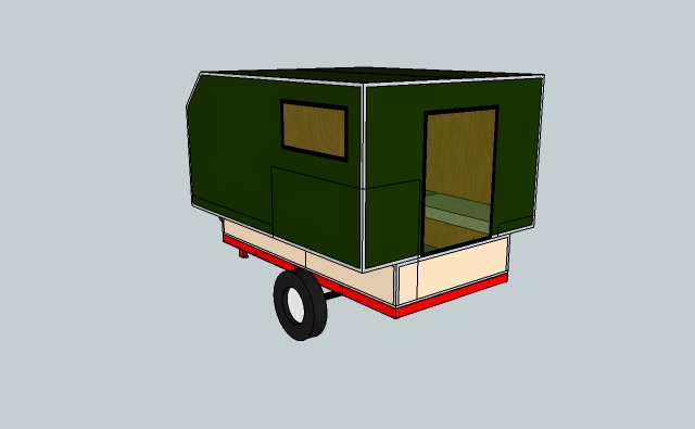

Postby TJinPgh » Wed Aug 08, 2012 3:58 pm
The only other thing I'm trying to decide is what to do about the door.
It makes the most sense to have it go all the way down to the floor. As has been said, it would certainly make getting in and out easier. Otherwise, a step will need to be implemented.
My question, though, is which way is more structurally sound. The way it's drawn or with the opening all the way down. Or, is there no difference?
-TJ
TJinPgh
Posts: 446
Images: 90
Joined: Fri Oct 28, 2011 1:50 pm
Postby wagondude » Wed Aug 08, 2012 8:23 pm
While the stepover at the bottom may be stronger, I am sure it it strength that isn't really needed. You have a decent amount of shear strength in the walls on each side of the door(provided you make each of those sides a solid piece all the way to the floor). If you make it too difficult to enter/exit, you are less likely to enjoy using it. Otherwise it is a really nice design and very functional.
Bill

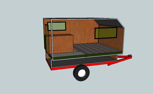

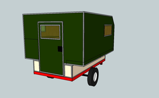

Postby TJinPgh » Thu Aug 09, 2012 12:00 am
Maybe a little more like this...
I'm still wondering if I'm going to need some kind of bracing under the over-hang in the rear.
I'm pretty sure that the bed platform will be more than sufficient to hold it up through the first half of it. And the cabinet structure should be fine to keep it in place on the left side. Just not quite sure about the right side in the back, where the seat is at.
I suspect that it will all depend on how it's tied into the rear wall.
-TJ
Postby linuxmanxxx » Mon Aug 13, 2012 8:23 pm
Sorry it took so long to get on here and answer as I've been doing this on my phone and hate doing a lengthy answer on it. On the trim it is around 3 bucks a running foot but is uv stable and easy to cut and lay out on the camper. If you go that route I've been using polyurethane pl premium but on a foamy I'd just say go with GG and enjoy the easier cleanup over the pl premium.
As a suggestion I'd say go out to 6 1/2 to 7' on the width of the upper portion to give lots of bed room/head room. I have an almost completed truck model I built with this kind of layout and is 8' long and only a 6" overhand and had to brace it due to sagging of the overhand in the middle. Of all the ones I've built, I'd say going wider is always more beneficial than going longer and you can do 6" front and rear and add a foot and not have to brace anything it works just fine to make a 9' cabin and stay with your existing trailer with no mods needed on the trailer itself.
