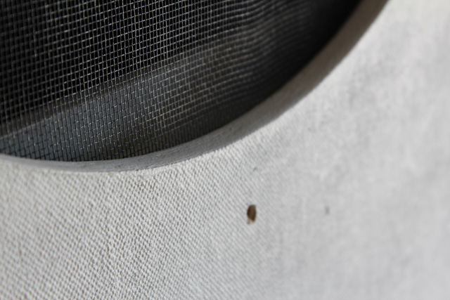

I tried a different approach. It was a bit of a risk but I thought it was worthwhile to try it. Time will tell if it holds up to the elements. As I glued the canvas on the outer wall, I covered the opening with the canvas, then painted on some thinned glue where I needed to cut, then I let it dry and I cut it with a very sharp blade. I cut as close to the edge of the opening as possible. I then used the titebond 2 wood glue to really glue down the edge of the canvas if it wasn't already stuck down. After it is painted it looks like this.
I did this for all window and door openings. I'll keep everyone posted on how it holds up.

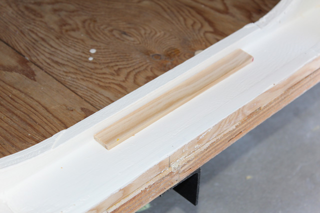

Also, I didn't do anything for a door threshold, and am thinking about cutting the bottom of the door, or at least shaving it.
I made my threshold part of my door frame. It is hard to see since it is all painted white. I placed a small piece of scrap wood where the door sits when closed so that the threshold shows up in the picture. I tried to leave enough room for a seal so that the door will smash it when closed. The threshold is just a little more than 1/2 inch tall and it goes all the way around the door frame.

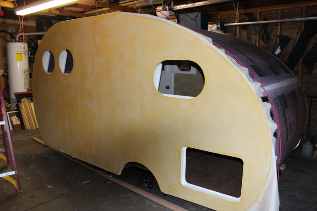

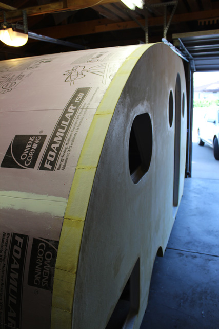

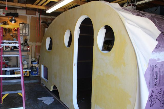

More progress... I managed to put the canvas on one side. It is much more challenging to canvas something that is vertical than something that is horizontal.

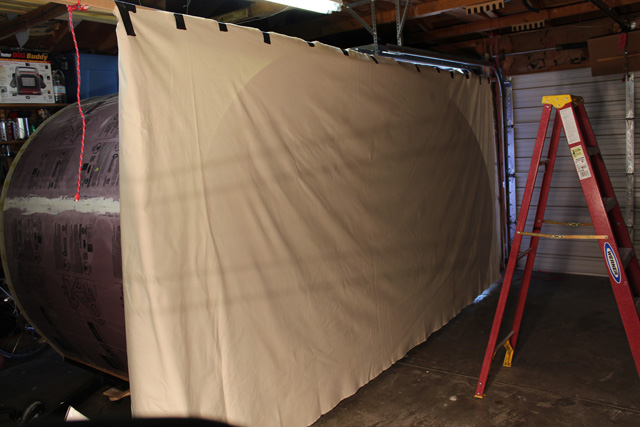

I rolled the canvas up on a long board and then suspended it from the rafters of the garage so that it hung next to the trailer wall. Then I would roll a section of glue, press the canvas on and move down the wall to repeat the process. NEXT time, I think I am not going to let it hang like a sheet. I think that will make things much easier. I'll let you know which one I prefer.
Here is a picture of all the canvas trimmed. It took and entire day to do all the cuts so that the canvas would wrap nicely around the edge. I'll fill in the gap with putty and sand it all smooth before I apply the canvas on the roof. I did this when I wrapped the door and the seams are invisible. I hope I can do the same with these seams.

NMMarauder wrote:...suspended it from the rafters of the garage so that it hung next to the trailer wall.
I was thinking that I would pin the top of the side wall canvas to the roof using bamboo skewers, then flop it all on the roof before working down from the top, but if that doesn't work on my smaller trailer I am definitely stealing this idea. Perhaps screw eyes into the ceiling joists in the loft then cords in a curtain like arrangement to deploy the roll of fabric incrementally.

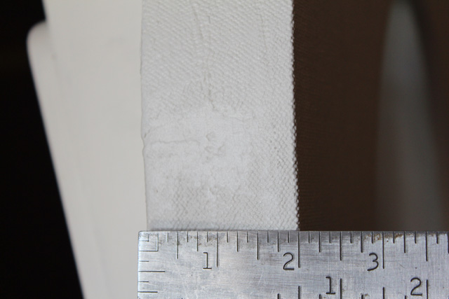

Which filler did you use to fair the canvas seams? - KCStudly
I've been using Durham's Rock Hard Putty. I like that I can mix small amounts and so far it has stuck very well to canvas and wood. Here is a picture of one of the door seams after putty, sanding and paint. I tried to get a light that would make the seam stand out. In normal daylight and unless you were really looking for it, it is practically invisible. See it above the ruler?

I hung the canvas instead of rolling it up on the beam and it was much easier to work with. I must have taken this picture before I worked with it a little more to get some of the wrinkles out before I started gluing it on the side. Basically I adjusted it so that it hung with less wrinkles and was even flatter. But it wasn't a huge improvement. I might have gotten 50% more of the wrinkles out. You can work out many of the wrinkles as you smooth it towards the edges when you start gluing. There was much less tugging and pulling and smoothing of wrinkles with this method. This is the method I recommend to anyone that is covering with canvas. I'm sure I have seen it done with other posts.
Here is what it looks like after I started cutting out the openings and trimming the edges so that they wrap onto the roof. After it is stuck on and while it is still wet, I like to thin out the glue to a 50/50 mixture and roll it on top and then use a putty knife to really squish the glue through the fabric. It may be totally unnecessary but I just want to make sure the canvas has a solid bond with the foam underneath. That's why the canvas has the color of the titebond 2 wood glue.
