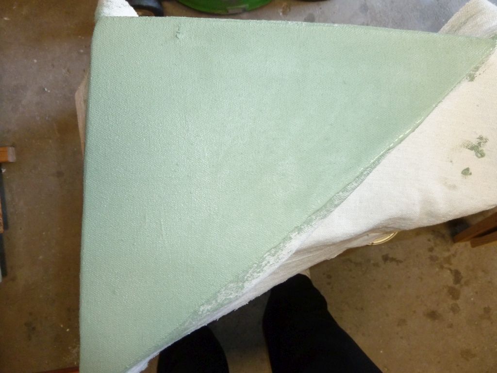

Started the test with latex paint ---- pic below
scuffed foam w/sandpaper, paint, then canvas, then squeegeed
paint-foam test.jpg (126.11 KiB) Viewed 1671 times

Thanks for the suggestion. If all paint worked like PVA latex and all paint was PVA latex, that would be worth looking into but different paints use different methods of binding. I will stick to paint cans with an accurate label so anybody can figure out what's in it. If the above test proves latex is worth using without reservation, 5 bux a can is not a big deal.
I can tell you right now that when I lifted an edge on the paint test earlier (it was dry to the touch), it came up easily leaving paint behind rather than ripping foam free, but it may not have been completely dry. I will also be doing a hammer impact test as well as the peel test. The painted side seemed flimsy when I poked it compared to the glue panel but same deal, will give it a chance to dry completely. After that preview, I did the other side of the panel with TBII to compare more destructively.

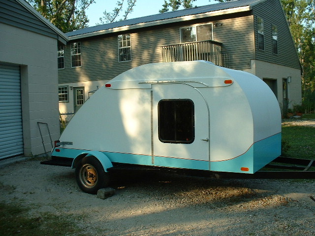

Fred, it’s the same old story ... the right stuff for the job!!! As a career Artist and painter, I've painted on and with most everything (types of paint and surfaces) over these many years , and it always comes down to proper surface prep , good application , and following the standard procedures. ( actually written on the can !!! ) , and most important , using the right type of paint ... (compatibility)
As a test smear some paint thickly on a piece of paper , then some T2 in the same thickness... Let dry thoroughly ... The T2 will dry more Brittle (and will crack with more thickness) whereas the paint forms a more flexible film ... This is where the better paints excel ,as their films stay flexible longer than the cheaper paints whose films become brittle sooner ... and then crack . We’ve had Latex outdoor murals/signage exposed to the southern Sun for as long as 10 years , good paint , but eventually it got chalky and dull...but didn’t crack and soak the substrate . :thumbsup:
Td in white.jpg (153.11 KiB) Viewed 1620 times

GPW, never saw that one before & it looks real nice ! How many teardrops do you have lurking around ? :dancing
