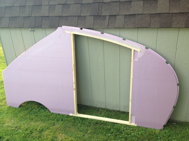

I worked on the first wall a little bit today... Can you guess where the spars go? :R

Postby Fred Trout » Thu Jul 02, 2015 7:27 pm
Nice router work - mine had edges that looked like a jigsaw puzzle :lol:
What did you use for glue wood to foam ?

Postby mikeschn » Fri Jul 03, 2015 7:06 pm
Hi Fred,
It's a quiet weekend here, albeit busy, with the traditional 4th of July stuff, so there won't be any teardrop construction this weekend.
But to answer your question, I used GG.
As for the foamie routing, it's pretty easy actually. CNC makes quick work of it. I've never cut foam before, and I was concerned that it would bead and break off large chunks at a time. But that wasn't the issue at all. Instead the bigger issue was the deflection of the EPS due to the lack of structure prior to gluing in the lower threshold of the door. And to this moment I don't know if the door is square, er I mean rectangular, or trapezoidal, or parallelgramish.. you get the idea.

Postby Fred Trout » Fri Jul 03, 2015 9:01 pm
Thanks ! Trapezoidal, or parallelgramish seem to be my favorite end results :cry: If I end up with something actually square and true, it was certainly accidental :D Which is why Great Stuff is my fav since it fixes all. Must be nice to have access to a CNC. I used to program one back in 79-82 - it read punch-tape :D
I suppose you could mount the foam onto some rigid substrate like coroplast or OSB with temporary nylon dry-wall-screws. I really like em for mounting light stuff on foam, preventing walls from moving during glue-up, etc.
