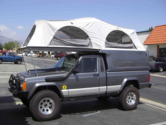

Sharing the load over the front of the truck is something I certainly considered. I like your clip on roof rack idea. Cauitious is always good!! If you were PARKED it would make a whole lot of sense to deploy some external supports like the flip pac camper

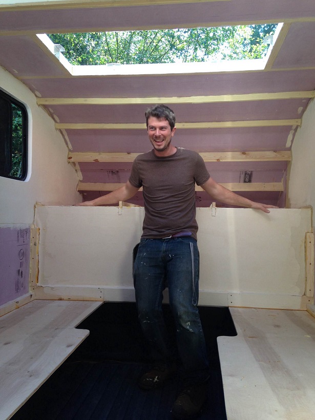

Kudzu - Right now I'm 90% focused on the interior. It was bare yesterday when we mounted it (better for lifting) and now I've got the bed insert built and a counter top on one side. Hopefully today I'll finish the second counter, get some more canvas (bed sheets) on the roof, and a layer of paint in there!

Here's another great option.
http://www.campingworld.com/shopping/item/56-x-22-wind-deflector-black/34579
The foil is strapped down to the rain gutters and supported with suction cups. Beautiful solution. I think I could DIY it for a little bit less than $350...

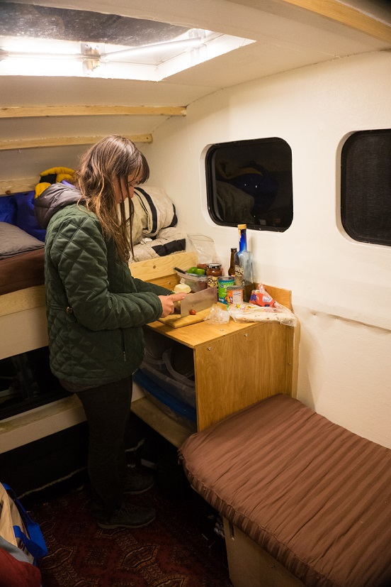

I've put 1,000+ miles on the camper and spent about 40 nights in the back. Time for an update!
Overall I LOVE IT and I am grateful everyday I invested the time, energy and money to build it.
I'm very happy with the way the truck handles. I can easily get 23 mpg driving on the freeway or country roads at 60 mph Or the speed limit. I've been keeping track via my obd2 port and an app on my phone so I trust that number. I haven't been keeping track for the limited around town driving I've done. The biggest handing issue is swaying side to side. So far it doesn't bother me enough to add a lead spring or air bags, and I'm not sure how much they would help. I've driven on hours and hours of unmaintained dirt/Rock roads with no problem.
The size is perfect for me. I have two small countertops and a twin/doubleish sized
Bed. I haven't been cooking in the truck be cause bears have been a constant presence :roll: I have a tiny propane heater I run for 15 minutes on cold mornings and nights with the windows open. It gets to 65 degrees in a hurry.
It's been through a few snowy nights and lots of rain. Unless it's a torrential downpour I leave the windows cracked with no problem.
When I get to a computer I'll post some photos!

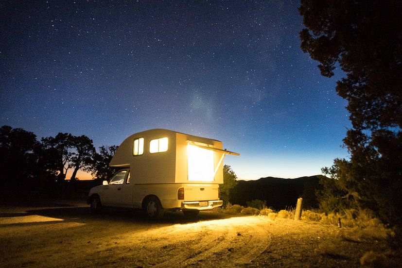

Don't forget to get outside and enjoy your toys! :beer:
Catching the very last of the sunset over the Rio Grande in northern NM
