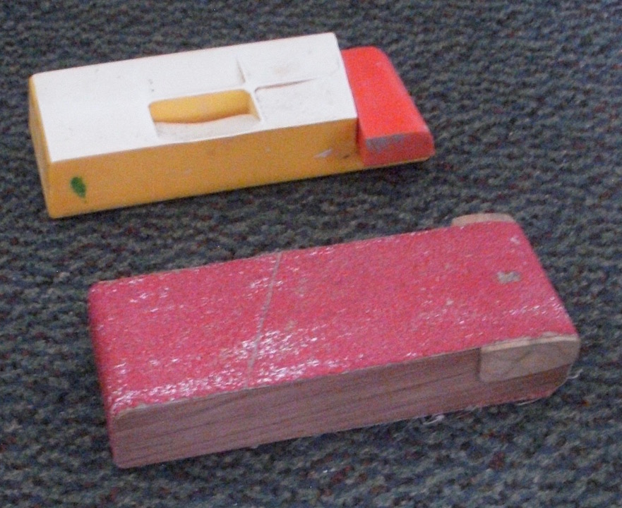

Good advice , Here’s one we made from a block of teak to replace the 18 Year old plastic one that broke … Can’t do without it , agressive grits cut Foam FAST !!! :D
