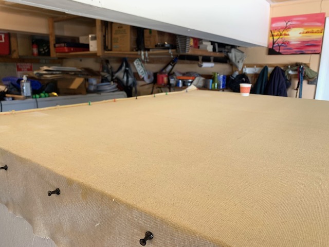

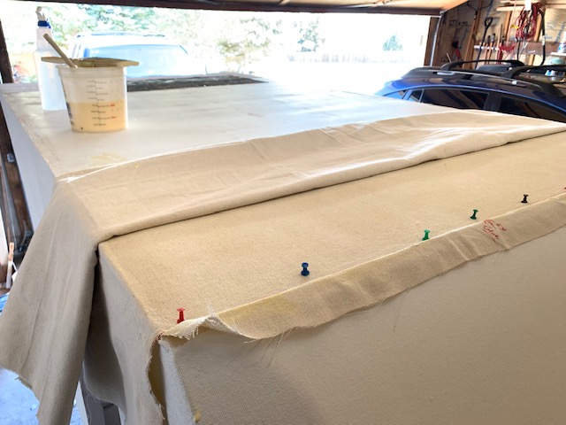

Yeah! Starting the last big panel to canvass....the roof:
It's on!
And it is looking good:
I am really excited about getting the roof done, Gets me a LOT closer to getting this puppy on it's trailer.

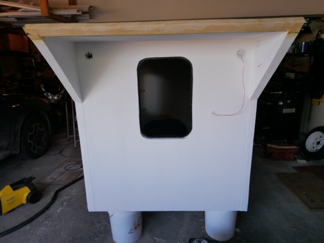

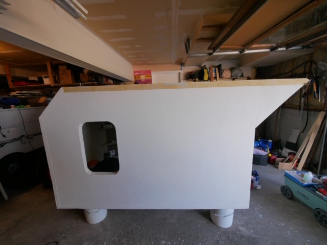

Postby JazzVinyl » Mon Apr 06, 2020 6:18 pm

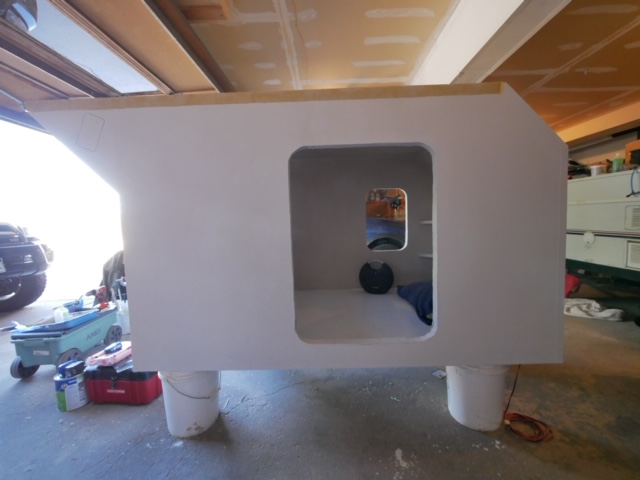

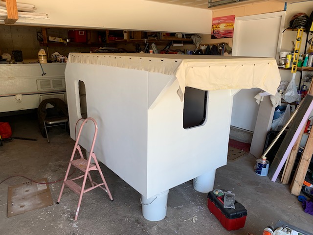

More progress today, Cut and glued down the roof canvas:
The back:
Roof itself, did good!
Drivers side, profile:
Passenger side profile:

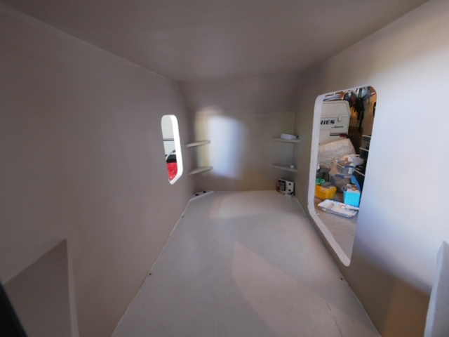

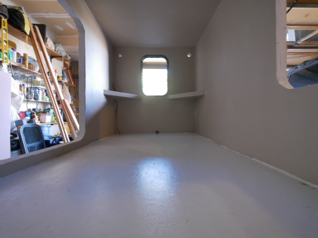

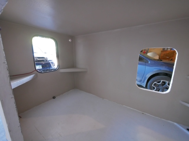

I installed the rear triangle shelves, caulked and painted them, this, from at the door entrance:
Inside, from rear window:
Inside, from laying down position:
Now just need to:
1> Prime the roof/edges.
2> Coat the bottom.
3> Install drip edges...
4> Outside latex paint...
5> Install windows/doors...
Then, were ready for Trailer mounting !!!

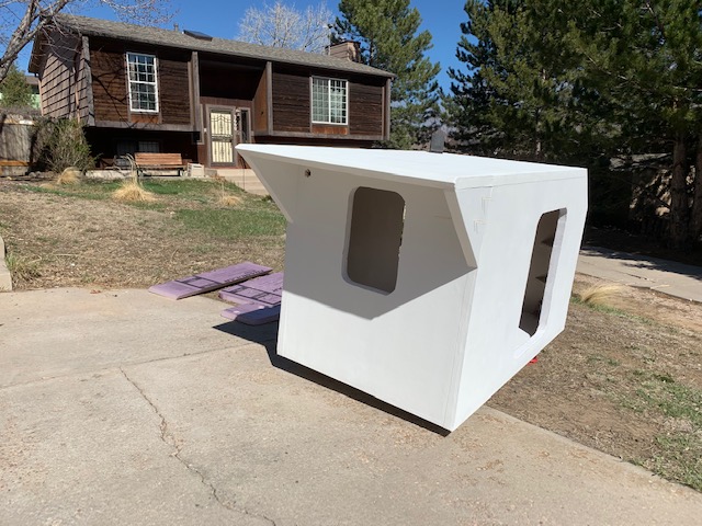

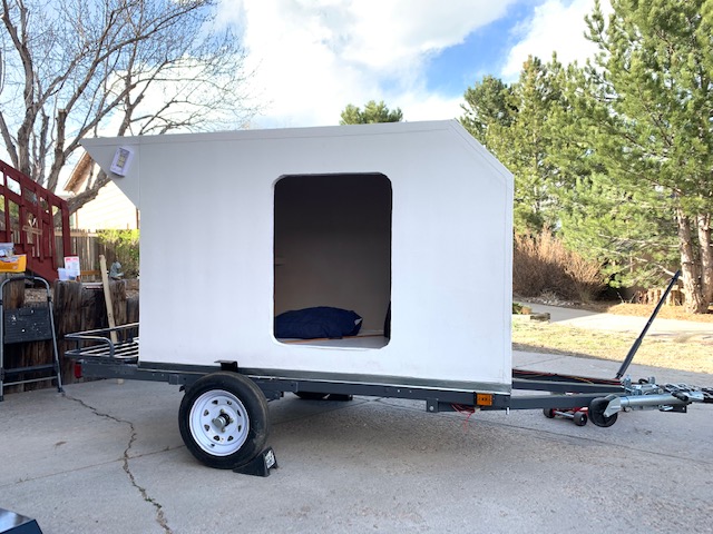

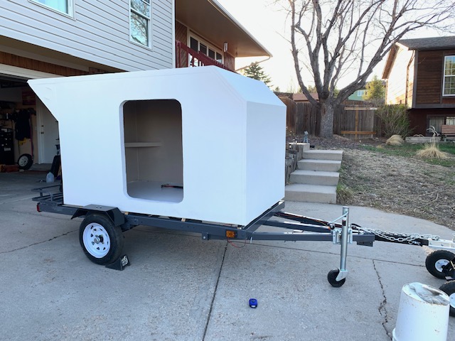

Postby JazzVinyl » Tue Apr 07, 2020 8:21 pm

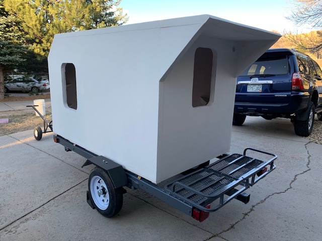

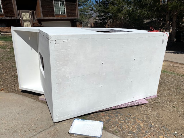

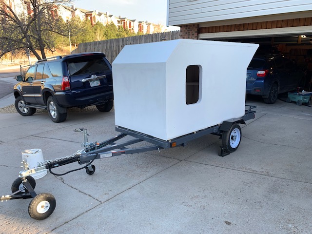

I finished the primer coat and managed to get it outside via a dolly:
And roll it over in it's side for the "Henry's Elastomeric" coatings...
Then, a friend in the neighborhood helped me lift it on the trailer:
Rear view:
And driver side, on trailer:
This was a BIG STEP forward!!
Now to figure out that drip edge!!

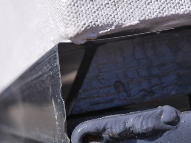

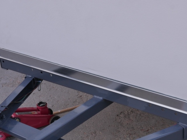

Postby JazzVinyl » Wed Apr 08, 2020 7:18 pm

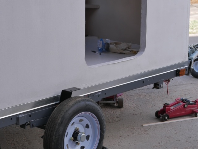

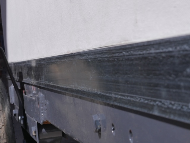

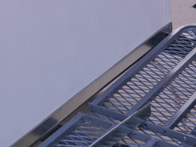

Did my drip edges today. Went for the kind you see on the sides of your house, as my spacers were thick enough and since my trailer is welded, bolt heads protruding, was not an issue:
Side:
Front:
Other Side:
Rear:
This is how they are in there...slid between trailer and spacer board, then trailer tightened down...
I will run a small bead of caulk...but seems pretty tight as is...
Hope this was not a "bad idea"...

Postby ghcoe » Wed Apr 08, 2020 9:07 pm
Looks good. Yes caulk is good. Water gets into everything. Don't want a moisture trap. I do water crossings so I need to make sure my drip edge is sealed inside and outside.
