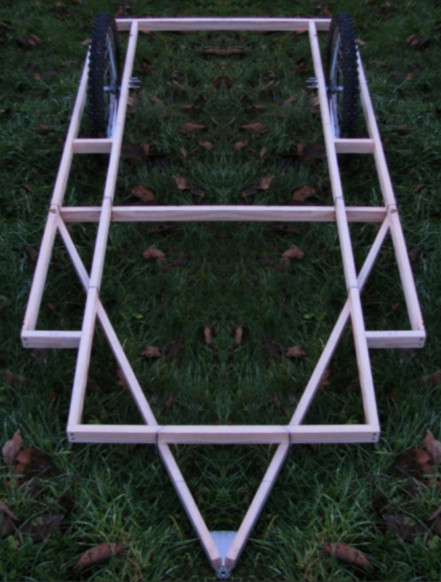

Found this image from a lightweight bike trailer Paul Elkins built.
This might distribute the forces better than a single board to the axle :thinking:
Good health still and this weekend was the first weekend that the heater was setup and working in the shop.
No progress with the trailer at all this year. Been bogged down with a ton of other projects this year. I hope to hit it hard sometime this winter, now that I got heat :thumbsup: .
I had ran into that frame when doing the initial research on building a bicycle trailer. I am planning on doing a real light frame. Mostly just to spread the towing, hitch and axle forces into the body better. The body on a foamie is basically a uni-body so I don't think much framework is needed.
Thanks for sharing though. It really is a nicely built frame.

Looking forward to seeing how you do the framing. In ruminating about how to build my bike trailer i thought of routing in the framing. Maybe the triangle could be straight from the axle to the hitch, that way only 3 boards would be needed :thinking: Maybe even drilling lots of holes in them to lighten them further :thinking:

My plan is basically a T design. I am going to try to use 3/4" conduit bent in a S. My hitch is designed to attach under the seat. The tongue will attach there made a S shape over the bicycles rear tire and then run under the trailer to the axle. The tongue will attach to the axle with sheet metal that will be wrapped around the axle and bolted/ pop riveted to the tongue top and bottom. At some point between the front of the body and the axle I am going to run some all thread through the tongue that will run to the edges of the trailer side to side. This will help keep the tongue from twisting excessively while in motion and will add some extra support. At this point I will probably make a kick stand to deploy when in use.
Hope that makes sense.
