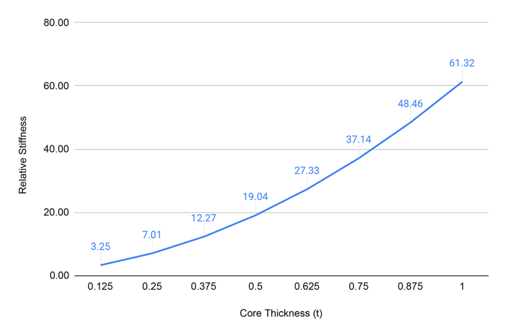

I tend to agree, https://explorecomposites.com/articles/ ... tructures/
Doubling thickness more than doubles the "Relative stiffness" and the stiffness gain seems to be even more advantageous past 1 inch (2.54cm)
I have 4,5 and 8 cm xps foam available to me in theory combinations could be glued (4+5 yielding 9cm)

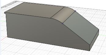

Postby twisted lines » Tue Jan 24, 2023 12:36 pm
jakejakejake wrote:This makes me think of a snowmobile trailer! Im not sure if you are familiar, but this picture may spark some new ideas. Door building takes significantly longer than I had anticipated.171279
And I spent days attempting the shape I am looking for; with a new program windows 7 won"t do :NC
With Hours trying the next Radi And multiple times.
day 2.JPG (16.49 KiB) Viewed 1384 times
Racking up; And Rapin foam
twisted lines
Posts: 1243
Location: Jefferson
Re: XPS and Epoxy
Postby jakejakejake » Tue Jan 24, 2023 12:48 pm
twisted lines wrote:And I spent days attempting the shape I am looking for; with a new program windows 7 won"t do :NC
I couldn't live without traditional 2d autocad. I have partially learned ac3d and solid works many times and it will never be as intuitive as good ole 2d. Ive gotten really good at visualizing a 3d product from a 2d or isometric drawing. :lol:

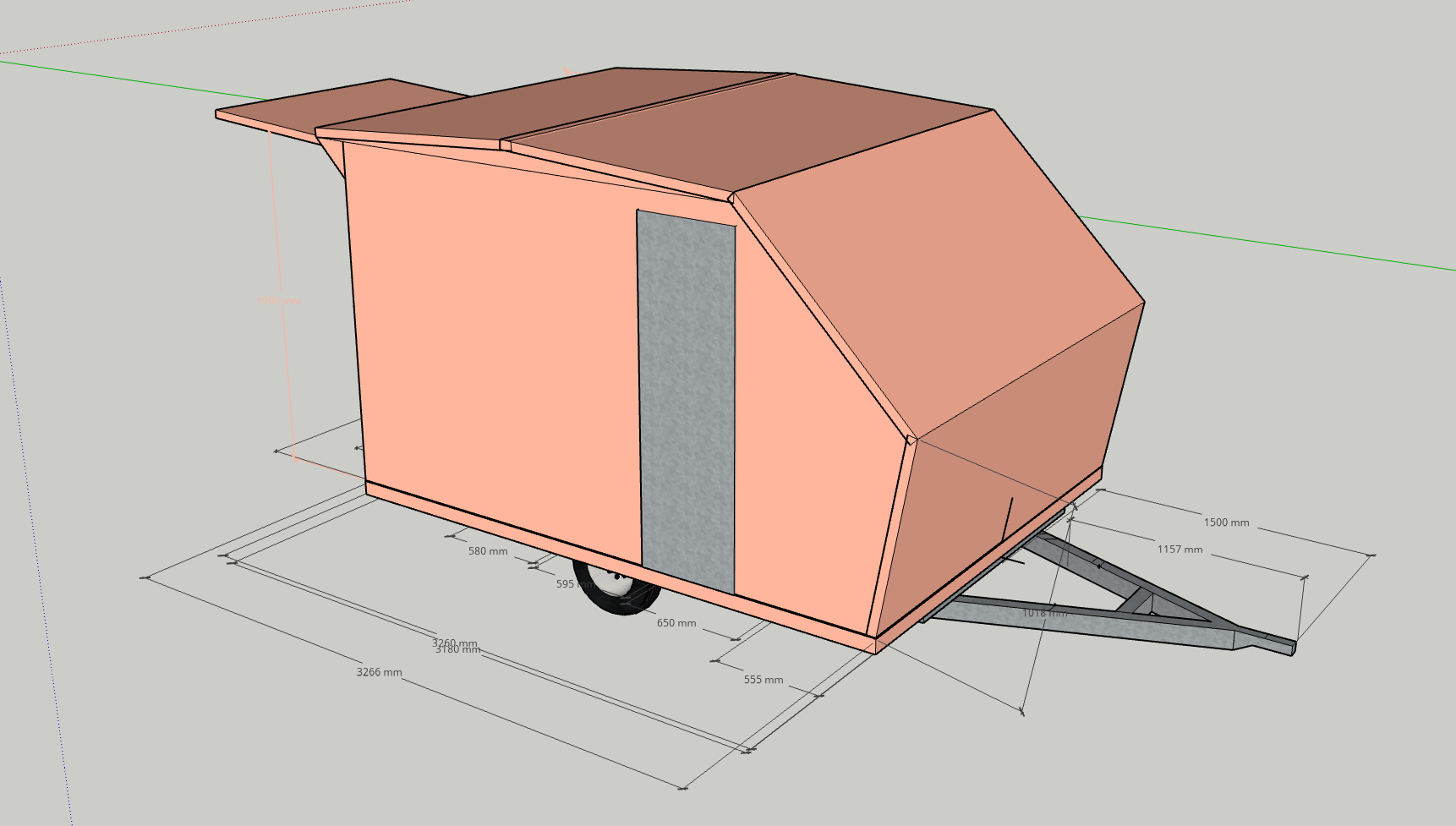

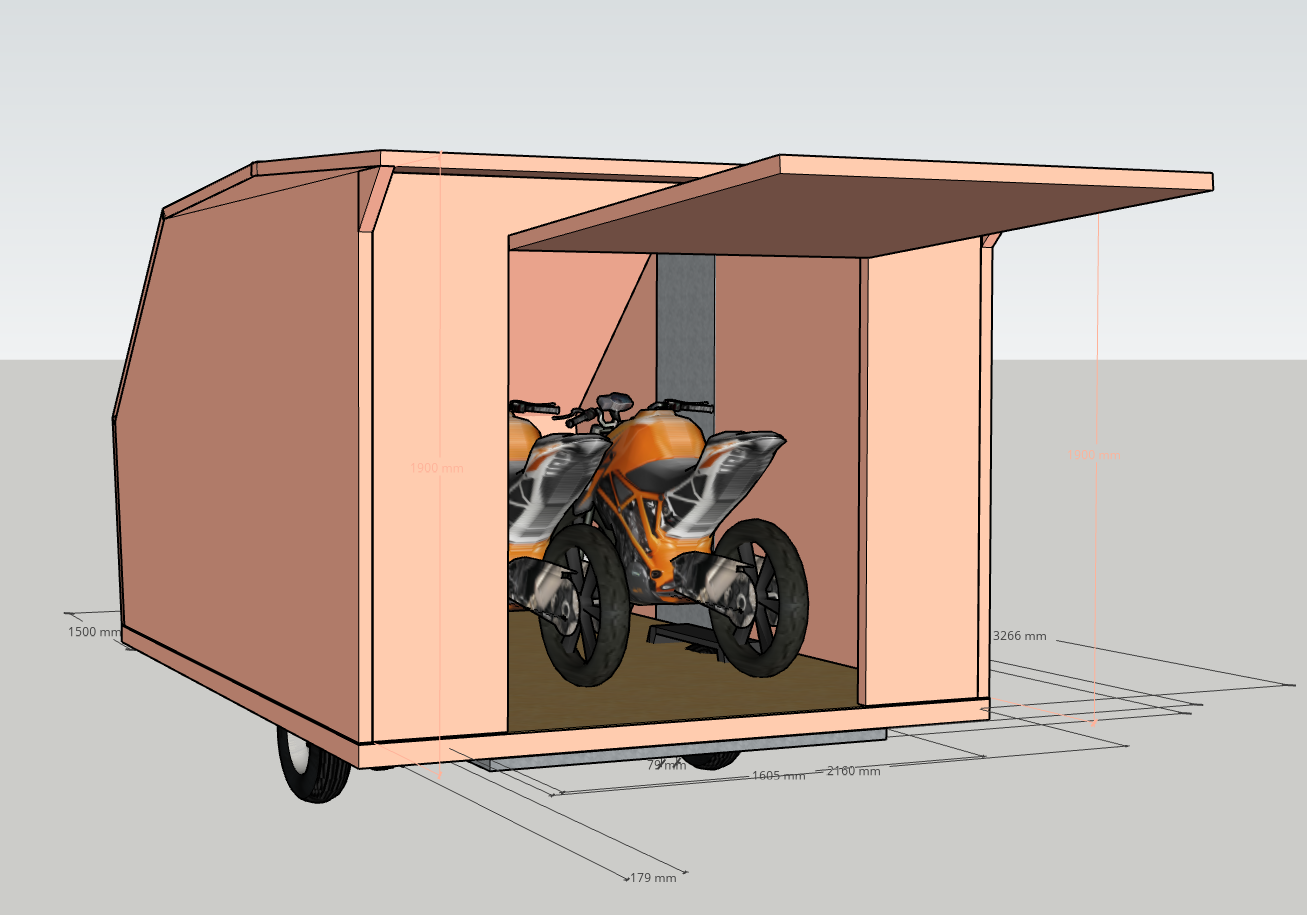

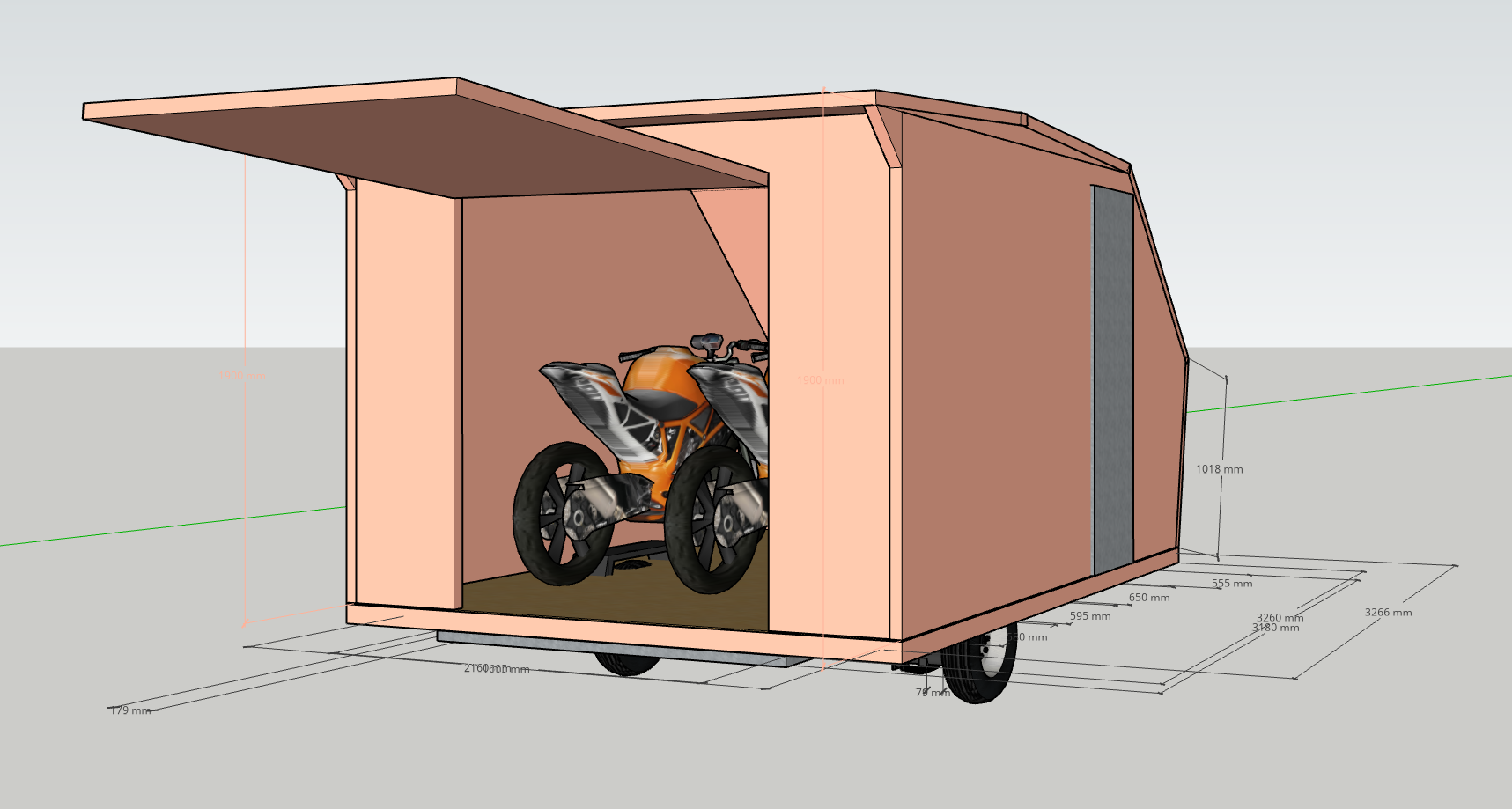

Postby fonsan » Tue Jan 24, 2023 3:55 pm
Sketching has begun
Screenshot 2023-01-24 at 21.50.22.png (240.23 KiB) Viewed 1340 times
Screenshot 2023-01-24 at 21.50.52.png (277.74 KiB) Viewed 1340 times
Screenshot 2023-01-24 at 21.51.01.png (215.21 KiB) Viewed 1340 times
fonsan
Posts: 18
Joined: Sun Jan 22, 2023 6:38 pm
Re: XPS and Epoxy
Postby jakejakejake » Tue Jan 24, 2023 4:27 pm
Nice! The end wall looks plenty strong to resist racking as mentioned in a previous post.
jakejakejake
Posts: 62
Images: 24
Joined: Sat Jul 02, 2022 4:44 pm
Location: Texas
Re: XPS and Epoxy
Postby tony.latham » Tue Jan 24, 2023 5:19 pm
Is the axle in the middle of the chassis frame? It looks like it needs to be moved a bit aft?
