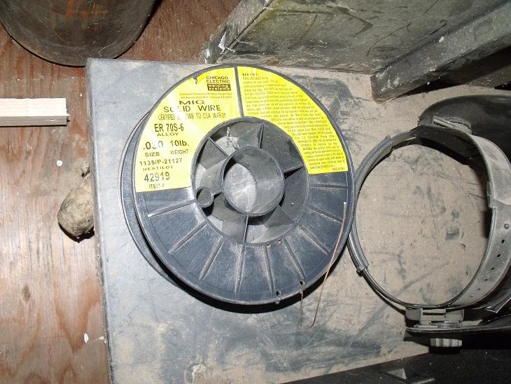

pchast wrote:What I have a spool of is 30 thousandths, .030. I stopped at the local body shop and got 10 ft of .035 but found that no better. I am using 3 ft lengths and it bends before it cuts. I have a 10/2 amp charger on 2a and the start setting. In the charge setting it keeps cycling, clicking and getting cold. :thinking:
I have read where some chargers will do that, but it should still get the wire hot. I am thinking that if you are using .035 it is too thin and would heat up pretty quick. This would probably make the charger cycle on and off and also make the wire too hot. I am using .30 wire. You just want to get the wire hot enough to cut and not red hot. If the wire gets too hot it will bend easy and break or melt. My charger is old school so it is possible that newer chargers may not work.
George.

ghcoe wrote: I am using .30 wire. You just want to get the wire hot enough to cut and not red hot. If the wire gets too hot it will bend easy and break or melt. My charger is old school so it is possible that newer chargers may not work.
3/10ths of an inch wire? .035 is 35 thousands. so .30 would be 300 thousandths = more than 1/4 inch. Just what is this .30 you speak of?

ghcoe wrote:
pchast wrote:George,
In the photo your jig looks like you used a heavy wire. Can you tell me what it is?
When I try to do the same with .035 welding wire in 1.5" blue foam it
bends before making 'cuts'. Even with 'no' pressure...
Thanks,
Pete
Are you using .035 or .35? I am using .30 welding wire. I am using a car battery charger set on 2 amp charge for the power supply. I found 3 feet of wire to be a good length to keep the heat right. Check out my hot wire thread for more info. viewtopic.php?f=55&t=55323
they dont' make .30 welding WIRE,
maybe rod for arc welding,
.30 = 3/10 inch, with is almost 3/8 thick
.030 and .035 are common sizes or welding w1re for a MIG or wire feed arc welder.
.03125 = 1/32

Postby ghcoe » Fri May 24, 2013 4:32 pm
Yup looks like all these numbers have now got me confused...... :shock:
.030 here is the picture to unconfuse us all.... :thumbsup:
DSCF1782 small.jpg (115 KiB) Viewed 1293 times

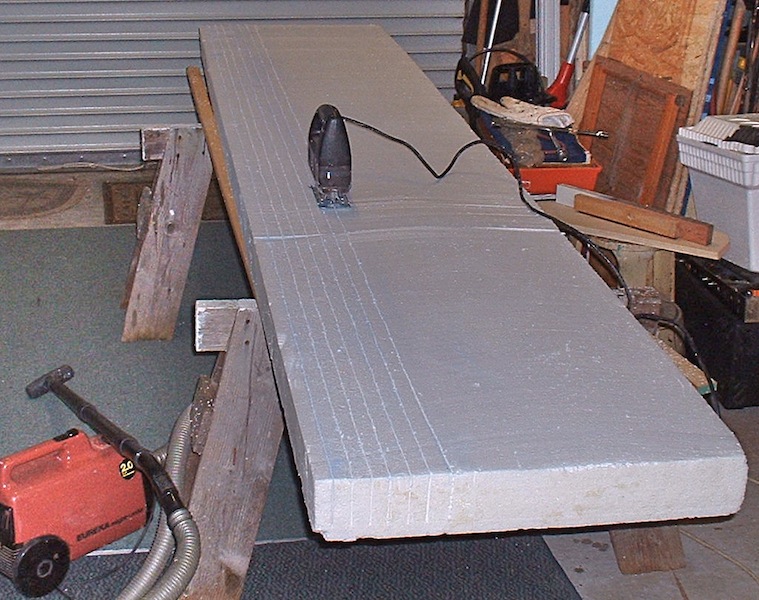

I guess it’s back to the old router idea ... :frightened: Could get Messy ... :o Problem still , we have to make the kerf cuts 2.5” deep X 10’ long ... :thinking:
Re: FoamStream...
Postby GPW » Sat May 25, 2013 8:47 am
Measured the circular saw blade .... that’s a 2 1/2” cut depth ... Not very wide , would have to make a lot of cuts ... :frightened:
Re: FoamStream...
Postby GPW » Sat May 25, 2013 9:35 am
Test #1 ... The Jigsaw .... This actually worked pretty good ... easy to do , cuts like butter ... Only downside is since the blade is so narrow , you need More cuts to make up the area you need to remove... These cuts were 1” apart , and the material now bends just enough to make the transition ... The really nice thing is the little multiple cuts become unnoticeable when the panel is bent ... easier to finish off the inside , later ... 8) And yes , once kerfed , the foam bends easily ... :thumbsup:
In the picture , you’ll notice the prominence of the vacuum cleaner .... This was messy , but I can’t imagine Near as messy as a circular saw or router... :frightened: :NC :o The pic is After the vacuum was used .... once I made the cuts , quickly realized that if this wasn’t swept up immediately , it would be Everywhere in short order...in the Studio :R
