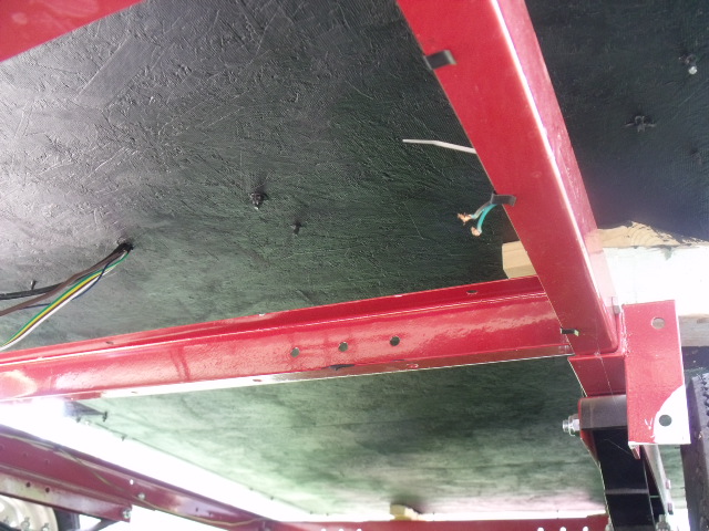

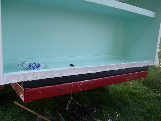

This weekend was the weekend I have been dreading since I realized I forgot to do one thing. I forgot to coat the underside of the floor with the black stuff. I read horror stories of other people applying the black sticky stuff to the undersides of their trailers. It had to be done as much as I tried to talk myself out of it, this weekend was the weekend of horror........ :worship:
Well it really did not turn out as bad as I thought it was going to be. In fact I never got any sticky stuff on me or my cloths...... :R The worst part was my arm got tired from painting upside down.

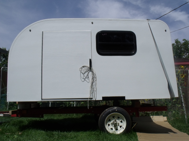

I wanted to raise the body up a bit to add some extra clearance at the wheel wells. I just though the wheel was a bit too close to the well and could smack on a large bump if the trailer was weight down some. So a easy fix was to add 2"x2"s to give me a bit more clearance. To be able to get to all of the floor to paint I had to lift the body off the frame so this was a perfect time for adding the lift too. I lifted the body about 6" above the frame which made it easy to paint and add the 2"x2"s. Still not totally done, but the body is back down on the frame for storage until next weekend. See you then...... :thumbsup:
Lifted
Sticky stuff....
George.

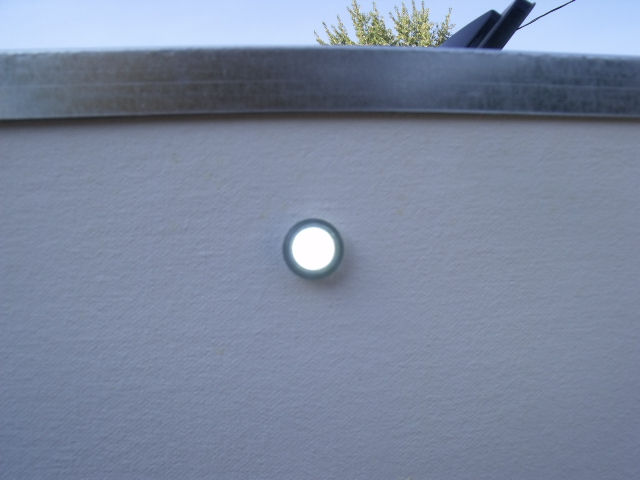

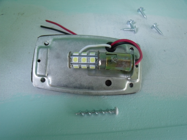

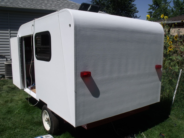

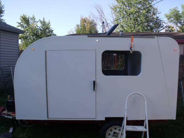

I also got the new tail lights installed. I still wanted to run LED's so I replaced the filament bulb with some LED lights I had laying around from another project. I found some screws that looked like they would work real well for foamies. They have a larger surface area and a longer pitch than other screws (bottom of :pictures: ). I figured that they may work well in softer materials. :twisted:
Tail light
I think they are actually for sheet metal, but worked real well in fastening the lights to the foam.
Installed

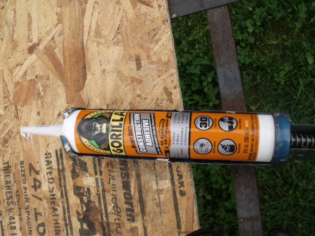

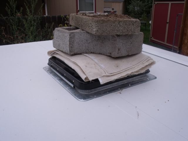

Wow nearly a month since a update. Well not that much happened till this weekend anyway. A few weeks back I did get the vent installed. Could not find the recommended adhesive so I decided to try some Gorilla Glue adhesive I found in calk gun form. Seemed to work pretty good with a test piece I tried it on so thought I would go ahead and give it a try.
Gorilla
Vent

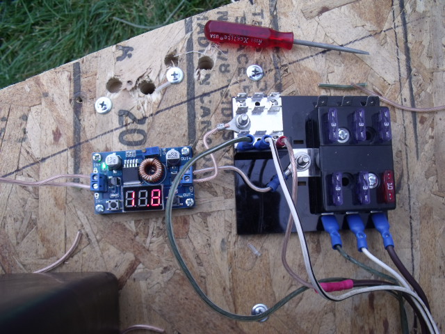

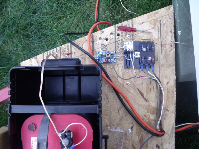

I was going to work on the ceiling canvas Saturday, but realized that I needed to apply Gripper to the walls and ceiling first :roll: . So I applied a coat of Gripper after wiping everything down with alcohol. Since I needed to wait for the paint to dry I worked on the electrical some. I got the fuse box, voltage regulator and battery box installed and working.
Electrical

Postby ghcoe » Sun Oct 02, 2016 3:59 pm
A few more pictures of the electrics and lights.

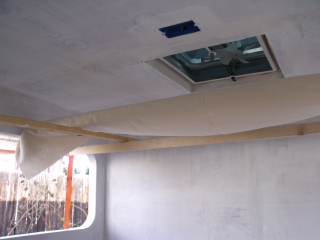

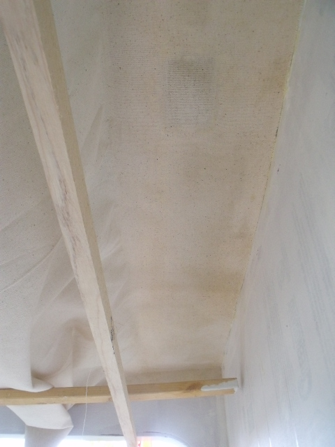

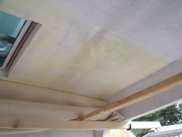

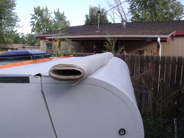

Sunday I started on the ceiling canvasing. Been thinking how to do this one for some time now.
I rolled up the canvas onto a board. I then rigged up some wood to support the rolled up canvas about 8"-10" below the ceiling.
canvas
Canvas rolled up
Supported
George.
ghcoe
Posts: 1982
Location: SW Idaho
Re: #1
Postby ghcoe » Sun Oct 02, 2016 4:50 pm

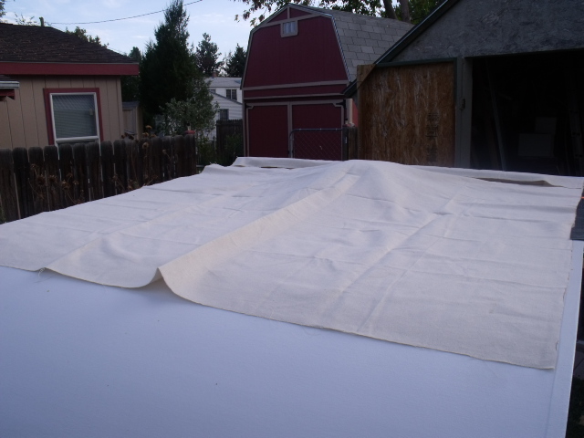

At first I used full strength TBII. My thinking is that it would stick better to the canvas and hold. After the first lay up I thinned it down just enough for the brush to feel like it was gliding across the surface. The full strength glue was just too hard to get to spread. It also seemed to stick better to the canvas. I think that the thinned TBII was able to flow into the canvas better than the full strength. When I started the canvas did not want to stick well and kept falling down. I let the glue dry just a bit and tried again. It started to stick. Not well, but progress :thumbsup: . I wetted the canvas with the spray bottle in a attempt to get it to stick better and pull the glue into the fibers. Not dripping wet, but well wetted. It stuck. :worship:
Gluing

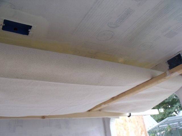

Once the canvas appeared to be sticking good I pushed the rolled canvas under the stuck canvas so I had access the ceiling again. At this point is where I decided to thin the TBII some. Also, I decided not to try and glue all the way to the wall and leave a 2" section unglued. Just too hard to work in this area. This went better than the first section. I was able to unroll the canvas and position under the area I just glued. Then I would pull out the canvas in the center with my hand and then roll out from center to the edges with my roller.
Canvas out of the way
Moved into place for gluing

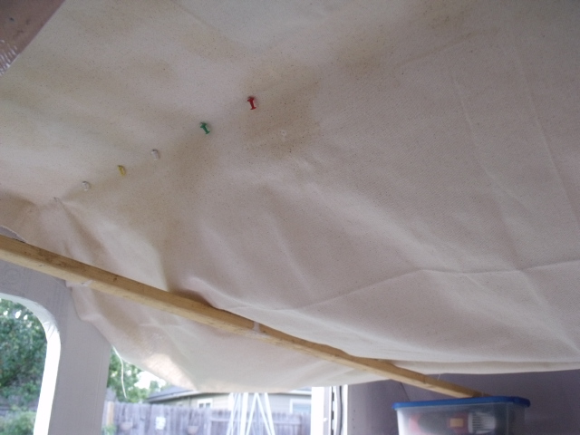

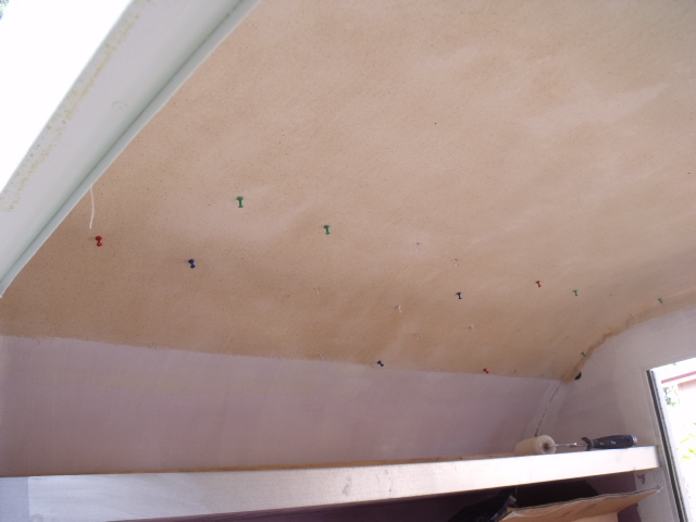

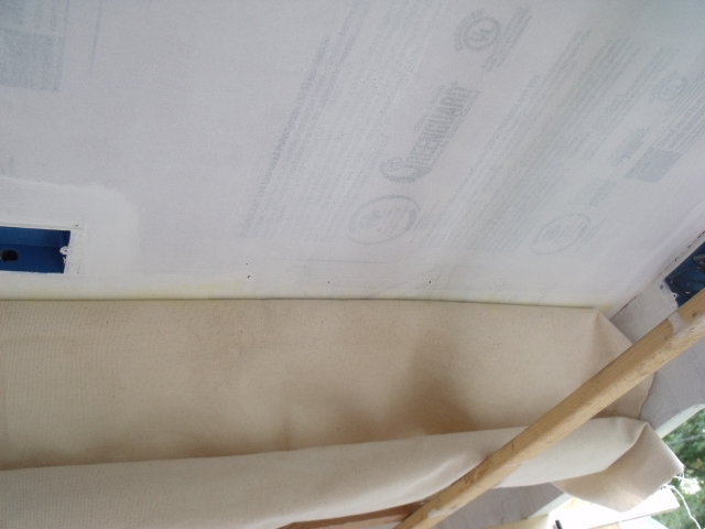

I still had some issues to address. The first piece was starting to pull away from the edges some. Rolled them back out and though I need something to hold the edges down. Luckily I had some push pins handy and a method was born...... :thinking:
George.
ghcoe
Posts: 1982
Location: SW Idaho
Re: #1
Postby ghcoe » Sun Oct 02, 2016 5:04 pm
The push pins worked great. I would use them along the edges in the non-glued area. I then was able to roll out the canvas to the glue line and put a pin in and repeat. This allowed the canvas to drape better and not pull down when I adjusted the roll.
Push pins
Canvas draped
After this the problem I had was with the curve. This would be the place to preshrink the canvas. As it dries and shrinks it tends to pull away from the ceiling. I kept rolling it about every 5 minutes until I felt it was dried enough. Still had a little bit of canvas that pulled away. I will have to wait to fix that on another day though.
Curve
I think if I would have continued to roll the canvas down for a few more times it would have been ok. :NC .
