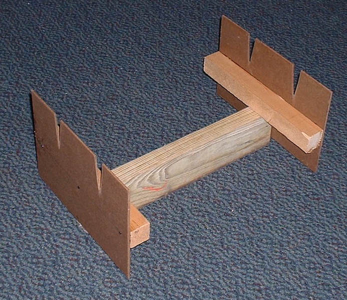

“Bagged" the idea of 10’ long kerfs :roll: Went ahead and made a pair of cutting templates out of thin Masonite to cut the 24” kerfs with the bow .. Which will be mounted to a 24” + board as a jig to slide the sheets through for the kerfing ... MUCH Easier to do , and I’ll have the 1/2’WX 2.5” deep kerfs we originally planned on.. !!! Spaced @ 3” apart .. :thumbsup: It won’t bend as pretty as the smaller kerf cuts , but at this point don’t care ...It will all get nicely sanded and rounded anyway and covered with the “wallpaper” on the inside , so no worries ... :thinking:

Here’s a pic of the kerf jig layout ... simple ... :thumbsup: The spacing of the two grooves shown is 5” , but using a single V , we can cut to any spacing we want , by just sliding the foam back and forth ... I’m thinking the closer the kerfs , the smoother more rounded the outer surface ... :thinking: More testing .. ;)

Well, here’s a development ... :o Cut a test panel with the 24” kerfs and the hot wire bow (which worked perfectly) Easy to do using the jig ... difficult for one person to use , my alignments were a little off trying to catch both sides at once... But it worked and I was able to kerf the whole panel pretty quickly ... But just handling the beadboard and it snapped at a kerf ... in two places :shock: ... :thumbdown: So , back to the old method with the saw and tiny kerfs ... which seemed to bend much better being closer together ... and no breaking ... :oops: I don’t believe this is as likely to happen with the extruded foam (blu or Pink) :NC
Here’s something I learned .... when doing hot wire cutting , allow an entry area on the jig Before it hits the foam ,for the wire to align before the cut is made .... much neater that way ... learned that the hard way ... :frightened: (see Pic)

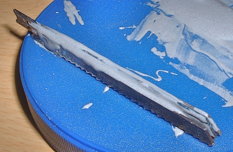

In shear desperation , I glued 3 jigsaw blades together ... Two shorter ones on to one long one ... Sanded the mating surfaces thoroughly and wiped clean with Acetone... Glued with JB weld ... so we’ll see how strong that stuff really is ... has to dry /cure overnight , so no testing till tomorrow ... This should give me ~ 3/16 “ width kerf , which should be OK ... no rasping .... Cuts will be 1” apart ... Lets see now ... that’s about 96 cuts for the four remaining panels , @ 10’ long each or a total cutting distance of 960’ ... :o :shock: :frightened:

GPW wrote:In shear desperation , I glued 3 jigsaw blades together ...
GPW,
Now that's thinking outside the box....It ain't pretty, but should work. Not a lot of load or heat involved. :thumbsup: :thumbsup:

JB Weld is strong stuff. I once used it to fill in a gouge in the top of a block of a big diesel motor that the exhaust gas had cut between 2 cylinders. It was still holding 2 years later when the truck was sold off.
