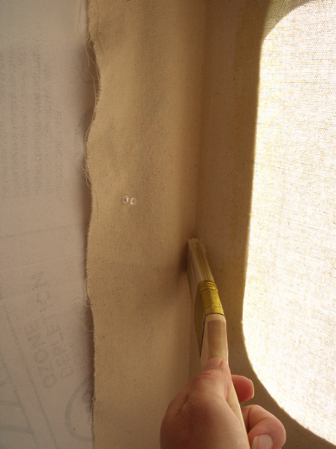

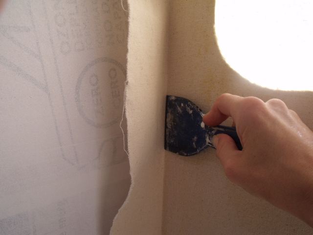

15. Now I apply the sizing to the corner. Again to make for a nice clean cut later. To help hold the canvas in place in the corners I applied push pins to the extra canvas on the opposite walls. The secret here is to allow a bit of extra canvas to lift up between the corner and the push pin. That way it will apply positive pressure to the corner to keep it from lifting up before drying. It will also keep the canvas from being glued to the opposite wall if any glue got on there.
Sizing
16. One more pass with the putty knife. :thumbsup:
Putty knife
George.

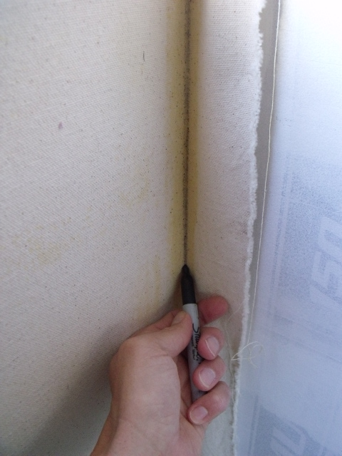

17. We have waited for the glue to dry again. Now I take a sharpie to mark along all my cut lines. This photo only shows the corners, but I also marked around the outlet boxes and other cut locations.
Marker

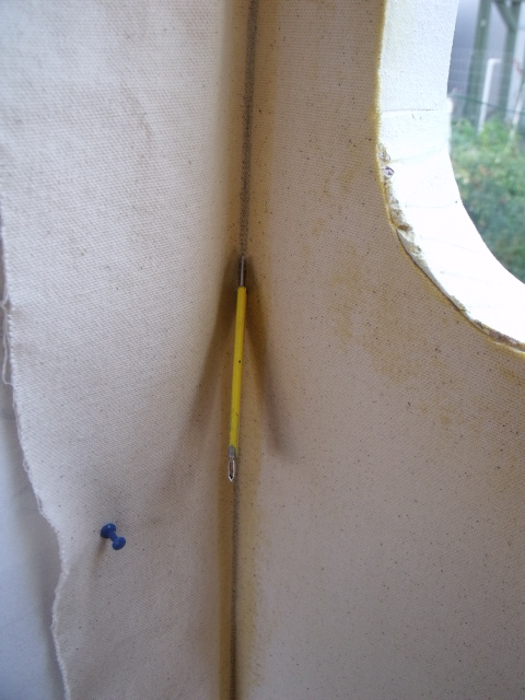

18. Now the box cutter comes out to make some cuts. I found the box cutter to work perfect for this since it will allow the blade to only cut about 1\4" into the foam. I cut the corners at a 45* angle. I use the exato blade to get into the hard to reach corners that the box cutter can not get into.
Box cutter

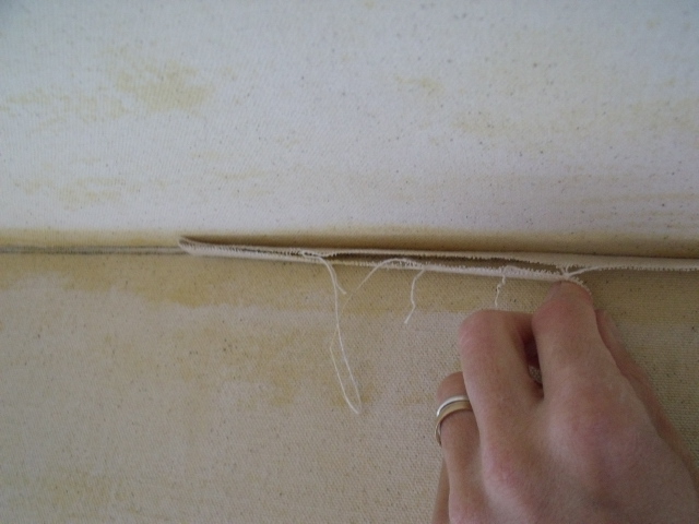

19. Now it is time to pull the canvas. I found that you want to pull the canvas so that it is folding back onto itself like pictured. That way you are not pulling away from the walls and possibly creating a lift to the canvas if you did not get a clean cut or a glue bridge. In this picture you can see that two canvased surfaces are coming together and making a clean corner.
Pulling canvas

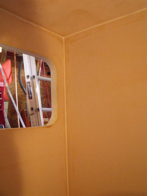

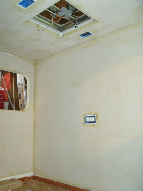

So nearly done. Now we have cut around all our windows, outlets, corners, ect. Remember applying a sizing to the areas to be cut makes it that much easier. I used the box cutter and exato for all these cuts. This is a shot of the inside with all the canvas applied and ready for the next step.
Before caulk

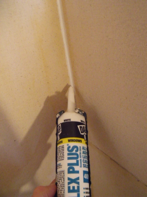

20. Now I use DAP Alex Plus caulk to caulk all the corners and anything else that may need some fill.
Caulk
21. Now I apply a sizing coat to all the canvas to fill the canvas weave.
After caulk
Finished and ready for primer and paint. :beer: (root beer).

Postby ghcoe » Sat Oct 15, 2016 7:44 pm
bonnie wrote:Very nice. I love how sharp those corners are.
Thanks Bonnie.
I got a coat of primer on today. Hope to get some paint on tomorrow.
Paint

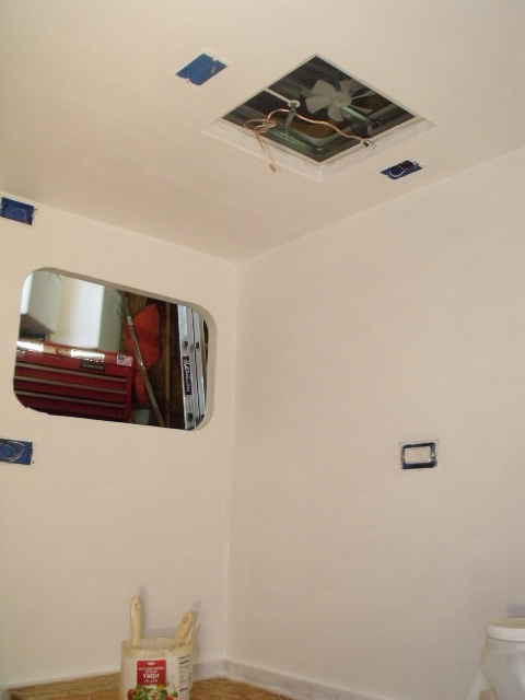

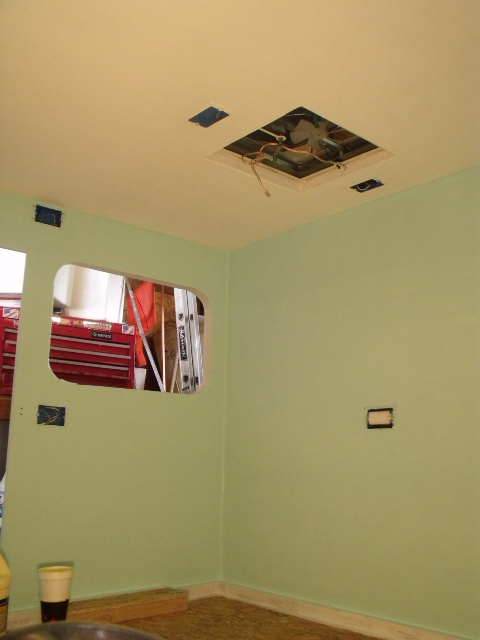

I got two coats of wall paint on today. Still some canvasing and carpeting to do. Just hope the weather holds out for a bit longer.
Paint

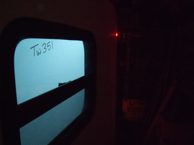

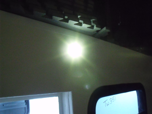

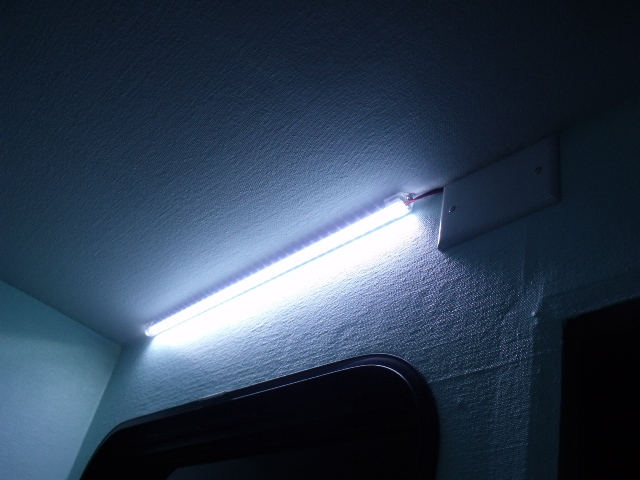

This weekends accomplishments. Started to canvas the portion under the front shelves. Weather is turning cool here so it is taking a long time to dry. While waiting for canvas to dry I had time to install electrical plates, install LED lights and install vent interior ring. I was able to use #6 1 1/2" screws to attach the lighta to the ceiling. There was no hard point for these lights, but it seems to work just fine... :thumbsup: Blank plates in the ceiling are for overhead LED's like I used for my porch light at a later time.
Lights
Camera
Action
George.

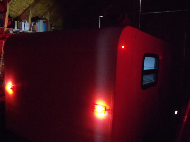

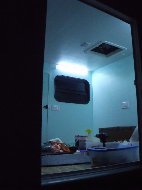

A couple of shots of the running lights running.
Clearance
You can see how bright the porch light is on the far side. It is lighting up the wall of the shop.
Tail
George.
