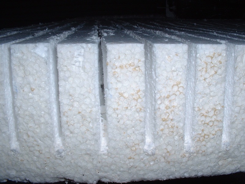

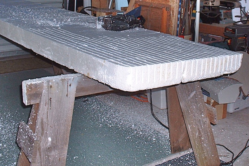

OK, the widened Jigsaw blade works and produces a nice 3/16” wide kerf to just the right depth ... a bit messy , Very tedious , the wide blade slowed down considerably by either the extra width , or the glue I got between some of the teeth ... :oops: And as you can see the wider blade tends to “wander” like a drunken sailor ... :o Not a problem since it’ll al be papered over in the finish ...
But , the panel bends nicely to the required radius .. :thumbsup:

Can’t say this is as much Fun as I thought it would be... took all day to cut/kerf one panel ... :o that with a couple breaks and a short nap after lunch ... Oh , well ... one panel down , 3 more to go ... :frightened: Now , I’ve decided to do this outside , cause it just makes a big Mess inside .. and with rain forecast for now through all the weekend, just another delay ... :oops:
Going over to Vinnie’s tomorrow and see if he can cut those nose ribs for me ... at least I’ll be getting something done ..
Ps , I did try cutting the slots with the narrow blade first , which went quick , and then chase the slot with the wide blade ... turns out it’s just as much work as just using the wide blade ...and really didn’t work as well ... :(

After watching several laminate trimmers in action , it would seem they’re not much faster than the jig saw , with having to move the guide every time ... So got out the jewelers eyeglass and mounted the Fat blade in a vise and picked out all the little bits of JB weld that were between the teeth of the blades ... That May help? it sure feels much sharper now anyway ... Three more panels to go ... 23 cuts per panel @ 10’ long ... and then we get to do the Nose ... :o :NC :frightened:

Not really frustrated, just thought the kerfing would go a little easier .... :thinking: The FS is a bit more complicated than making a Box foamie ... I should have realized there would be a shedload of kerfing ... :o But it’s all good . Learned about kerfing and kerf spacing , and how different foams cut...
I do have to say , the beaded foam cuts waaay differently than the extruded foam ... Extruded makes fine dust ... the beaded foam leaves little beads everywhere... And the beads are a little easier to sweep/vacuum up... but it’s still messy ... Unlike sawdust which immediately becomes part of the earth , foam just hangs around...which I guess is Good in the long run ... for the trailer ...
The reason for the kerf complications was my decision to use the 3.5” thick foam , instead of the 2” thick ... kerfing the 2” would have been easy ... My problem is , my kerfs have to be 2.5” deep ... a challenge for conventional methods ...
Another thing that was immediately obvious .... the smaller width , closer spaced kerfs work much better for uniform bending than the wider spaced kerfs... Twice as much work (or more ) , but worth it IMHO ... And the smaller kerfs are Safer too ... The large kerfs spaced far apart caused much more strain on the beaded foam when bending (broke in several places on the test piece ) ...
