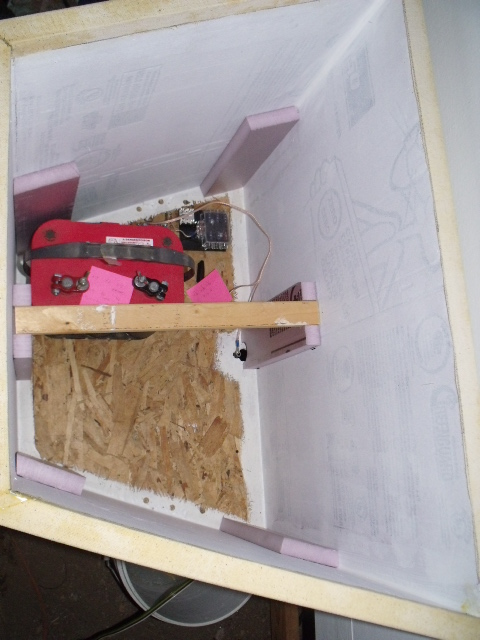

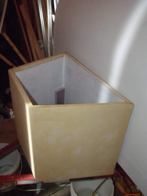

I had started the battery box last fall just before the cold set in. I got the floor and sides done, but that was all.
Battery Box Outside
Since overnight lows were projected to be 40 I went ahead and glued in the supports for the false floor.
Battery Box Inside

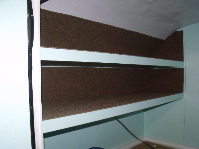

I also finished up gluing the carpet in the front shelf area.
Carpet

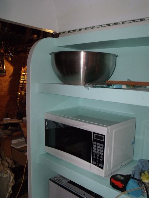

I got a microwave for Christmas so I was able to see how it fit. I also found a great stainless steel bowl that will be used for the kitchen sink. :twisted:
Microwave and sink
Hope the weather continues to improve. Looking to get this thing done this spring. So close now.
George.

Postby dancam » Mon Feb 06, 2017 6:22 pm
ghcoe wrote:I got a microwave for Christmas so I was able to see how it fit. I also found a great stainless steel bowl that will be used for the kitchen sink. :twisted:
Right on, cold weather and snow sure puts a damper on things...
Did you pick a lower wattage microwave? Or is it just to be used when on shore power?
dancam
Posts: 586
Re: #1
Postby ghcoe » Mon Feb 06, 2017 6:45 pm
dancam wrote:Did you pick a lower wattage microwave? Or is it just to be used when on shore power?
Yes it is a 700 watt microwave. I am looking at getting a 750-1000 watt inverter to run it and the small TV that will probably be inside when no shore power is available. They probably will not get too much use, but could be nice in certain situations or weather.

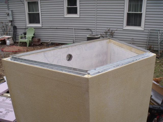

I worked on getting a top on the battery box.
I used some drywall beading and screwed it into the top of the box. It is not permanent as of yet, just a mock up.
Beading for seal

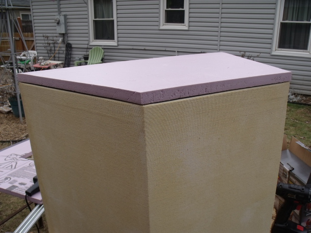

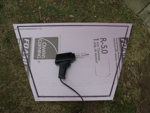

I made a top out 1" foam, placed it on top of the drywall beading and tapped lightly. This marked the foam for where I had to cut a groove for the beading with the soldering gun.
Grooves cut

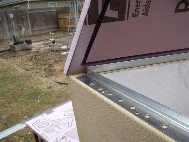

Then for the test fit. :thumbsup:
The test fit

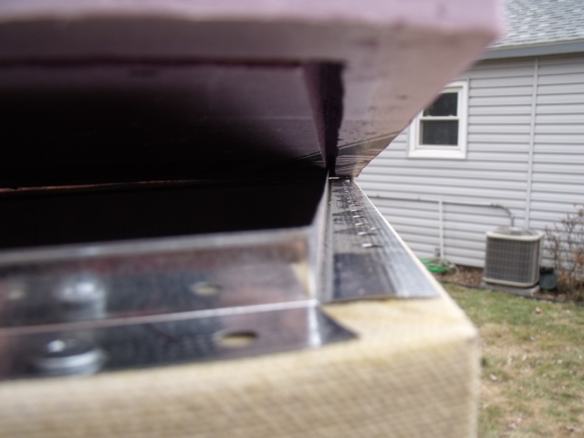

Postby ghcoe » Mon Feb 20, 2017 8:33 pm
Looks to be a good fit.... :thumbsup:
Nearly closed
Closed
