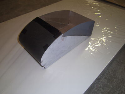

I am building my first foamie and plan to use a Winter Warrior design with roof that rises to 6' when extended. Was hoping to post photos of my cardboard model and diagrams, but can't seem to figure out how to attach these to a message. Can anyone out there help me? Could really use some feedback on my design.

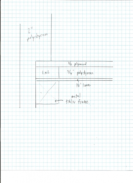

My diagram/plan is at:
gallery/image.php?album_id=3840&image_id=128326

and my idea on wall attachment is at:
gallery/image.php?album_id=3840&image_id=128327
Make sense? Better ideas? Was using thi to cover plyswood edge of floor and trailer frame (???)

Constructive comments:
I like the idea of having space along the mattress for shoes and whatnot, and it will make making the bed easier, but at only 6 inches wide it will not be possible to walk that close to the wall. But heck, what is in a name anyway.
Also, I realize it is just a sketch, but I would try to smooth out that little peaky bit near the hinge where the front radius transition into the rearward slope.
Will you have a roof vent fan, and if so, where will it go?
Re: Thrifty Alternatives ... Building Foam TDs
Postby KCStudly » Sun Feb 01, 2015 6:49 pm
Think about how you are going to wrap the canvas under the edge of your wall foam. For a foamie, I really like the idea of wrapping the canvas under the cabin and having that tag end of the canvas captured between the cabin and the trailer frame. Therefore, IMO, it is preferred to have the cabin sit fully on top of the frame.
Remember, too, that the canvas won't want to wrap cleanly and stay adhered to a crisp edge or inside corners. The fibers will want to spring back, so you have to factor that into what will happen at the bottom of the walls.

Postby cpowell243 » Tue Feb 03, 2015 12:00 am
KC,
Thanks for feedback on wall attachment - don't want canvas coming loose so makes sense to tuck under the floor. I will lose 1" of interior space by glueing flush, but still leaves 9" on each side of bed (each square in my diagram is 6"). Could also just make the floor 2" wider.
Any reaction to my plan to use 2" in front of the TD and 1" in the rear, with a 3/4" think galley nesting on top of the 1"?
What do you think of the idea of beveling the front to reduce wind resistance?
gallery/image.php?album_id=3840&image_id=128410
gallery/image.php?album_id=3840&image_id=128409
gallery/image.php?album_id=3840&image_id=128408

Postby KCStudly » Tue Feb 03, 2015 12:49 am
I couldn't make out your pics very well because they were too small and when I zoomed in they got pixelated. Looked like a scale model.
Both of my TV's are SUV's so to me, pinching the front is a waste of internal space. I recall an experienced builder pinching the nose slightly for the aero gain, and IIRC he said it wasn't worth the effort involved, but I don't recall who or which build it was. Rounding the front top above the TV height makes sense to me, as does keeping the front as close to the TV as possible w/o killing maneuverability or balance.
Keeping the cabin width about the same as the TV or less makes aero sense, too.
Can't really say about the foam sizes, except that big long unsupported edges in thin panels probably won't hold up too well. My walls are 1-1/2 foam with 5 mm ply inner skins. I went with laminated wooden edges in my galley area to protect against dents, maintain rigidity, and provide a consistent sealing surface. Until I put my upper galley shelf frames in and the counter edge rail, I could still flex the walls in or out by pressing on them; at least enough to slip those parts in. In fact, when I needed to get a little more overlap from my hatch inner skin, I trimmed these items a tad to help suck the walls in a bit. So you should either test or plan your interior structure (cabinets, stiffeners, whatever) accordingly. Not sure how you would do that for the roof part.
My opinion, if a lifting roof and foam construction are desired, I would take a closer look at how Sharon did her roof on her 'My Away'. The partial roof panel and cofferdam lip go a long way toward stiffening and make it much easier to seal, IMO. Easier to build, too, I think.
Something very similar could be done with a curved profile like in your sketch.
Not to discourage you, but just some food for thought to address your expressed concerns. :thumbsup:
