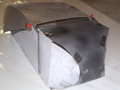

Since my plan is to build a foamier Winter Warrior I need to hinge my roof. Any opinions on using:

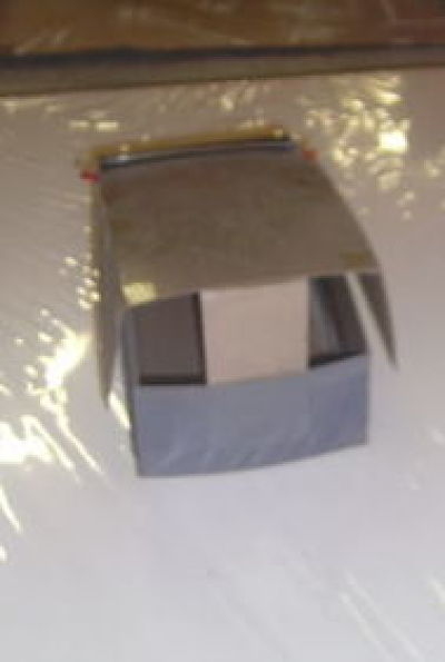

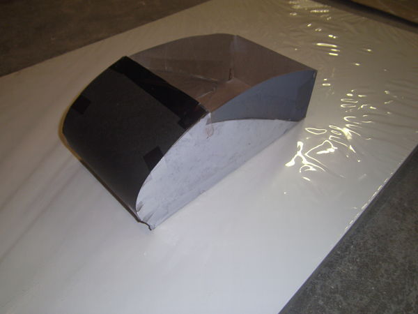

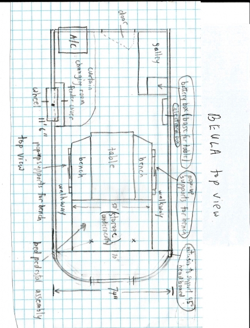

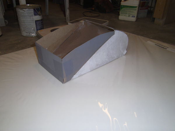

In looking back at the sketch on the previous page, I notice you've got a walkway on each side of a 50" wide bed. I think most would agree that's typically pretty narrow for two people. I'm doing 50" myself, but 90% of the time it'll be just me since my wife doesn't camp and I wanted to keep it narrow. It seems to me that the space on each side of the bed would be more appreciated in the long run as bed width, but that's just an opinion.

I took the liberty of posting your pics so others don't have to open the links:

Thanks for comment and posting of pics WW - we have slept on double beds without difficulty so I think we'll be OK. Walkway is a major goal since my 1st TD had a 54"W queen air mattress and getting in and out with no place to plant a foot was a problem.
Any thoujghts on whether the beveled design (for reduced wind resistance) is worth the trouble?

Any thoughts on whether the beveled design (for reduced wind resistance) is worth the trouble?
If it would normally be sticking out past the sides of the tow vehicle into the air stream without the bevel, then yes - I would say it's worthwhile. If you are towing with a full size van, probably not. It will obviously narrow the head of the bed as well but, looking at your sketch, that shouldn't be a problem. The V-berths in boats are always built that way out of necessity.

This is just a note which only applies if you want to use standard sized mattress & sheets. Standard "Full" or "Double" bed size is 54" w X 75" l and "Queen" is 60" w X 80" l. FWIW, am confident we could camp comfortably with a 50"wide mattress. The 54" mattress in my camper feels wide enough for everyday use.
