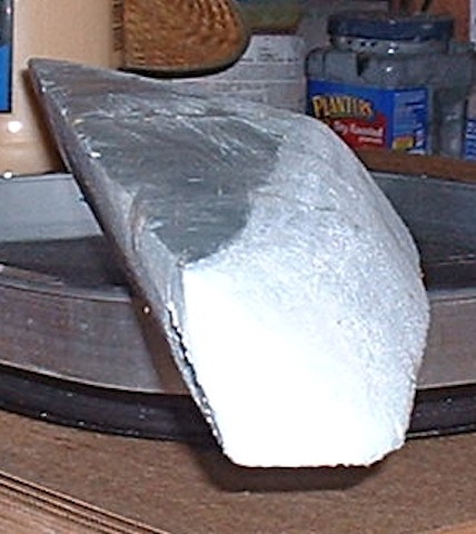

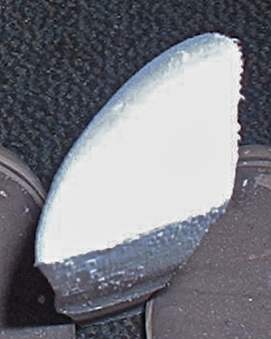

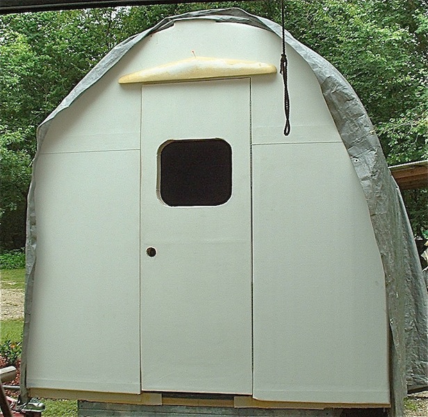

We carved the rain diverter from scrap foam (two pieces ) shaped it as shown , covered it with scrap canvas and glued it to the bare canvas, clamped with a few long screws into the foam , caulked and painted ... Works Super , costs nothing really...

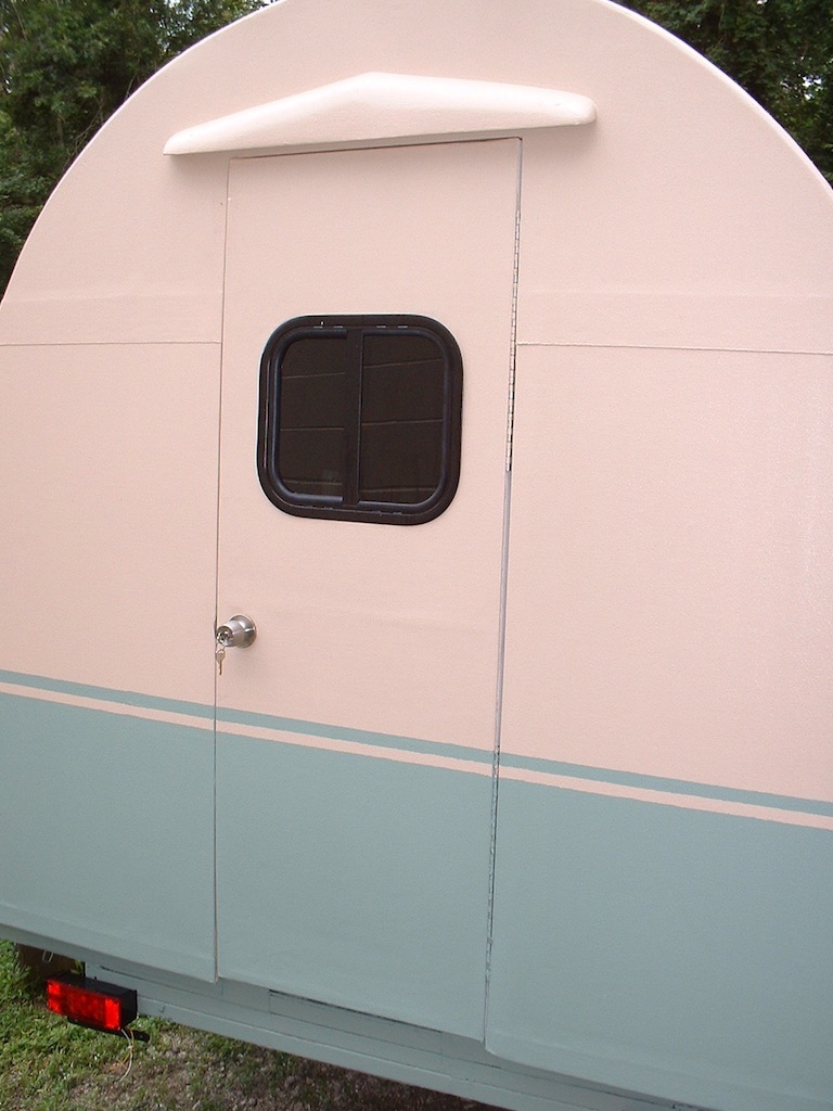

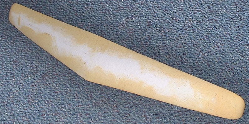

And how it’s shaped ... so the water has no place to go but the sharp edge out and away from the door ... It Works !!! :thumbsup:
