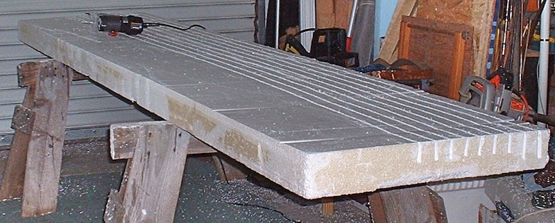

OK, now we’re Kerfing !!!  :D ... The trim router just walks through the foam quickly , the little edge guide working fine ... I did find the cutting part on my bit wasn’t deep enough for the full 2.5” depth cut at once , tried that and some foam melted onto the smooth top part of the bit ... So I’ll have to do it in two passes ... No problem . This is much easier than the jigsaw, not as temperamental as the hotwire ... Still messy , but no way around that eh ??? :R

looking good. hogging out material that deep, you pretty well have to do it in two passes, no matter if it is foam or especially wood. :thumbsup:

Yeah, this is really much easier than the other way :thumbsup: ... even after two passes I did have to pass a dowel down the grooves to dislodge all the caked foam bits left ... once vacuumed out the cuts were deep and clean and the panel bends nicely ... Funny about the kerfs , even the left over foam dust caked/lodged deep in the kerfs can restrict the bending ...

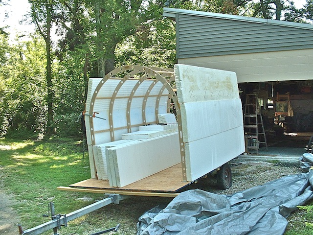

Today will be the big test :o ... the first time we install the kerfed panels onto the full 36” radius part of the skeleton . Just to keep things Simple , I’ve been using T2 all along to glue the foam to the framework. It does dry fairly quick , and all the foam to plywood and foam to foam joins are solid... ;) Don’t think T2 would work as well with Blue or Pink ... just guessing ... Just getting light enough to chase the skeeters’ off.. still fairly cool .. sorta’ 83F ... and here goes ...

Postby GPW » Mon Jun 03, 2013 8:58 am
Clear this AM . Third level panels going on .... due to the curve , the bottom has to be glued solid first ... Thinking now I should have used Gorilla Glue for just that. :roll: Quicker , and gap filling , although I’m counting on the shrinkage of the canvas to pull everything together super tight in the end ... :thinking:
