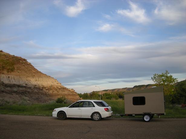

Interrupting this good discussion of canvassing to say that my little foamie has now traveled 6,000 miles! It has held up well, and the only trouble I had with it (premature tire wear) seems to have been caused by my amateur job of packing the bearings. Here is a picture of our rig in Drumheller AB on a camping trip last week.
Re. canvassing, my only regret is that I should have used more glue. There are a number of bubbles on Peregrino that look bad in the early morning sun. :)

Shar, it looks WONDERFUL !!! :applause: 8) :thumbsup: :dancing

Postby Mary C » Sat Jul 04, 2015 1:23 am
I like the color, I like the design aw heck, it is superfine!!!!

Bubbles are easy to fix ... :thumbsup:
There seems to be a lot of concern for the Looks ... some wanting a Foamie to look like a megabuck RV ... Thing is , It’s Not , It didn’t cost that much , and you’re camping comfortably ... :beer:
